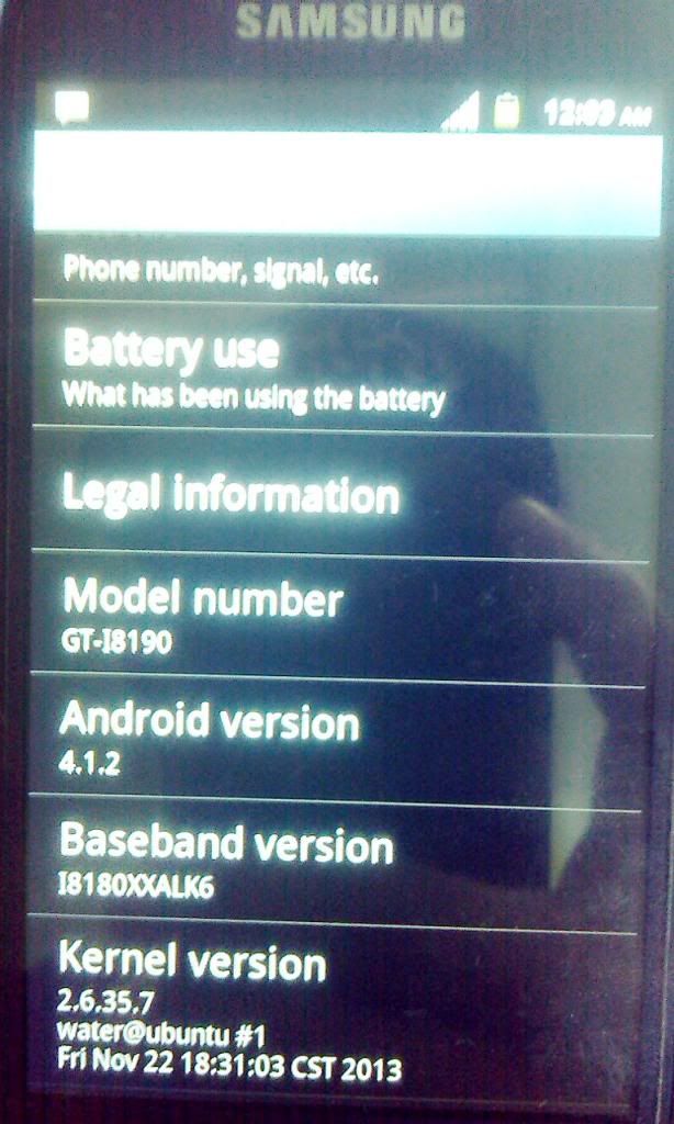

mga boss share ko lang po
nagawa ko kanina wala po kasi hard reset
kaya ginawa ko po kinuha ko na si volcano

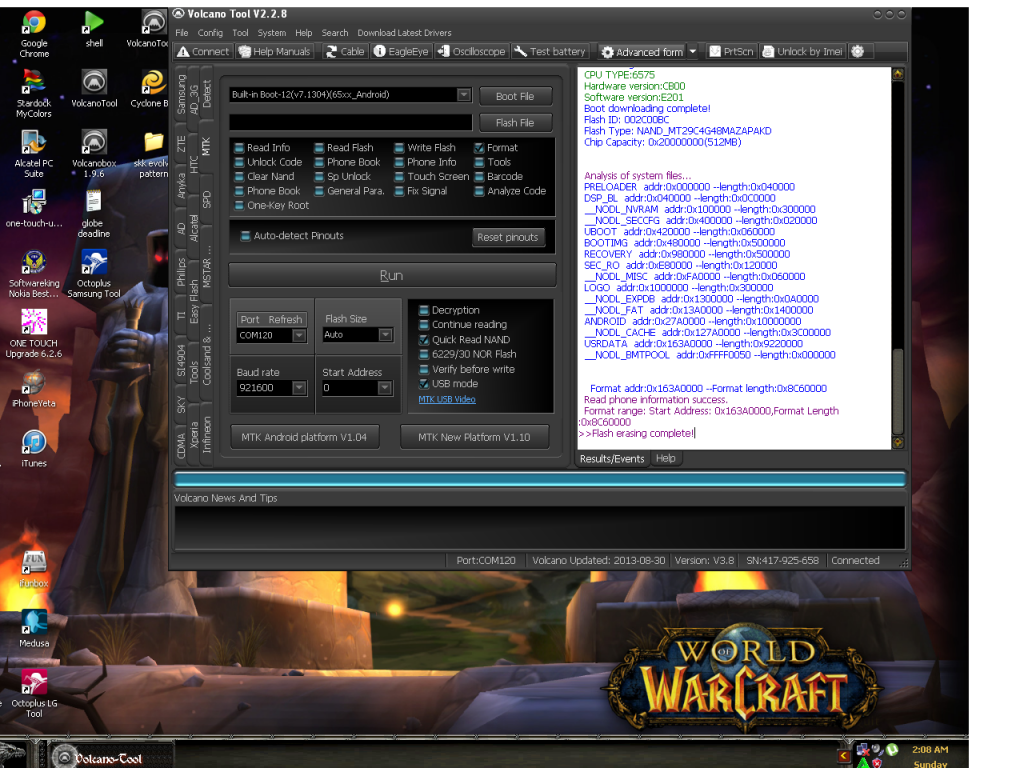

procedure
open volcano 2.2.8
click mtk tab
click boot to 12(v07.1304)(65xx_android)
uncheck auto-detect pinout
check usbmode
check format
click run
connect to phone power off
thanks for viewing.. :x
