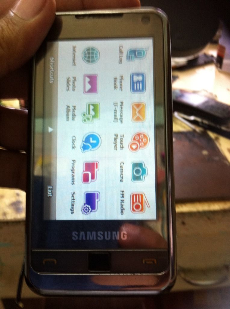

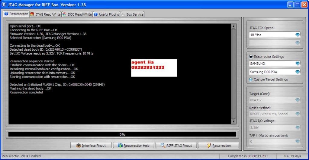

sharing lang after a few days kong nawala sa ere...
unit: I900 omnia
trouble: deadboot
history: change language
tools:
RIFF JTAG
procedure:
properly solder jtag pinout
put battery/RPS
connect to usb
open RIFF software

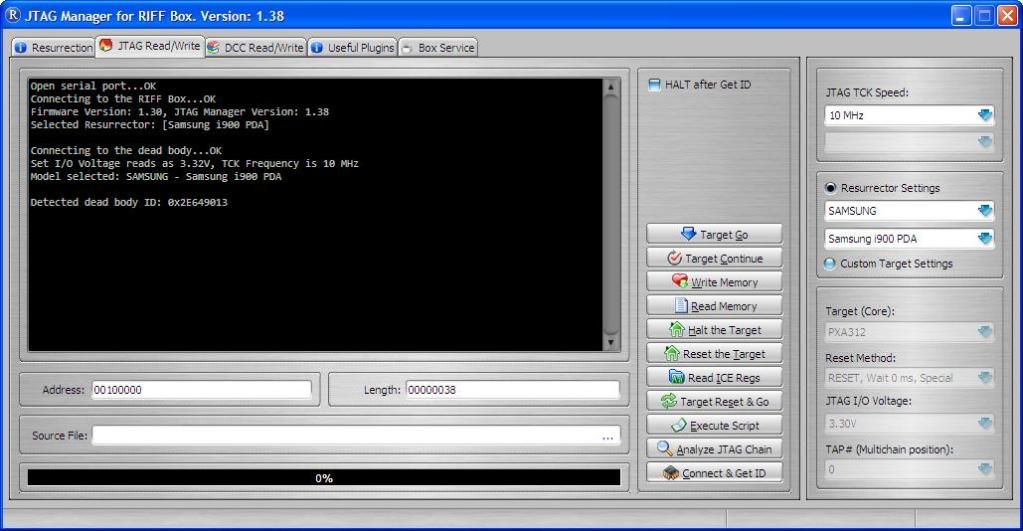

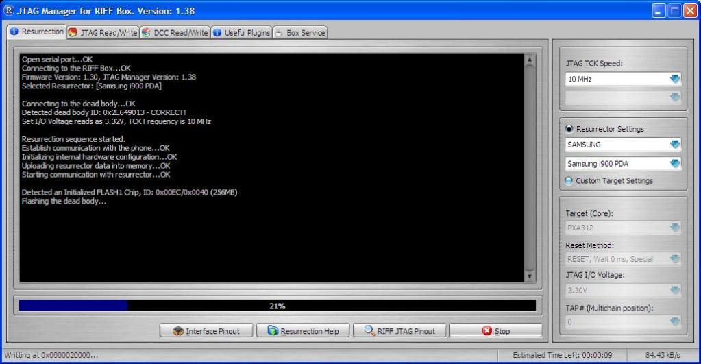

click connect and get id
if all is well
click resurrect
wait until the resurrection is successful
screen shot.

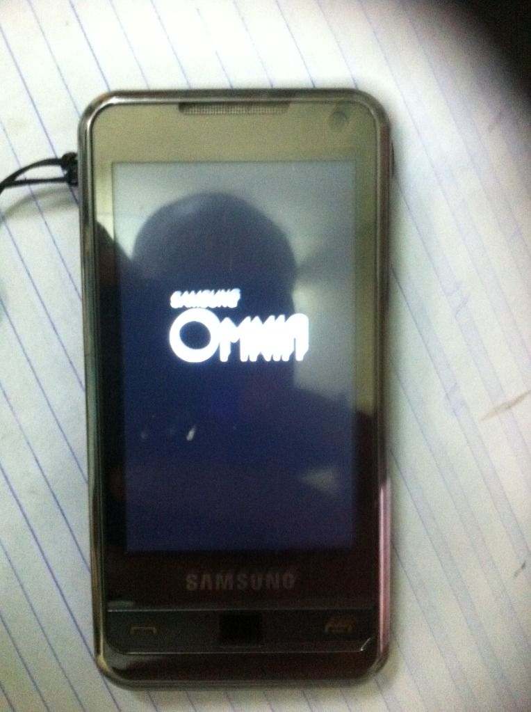

then desolder pinout and test....
ooops! hang sa OMNIA logo at mejo nainit (pansin ko lang yan kapag di completly repaired ang SW ng mga android)
lets continue.....
dl this sw: http://www.mediafire.com/?dt1wouiltmn#2 na dl ko lang din yan dito sa atin
samsung usb driver http://www.sendspace.com/file/aqshxa
active sync 4.5 http://www.microsoft.com/windowsphon...6/default.aspx

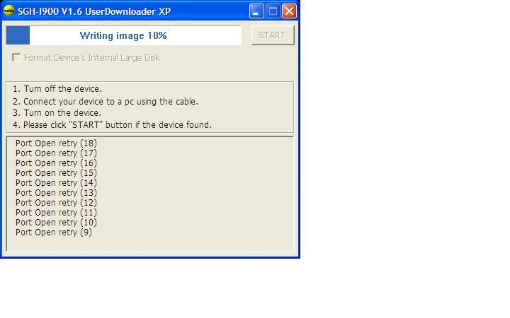

again:
connect phone to usb
allow all the driver automatic install your drivers needed

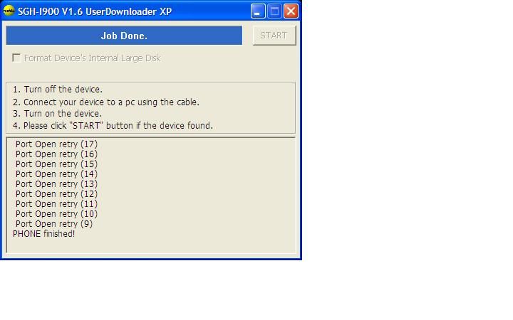

open the USER DOWNLOADER XP
click start and wait until its finished
done!
