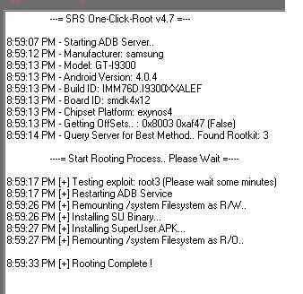

5. time to rebuild the orig imei, pero root muna tayo
i am using SRSRoot----madaling hanapin yan sa google
6. imei rebuilding na tayo, navigate to service tools, check repair imei and input the imei, check unlock. do SPT mode, do Factory Mode...done
