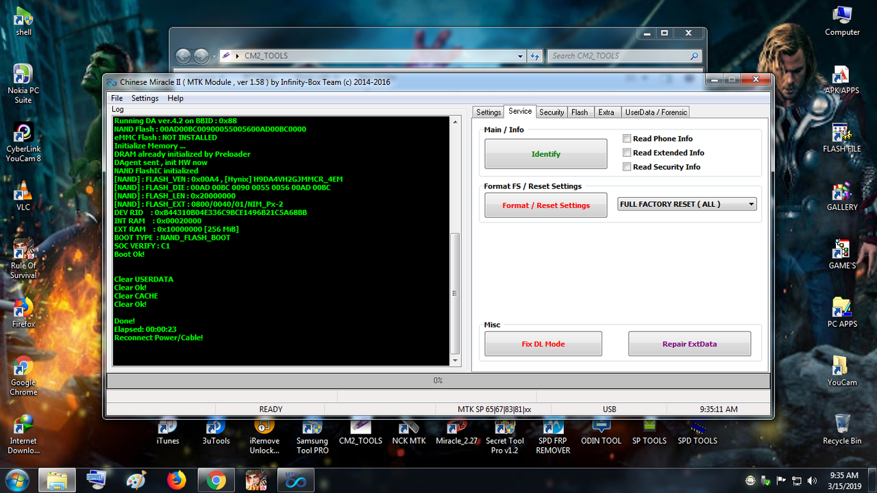

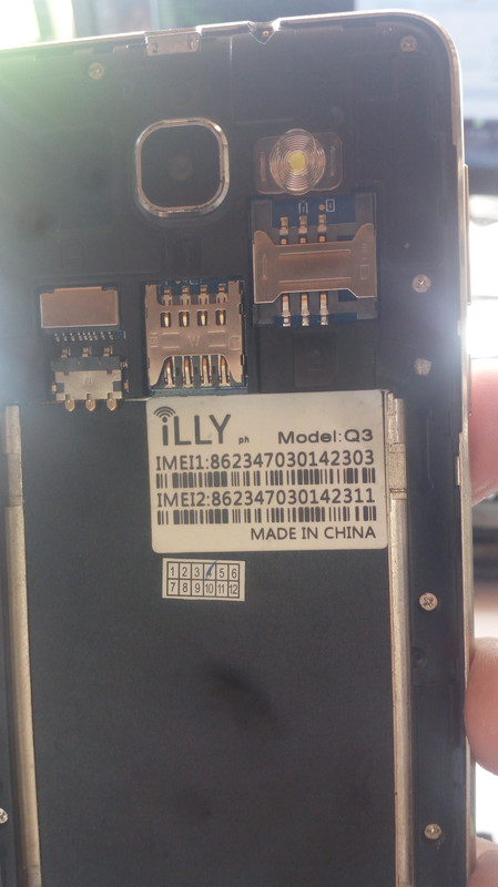

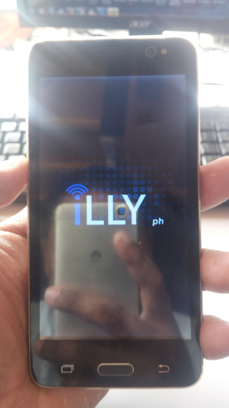

Unit : ILLY Q3
Status : Hang On Logo
Procedure : Format/Reset Setting By CM2

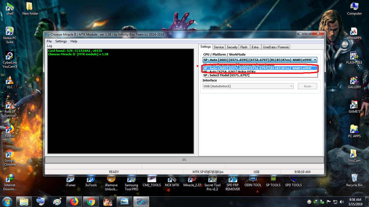

1. Open CM2 V1.58
2. Select CPU/Platform/workmode
3. Click Service Then click Format/Reset Setting
4. Salpak USB s PHone
Hintayin mtapos
Backup FW sa baba
Screen shot
Wait for phone...
Phone found! [ 6 ]
Sync...
Inital Boot Ok!
BB_CPU_PID : 6572
BB_CPU_NME : [MediaTek] MT6572_S00
BB_CPU_EXT : 0xCA01 , 0x8C00 , 0x0000
Processing BROM stage
Settings for BROM configured!
SecCfgVal : 0x00000000
BromVer : 0x00FF
BLVersion : 0x0001
Processing DA stage
DA Select done, will use MTK_AllInOne_DA_v5.1624.16.07
Sending and initialize DA ...
Running DA ver.4.2 on BBID : 0x88
NAND Flash : 00AD00BC00900055005600AD00BC0000
eMMC Flash : NOT INSTALLED
Initialize Memory ...
DRAM already initialized by Preloader
DAgent sent , init HW now
NAND FlashIC initialized
[NAND] : FLASH_VEN : 0x00A4 , [Hynix] H9DA4VH2GJMMCR_4EM
[NAND] : FLASH_DIE : 00AD 00BC 0090 0055 0056 00AD 00BC
[NAND] : FLASH_LEN : 0x20000000
[NAND] : FLASH_EXT : 0800/0040/01/NIM_Px-2
DEV RID : 0xB44310B04E336C9BCE1496B21C5A68BB
INT RAM : 0x00020000
EXT RAM : 0x10000000 [256 MiB]
BOOT TYPE : NAND_FLASH_BOOT
SOC VERIFY : C1
Boot Ok!
Clear USERDATA
Clear Ok!
Clear CACHE
Clear Ok!
Done!

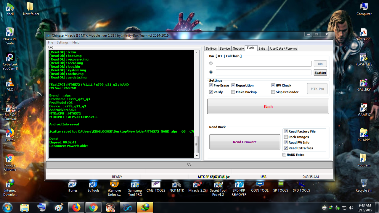

Reading Flash Content now ...
[Read Ok] : preloader_c799_q21_q3.bin
[Read Ok] : lk.bin
[Read Ok] : boot.img
[Read Ok] : recovery.img
[Read Ok] : secro.img
[Read Ok] : logo.bin
[Read Ok] : system.img
[Read Ok] : cache.img
[Read Ok] : usrdata.img
[ScatCFG] : MT6572 / V1.1.1 / c799_q21_q3 / NAND
FW Size : 260 MiB
Brand : alps
ProdName : c799_q21_q3
ProdModel : Q3
Device : c799_q21_q3
AndroidVer: 5.0.1
MTKxCPU : MT6572
MTKxPRJ : ALPS.KK1.MP7.V1.5
Android Info saved
Scatter saved to : C:\Users\KINGLOCKER\Desktop\New folder\MT6572_NAND_alps__Q3__c799_q21_q3__5.0.1__ALPS.KK1.MP7.V1.5
Done!
Elapsed: 00:02:41
Reconnect Power/Cable!
Ito ung Backup FW
LINK : https://www.4shared.com/rar/pX31U1FWee/MT6572_NAND_alps__Q3__c799_q21.html

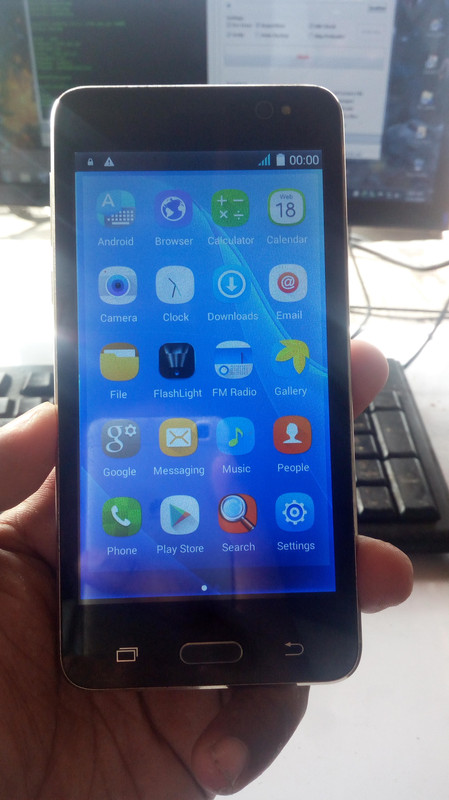

Succes SS
Slamat Sana maka tulong=))=))=))
