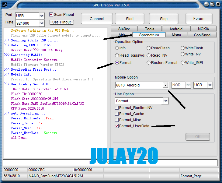

Prucedure:
Open GPG DRAGON CRACK
Click Spreadtrum
Click Format
Click Mobile Option 8810_Android
Click Format UserData
Hold voll up or down para sa boot key
And hit start button wait... mag done :D
Picture of tool:
LOG's
Code:
    Software Working in the USB Mode...
    Pleae use USB Cable Connect mobile to computer...
>>> Scanning Mobile USB Port...
>>> Detecting COM PortCOM9
    Driver Name->>>SPRD U2S Diag
>>> Connecting Mobile...
    Mobile Connection Success...
    Mobile Firmware Version:SPRD3
>>> Downloading First Boot...
>>> Mobile Info
    Project ID :Spreadtrum Boot Block version 1.1
>>> Downloading Second Boot...
     Baud Rate is Switched To:921600
    Flash ID:00002CBC
    Flash Size:20000000->512M
    Flash Name:NAND_SamSungMT29C4G48MAZAPAKD
    CPU Name:6820/8810
>>> Auto Formatting ...
    Format_RuntimeNV...Fail.
    Format_Cache...Fail.
    Format_Misc...Fail.
    Format_UserData...Success.
    All Done...

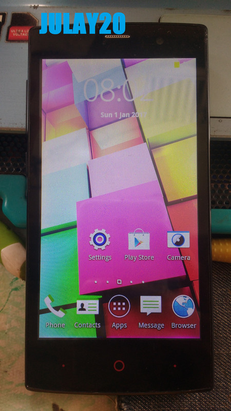

Done picture:
wala tayong back up mga boss pang mabilisan si tumer pasinsya na po :D
yan lang po na konan :D
