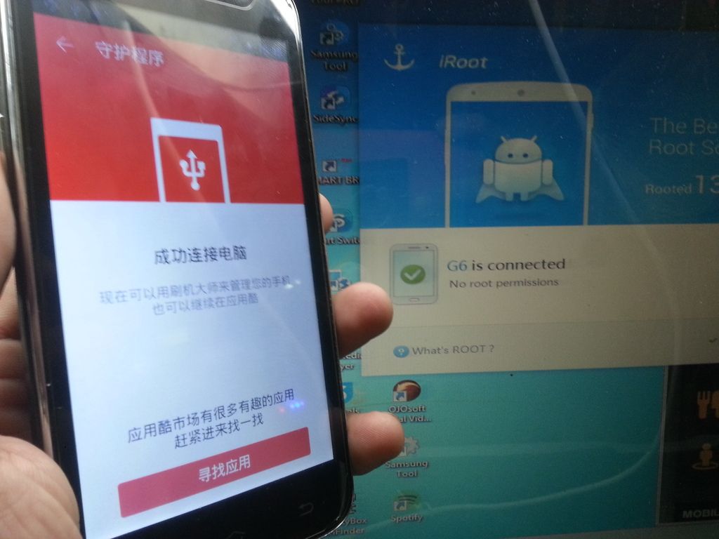

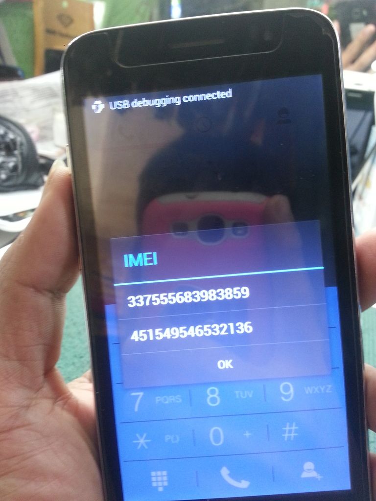

I have this samsung g6 clone phone
invalid imei
try nckbox no luck
try cm2 no luck
try.,
prepare usb debug
then

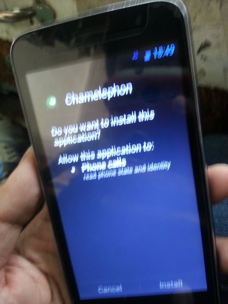

1. ROOT using iroot
2.use camelephone apk
download here: https://apkpure.com/chamelephon/com.cryptotel.chamelephon/download?from=details
3. RESTART your phone., then
okey na.,
