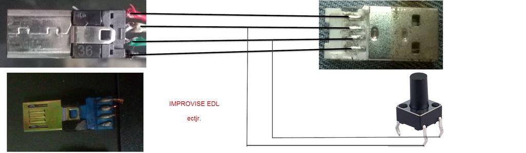

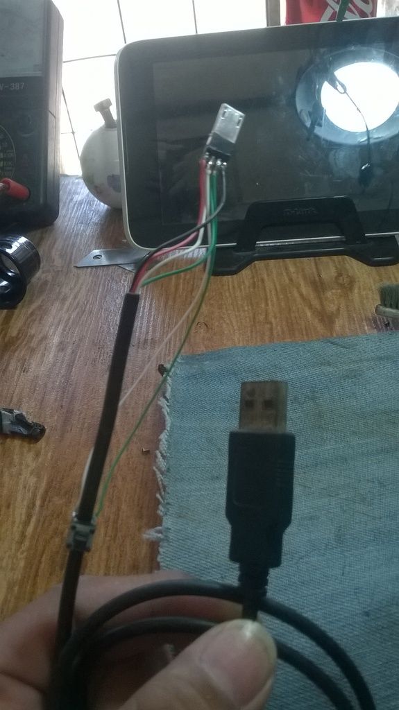

adrenaline Expired Account Joined Jun 14, 2014 Messages 156 Reaction score 124 Points 201 Location Caloocan May 17, 2018 #1 share ko lang po itong natuklasan ko improvise EDL cable materials USB cable V8 Zip Switch ito po ang schematic diagram sundan lang po ang line ito po ang finished product sana po ay makatulong salamat po......................

MIKAHEL01 FREE Access Joined Nov 18, 2015 Messages 984 Reaction score 37 Points 181 Location Tuburan Cebu, City May 17, 2018 #2 adrenaline said: share ko lang po itong natuklasan ko improvise EDL cable materials USB cable V8 Zip Switch ito po ang schematic diagram sundan lang po ang line ito po ang finished product sana po ay makatulong salamat po...................... Click to expand... d- at d+ po ba nka kabit yung tack switch boss?

adrenaline Expired Account Joined Jun 14, 2014 Messages 156 Reaction score 124 Points 201 Location Caloocan May 17, 2018 #5 NARENZ16 said: d- at d+ po ba nka kabit yung tack switch boss? Click to expand... opo sir tama po kayo

adrenaline Expired Account Joined Jun 14, 2014 Messages 156 Reaction score 124 Points 201 Location Caloocan May 17, 2018 #6 CybertechGSM said: boss mukhang mag ka iba ehh..., Click to expand... opo magkaiba po talaga tayo ng schematic ito pong sakin base sa nabili kong EDL at hinanap ko ang connection sa switch at nalaman ko ung green at white nakahinang sa switch Last edited by a moderator: May 17, 2018
