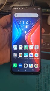

Infinix Hot 10 Play / (X688B)
Problem
Forgotten Password

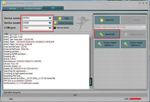

Solution
1 Hard Reset Muna (Hang on Logo kasi pag factory reset sa Octoplus)
2 Open Octoplus para sa FRP
3 Select X688B in model menu of Octoplus
4 Hit Reset FRP
5 Press Vol + & Vol - and connect the phone to your computer wait till done
