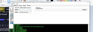

extrafile -copy folder extracted-go to drive c-open infinity-open cm2sp2-bootfile and paste extracted folder close folders and
reopen cm2spd2 exe..
hanapin na nag hot 10i sa platform
login mo username at password
if nakalimutan mo
open cm2 donglemanager then click get username at password
if error sa cm2 need mo mag palit ng password para gumana
if merong error
then balik na sa service then sundan image
turn off unit
click reset frp-and-format fs
press volume down and salpak si usb pera na
