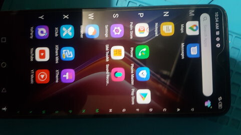

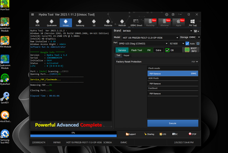

Procedure:
open hydratool
select Unisoc
in model select Infinix hot10i PR652B
select service-tool-factory reset protection in flashmode
tick boot info after dont remove the usb cable
tick execute
done pera na
salamat po!
