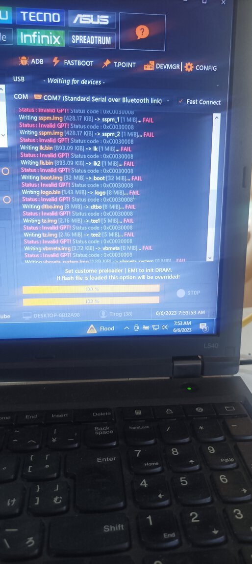

error flashing

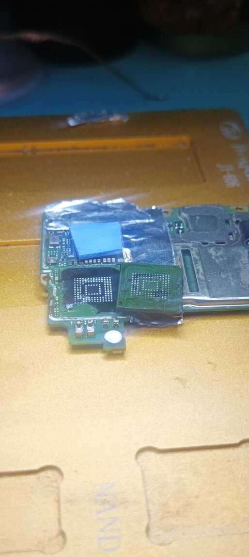

reball emmc

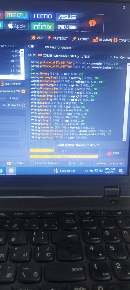

flash unit again. after reball me power na pero corrupt ang firmware kaya fullflash ko nalang sa unlock tool mtk universal

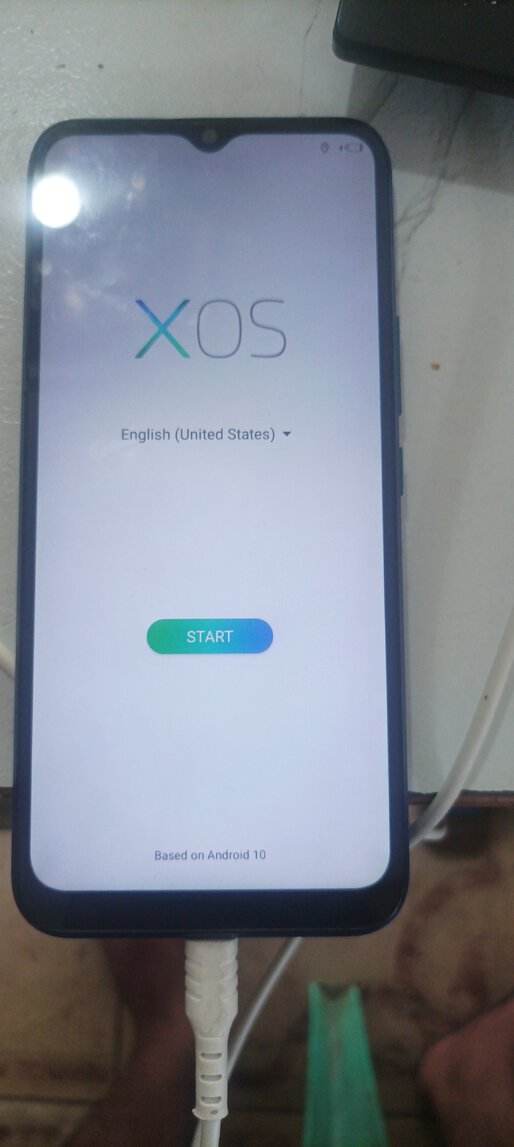

after flash eto na sya
hot air frofile quick2008 remove emmc 350/60
install emmc 350/50
