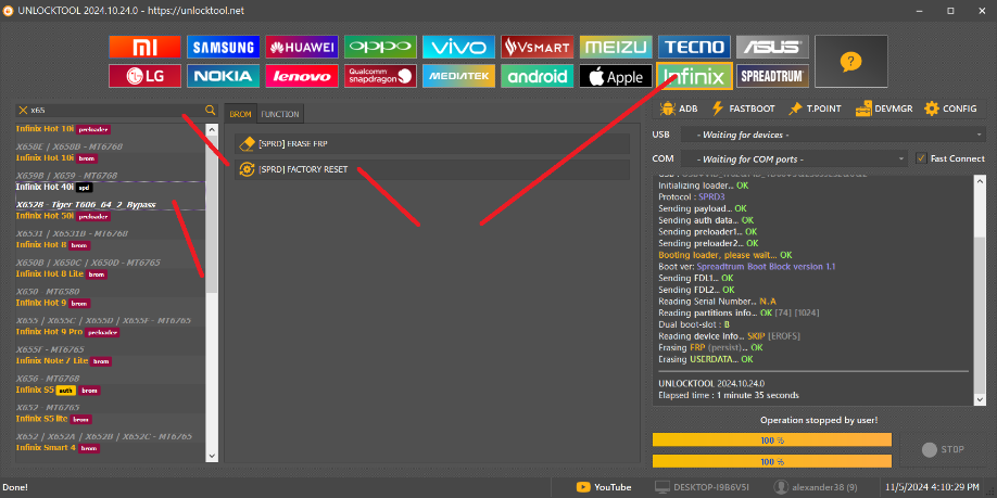

infinix smart 8 X6525 adriod 13 frp done by ut tool
open ut tool: download link https://unlocktool.net/
go to infinix tab
search hot 40i
hot 40i gamit ko kc ayaw sa smart 8 error sia
click SPRD FACTORY RESET wag yung ERASE FRP ERROR din kc yan
hold voll down sa boot key
wait..... mag done
logs:
[SPRD] FACTORY RESET Selected Platform : Tiger T606_64_2_Bypass
Connect Testpoint or hold VOL DOWN! Instruction here!
Waiting for device... COM4 (SPRD U2S Diag)
USB : USB\VID_1782&PID_4D00\5&23059E32&0&2
Initializing loader... OK
Protocol : SPRD3
Sending payload... OK
Sending auth data... OK
Sending preloader1... OK
Sending preloader2... OK
Booting loader, please wait... OK
Boot ver: Spreadtrum Boot Block version 1.1
Sending FDL1... OK
Sending FDL2... OK
Reading Serial Number... N.A
Reading partitions info... OK [74] [1024]
Dual boot-slot : B
Reading device info... SKIP [EROFS]
Erasing FRP (persist)... OK
Erasing USERDATA... OK
UNLOCKTOOL 2024.10.24.0
Elapsed time : 1 minute 35 seconds
wala kong pic ng phone di ko na konan umalis na agad e
