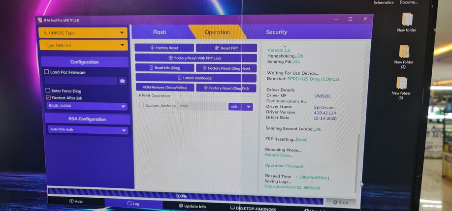

Ona  Password
Open TFM tool spd
Select brand(infinix )
Select model(hot 40i)
Open RSA configuration
Select(itel.tecno.infinix.rsa auth v2)
Select(factory reset)
Salpak u na cable na wala bootkey
Sa FRP nman
Open ulit TFM tool spd
Select brand(0_unisoc tiger)
Select model(tiger t606_64)
Select reset frp
Press u bootkey vol up,vol down
Saksak u na cable done
wala po ako pic sa phone kasi kinuha agad n tumer
