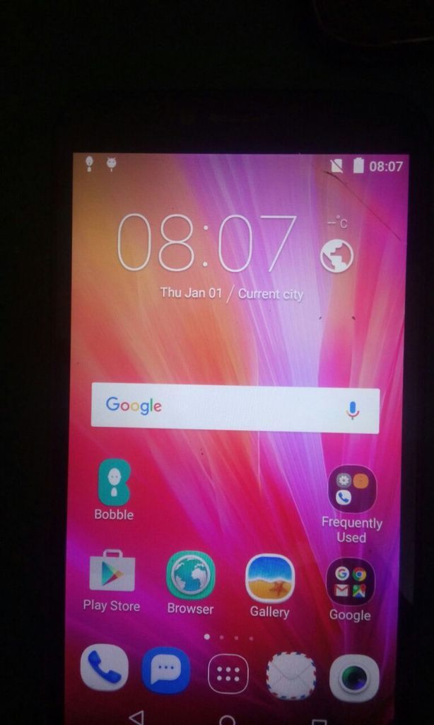

1.Today i faced a new problem with frp of m370i (marshmellow) .
i downgraded to lollypop and all my efforts with Test Dpc , nova launcher ,video shown
on you tube were failed.
2.edl mode was not coming in this set ,mi cable also failed with this msm8909.
i decided to work with a trick
i flashed this Mi370i with this link given by rockey bro (gsm developers)by
this all apps gone but Os started
https://drive.google.com/file/d/0BxX0hL5HAkL_MDJ4Tk1WNWZ3Nms/view
2.now usb debugging option was setteled
3.i used miracle`s adb section (Moto Frp Fuction)..(ANY FRP TOOL FOR QUALICOM CAN BE USE ) Frp done Success after restart

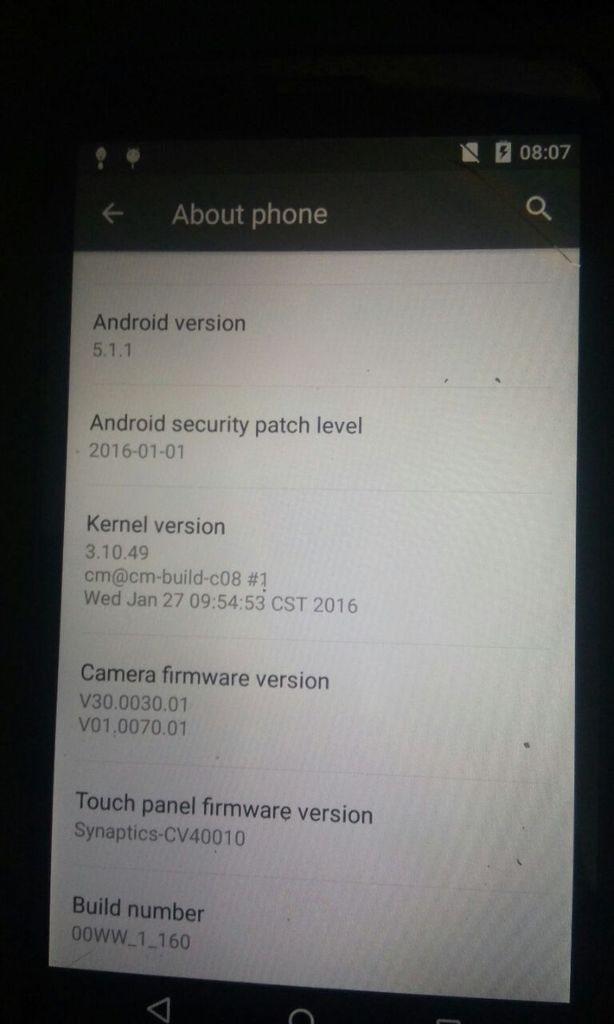

4.i flashed again with SUTL1_v3.1.8 in lolypop version ..(marsh mellow
also can be used but not downloaded by me so i decided to give on lollypop)
http://forum.gsmdevelopers.com/f258/infocus-m370i-flashing-guide-tested-files-6249/
5.Job done succes with this build
