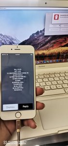

tools: unlocktool at macbook 2 usb cable isa sa macbook isa sa windows

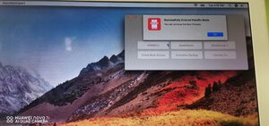

download this sa windows https://www.mediafire.com/folder/br777londowj3/Driver-UnlockTool choose PWNDFU MACBOOK FREE download and extract download iramdisk expert sa macbook
saksak cp sa macbook
put phone in dfu mode then mag hahighlight yung PWNDFU then click antayin mag success
kung d nag succes ulitin lang hanggang sa mag success tiyagaan lang

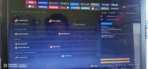

open unlocktool tick apple then tick ramdisk/ download bootramdisk at extract sa unlocktool
tick boot ramdisk 1 then wait
then pag ok na tick back up passcode duoble check kung naback up passcode

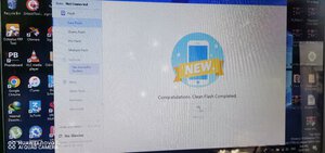

after nyan restore unit quick flash wag sa retain data
after ma flash connect ulit sa macbook ulitin lang yung PWNDFU
then saksak ulit sa windows tick boot ramdisk ulit wait till done
tick restore back up till done

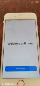

try mu salpakan ng simcard kung nagka signal
