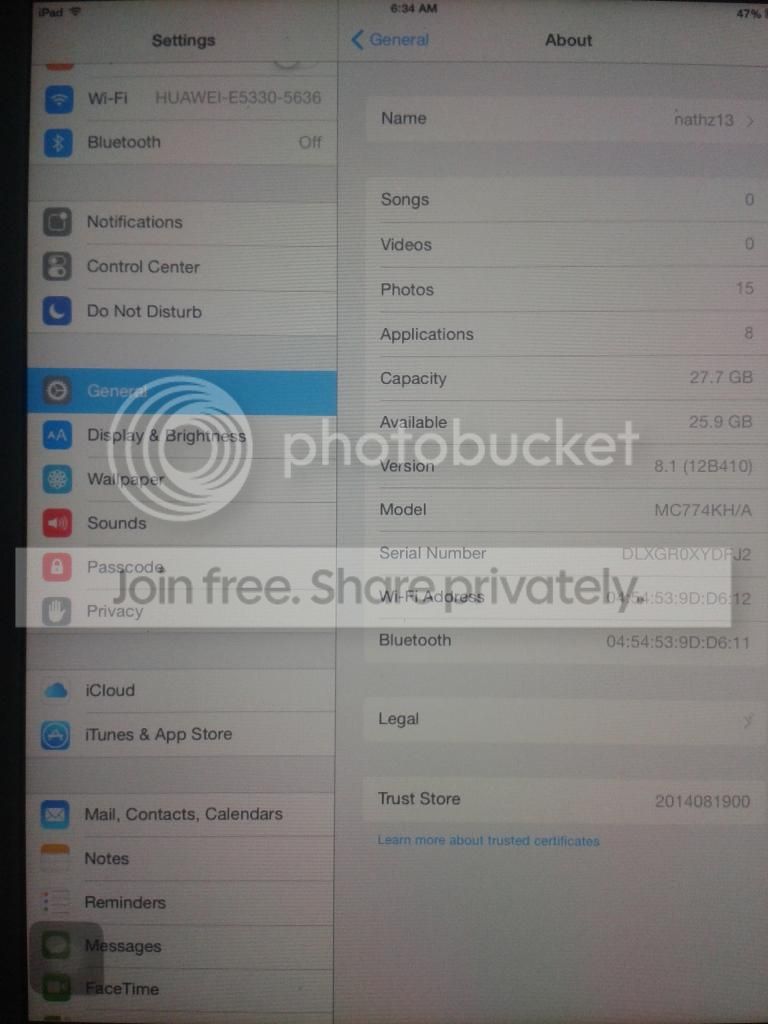

Good Day po mga Master
share ko lang po itong gawa ko last monday
Model: Ipad 2 GSM Model (A1396)
Problem : Icloud Account Activation need to ByPass
Solution : Hardware & Software
Action :
-Disassemble Ipad 2 here is video tutorial

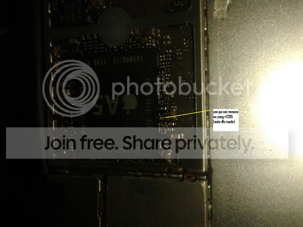

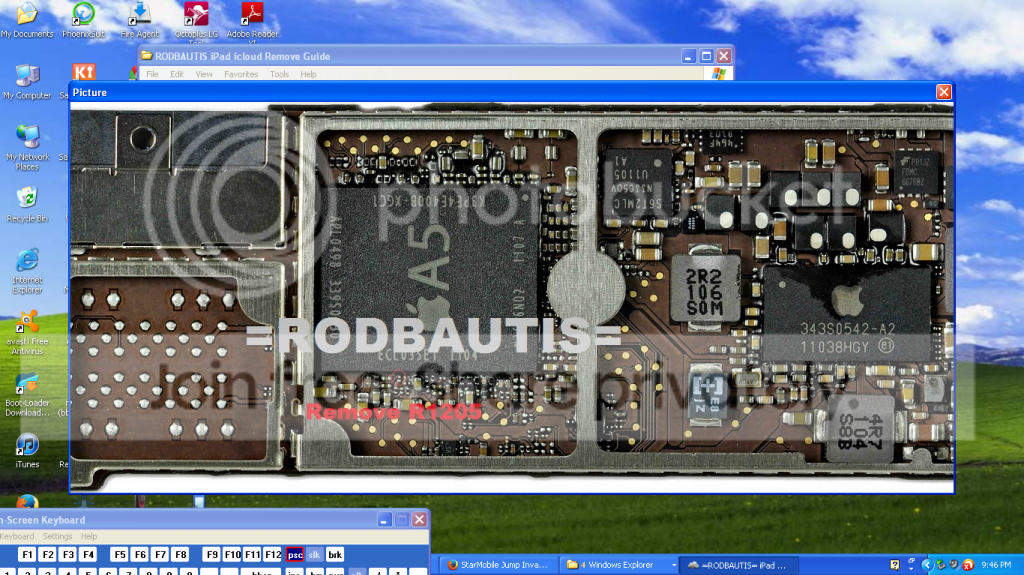

-Remove R1205 for (auto DFU Mode)
pic
ito po tinanggal ko

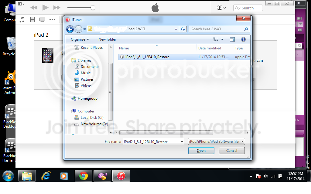

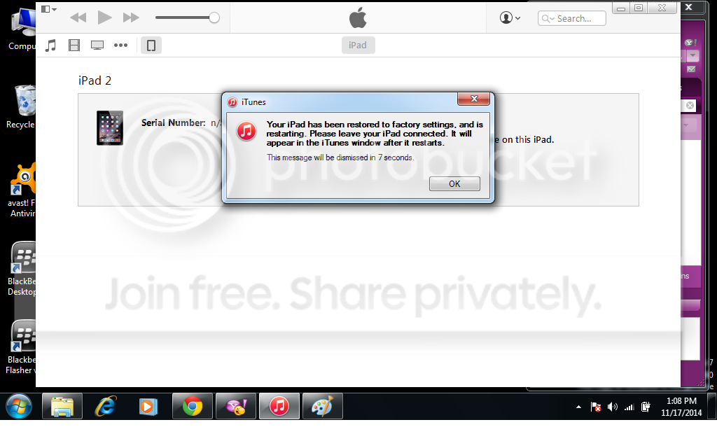

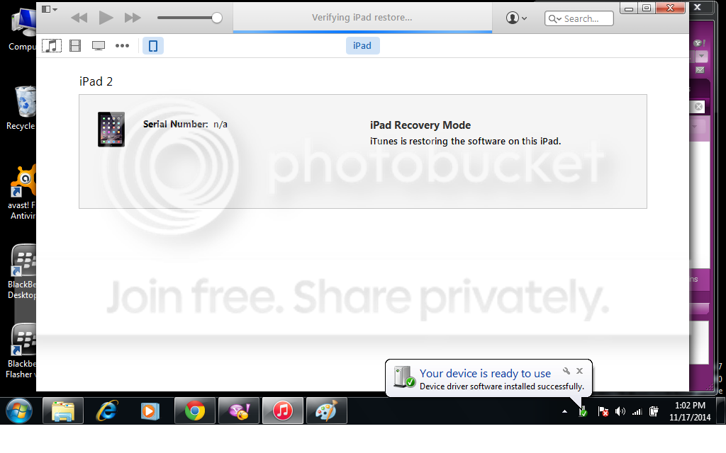

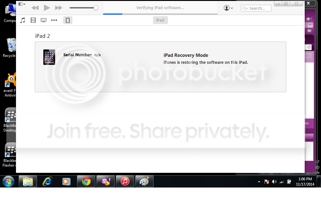

-Restore to Ipad 2 WIFI Model (A1395)
ios 8.1 http://appldnld.apple.com/iOS8.1/031...0_Restore.ipsw
latest
ios 8.1.1 http://appldnld.apple.com/iOS8.1.1/0...5_Restore.ipsw
pics here

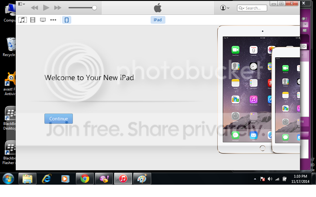

Smile na kasi Get Started na daw
Done!
