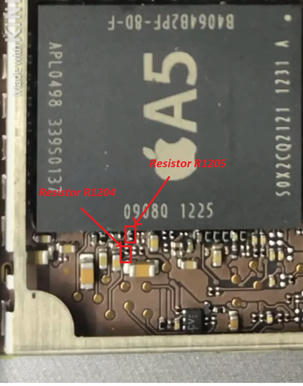

i want to share this image for bypassing icloud for ipad 2 cellular/wifi A1396 and A1397.
-Disassembly the unit
-For Model A1396 Remove Resistor R1205
For Model A1397 Remove Resistor R1205 Then Jumper Or Trasfer The Resistor To R1204
-The Unit Is In DFU Mode After Last Step
-Restore The Unit & Your Done.
boss 2 resistor po ba ang tanggalin?
makikita mo sa image bossing un instruction kung ano model ng ipad 2
ipad 2 model A1396 remove resistor R1205.
ipad 2 model A1397 remove and put R1205 on the spot of R1204.
