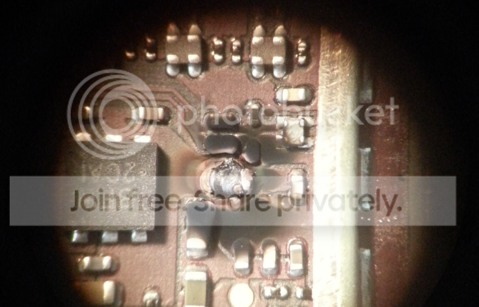

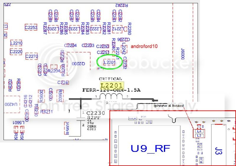

androford10 Premium Account Joined Jan 8, 2016 Messages 731 Reaction score 600 Points 121 Location Talamban cebu,city Feb 9, 2016 #1 first check mo if sunog ba sya.. pasinsya na hindi ko nakunan ng first photo pero same sya nito (credit to owner of this photo) ito ang same value nya para pangpalit just replace l2201 with either L4 or L3 from iphone 4 ito ebidensya (my original photo)
