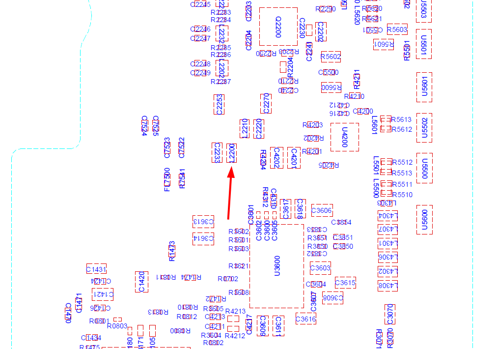

RTO Registered Joined Feb 7, 2019 Messages 792 May 20, 2019 #1 credit sa totoong mayari ng thread.... Model: IPad 3 Problem: Half BackLight Not Working Action Taken: 1. Change LCD - No Luck 2. Remove then Jumper ( L2200 )
frank_vincent Expired Account Joined May 24, 2015 Messages 419 Nov 10, 2020 #2 boss paturo ..san mo jinumper po
armendz_tech70 Registered Joined Mar 23, 2016 Messages 111 Nov 11, 2020 #4 maxie said: ayan po sir Click to expand... thanks po bos
