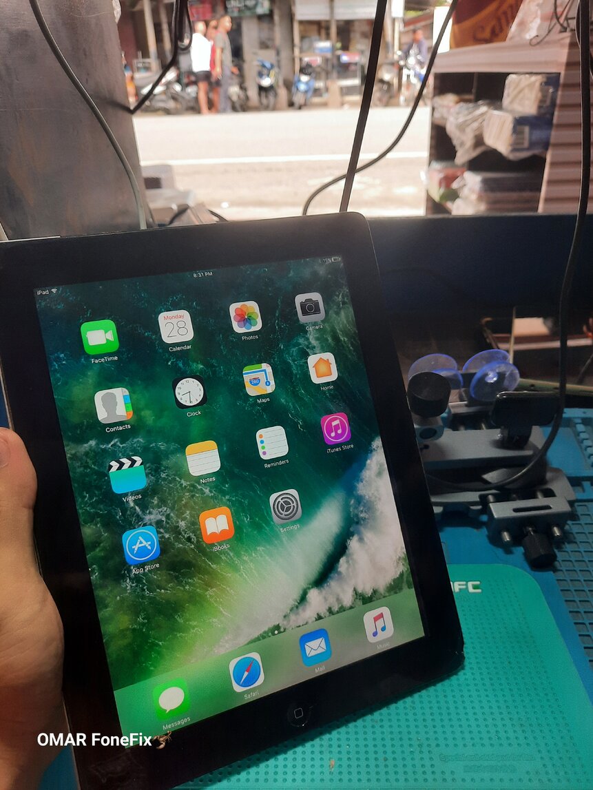

Sinubukan ko buksan para hardware solution sana kaso tanggal na pala resistor which means bypass na ang unit dati..
Solution:
Using iRepair P10
DFU mode unit
Connect then purple mode
dapat lumabas info
Then palitan mo ang serial..
(hanap kung merun ibang iPad 4 na activated yun gamitin mong serial)
kung wala pm mo ako merun tayu serial
paste yung bagong serial
check the box for serial
click WRITE..
normal mode unit then activate

SIR SAAN PO BANDA SISITOR NYA

boss bka may serial no ka ng ipad 4
