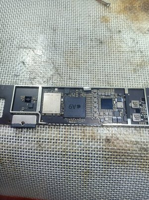

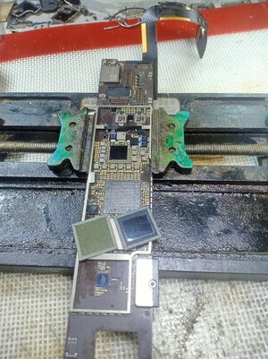

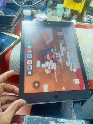

Ipad 6th gen No display , 1st move try ibang LCD negative result.. then check LCD connector and around connector like diode and filter but good... mild reheat CPU ayon nag ka display pero pag lamig no display ulit.. kaya final option reball CPU Solved..
