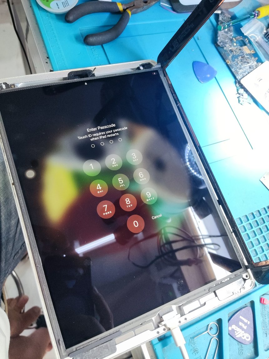

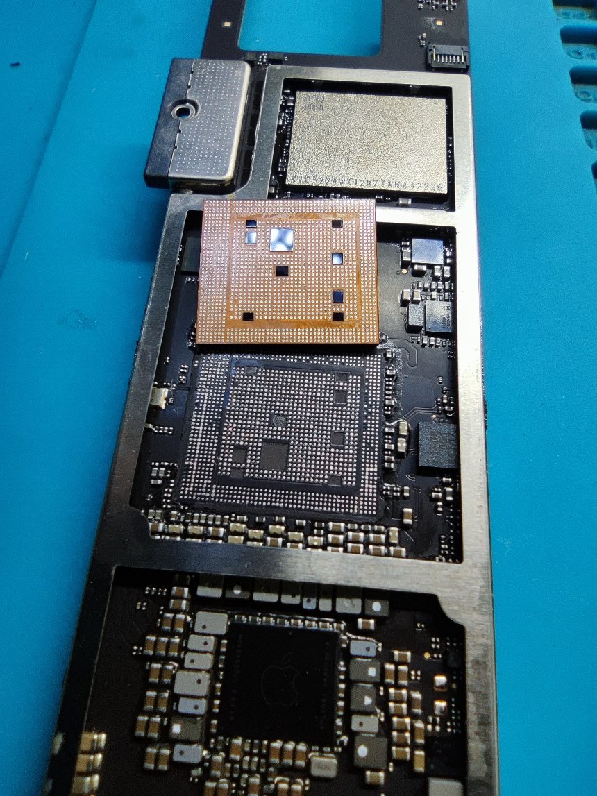

History:
Bigla nalang daw namatay habang ginagamit
Problem:
No power, No display
Test:
- Nag chacharge upto 0.55A consumption but walang display
- 3.8-4v sa battery terminal pag sinalpak ang charger
- 1.3v sa power switch
- connect to dc bench, pag press ng power meron lang 0.03A steady
- walang short caps so far
Mahirap itrace ibang lines dahil walang boardview or schematics sa borneo. Meron sa XZZ pero hindi masyadong detailed.
Ano kaya possible na may tama nito mga boss?
UPDATE:
Fixed na po reball CPU lang.
check mo sir light ic diode mode ka. Pag goods naman posible need reball cpu since low current sya
