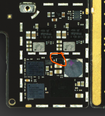

ibang tanong:
sa touch panel ask ko lng anong diode or saan model may common nito
NSR10F40NXT5G 2-DSN (1.4x0.6) DIODE SCHOTTKY 40V 1A DSN2 0502
