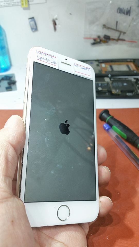

HISTORY: NAG GAGAMES ANG CUSTUMER HABANG NKA CHARGE...THEN BIGLA NG OFF..
DI HALATA ADDICT SA MOBILE LAGENDS =))=))

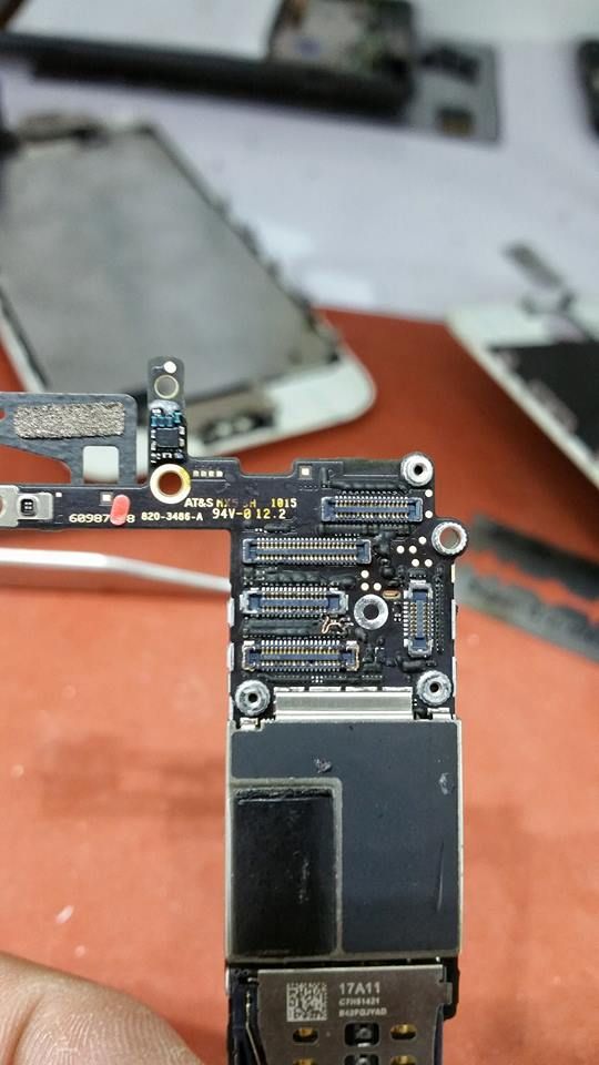

BASIC STEP:
*CHECK KO ANG UNIT CHARGE NO REPONSE
*CAREFUL SA PAG BAKLAS KC MAHAL ANG LCD SET SA TOUCH SCREEN...
*CHECK KO SA TESTER WALANG SHORT..
*TRY KO DIRECT POWER SUPPLY NO RESPONSE.
*CHECK KO ANG CHARGING PORT OK NAMAN.
*DERITSO KO NA PINALITAN NG U2 IC KC NKA CHARGE THEN BIGLA NG OFF.
*SORRY SA PHOTO KONTI LANG.
AFTER U2 IC REPLACE
DONE!
