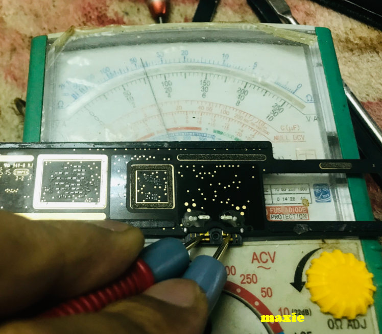

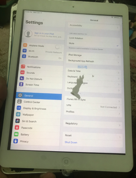

Unit :
iPad air
Model : A1474
Problem : Dead and shorted

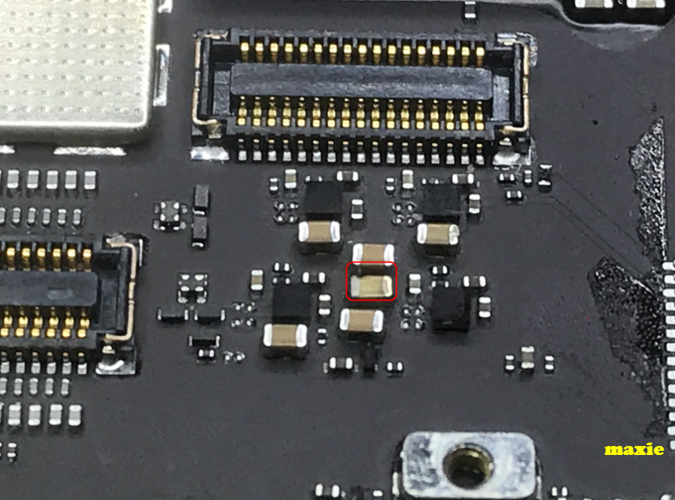

Diagnose : Trace the line and i found out Busted Capacitor [ C2010 ]
Inner Line : PPBAT_VCC
Solution : Remove Capacitor or remove and replace
