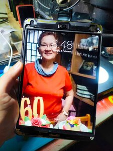

HISTORY KASI BINUKSAN NI TUMER YUNG UNIT NANG SYA LANG BAKA DI NA REMOVE YUNG BATT.
1ST: CHECK CHARGING AMPERE OKAY NAMAN NORMAL LANG. PAGSALPAK PC DETECTED DIN SA 3U TOOLS LAST POWER SUPPLY NORMAL CURRENT LANG DIN.
2ND: TURN ON KO TAS INILAWAN YUN MAY DISPLAY WALA LAG PALA BACKLIGHT.
3RD: TRY KO MUNA TEST NEW LCD AYON WALA PARIN BACKLIGHT

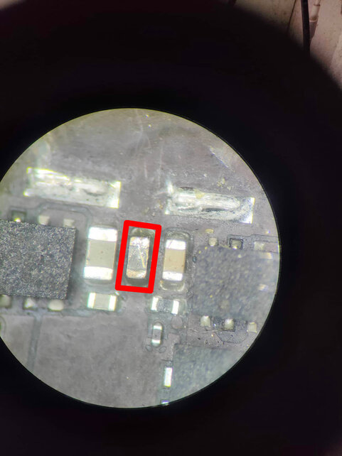

4TH: CHECK KO NA BOARD YUN PUTOL PALA FUSE.
CHECK NYO NALANG PIC SA BABA
ITO YUNG FUSE TEST KO CONTINUITY/BEEP MODE SA TESTER YUN PUTOL SYA. JUMPER NALANG GINAWA KO PERO MAS MABUTI IF PALITAN TALAGA

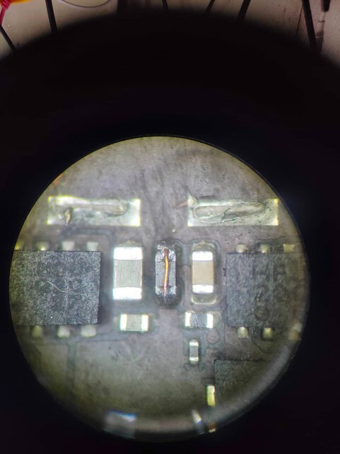

YAN YUNG JUMPER NA GINAWA KO DI KO NA REMOVE YUNG FUSE PARA MAS MADALI. PAG MAY PAMPALIT MAS MABUTI PARA IWAS BACKJOB TALAGA.

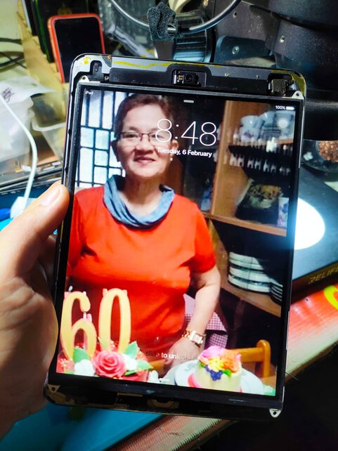

ITO NA MAY BACKLIGHT NA. SANA MAKATULONG

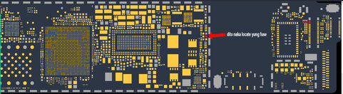

JAN PALA NAKA LOCATE YUNG FUSE PARA DI NA KAYO MAHIRAPAN MAGHANAP (L2200) NAME NG FUSE
Tested po master
L2200 ba tama? backlight filter
