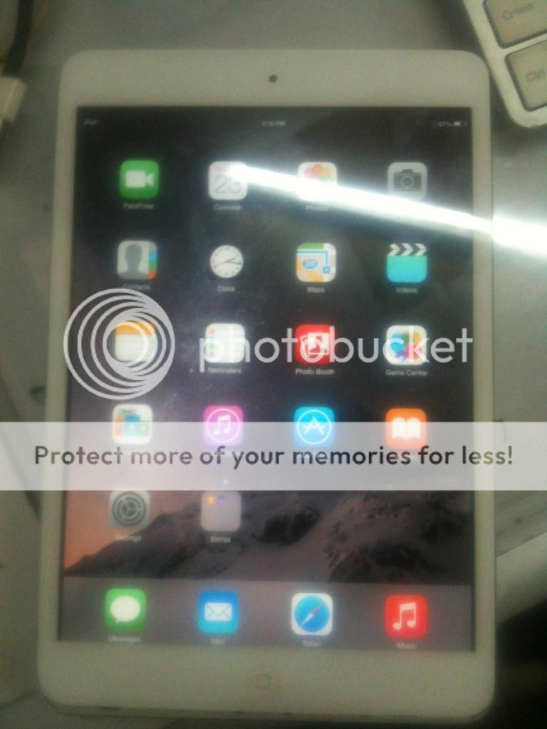

VERY SIMPLE ANG HARDWARE NITO
THANKS SA ORIG POSTER

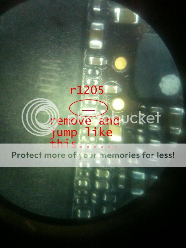

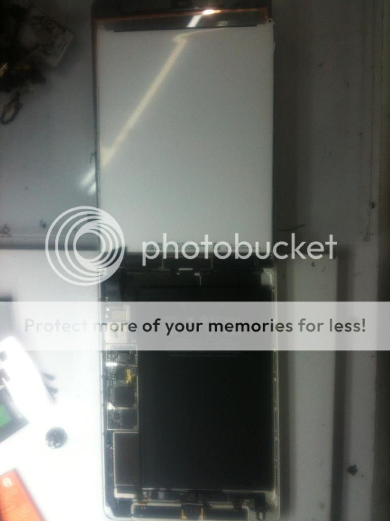

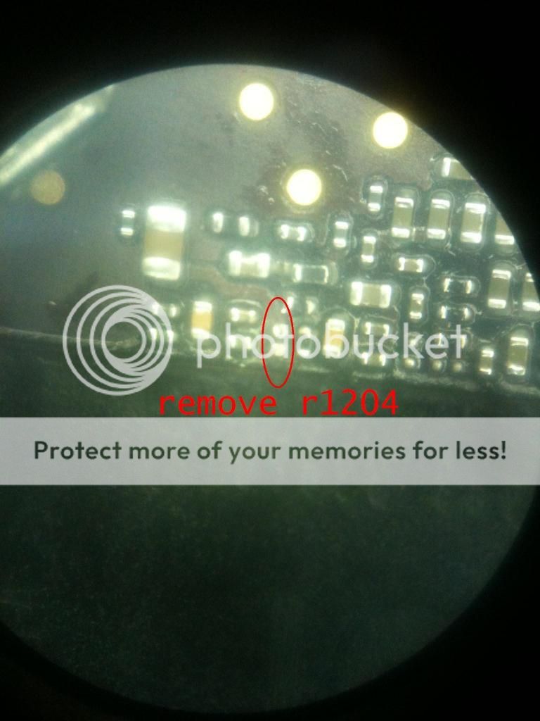

baklas unit...ingat po lagi sa pagbaklas para iwas abono.
This image has been resized. Click this bar to view the full image. The original image is sized 768x1024.
mas doble ingat po tayo sa steps na ito,dahil isang mali,malaking aberya.

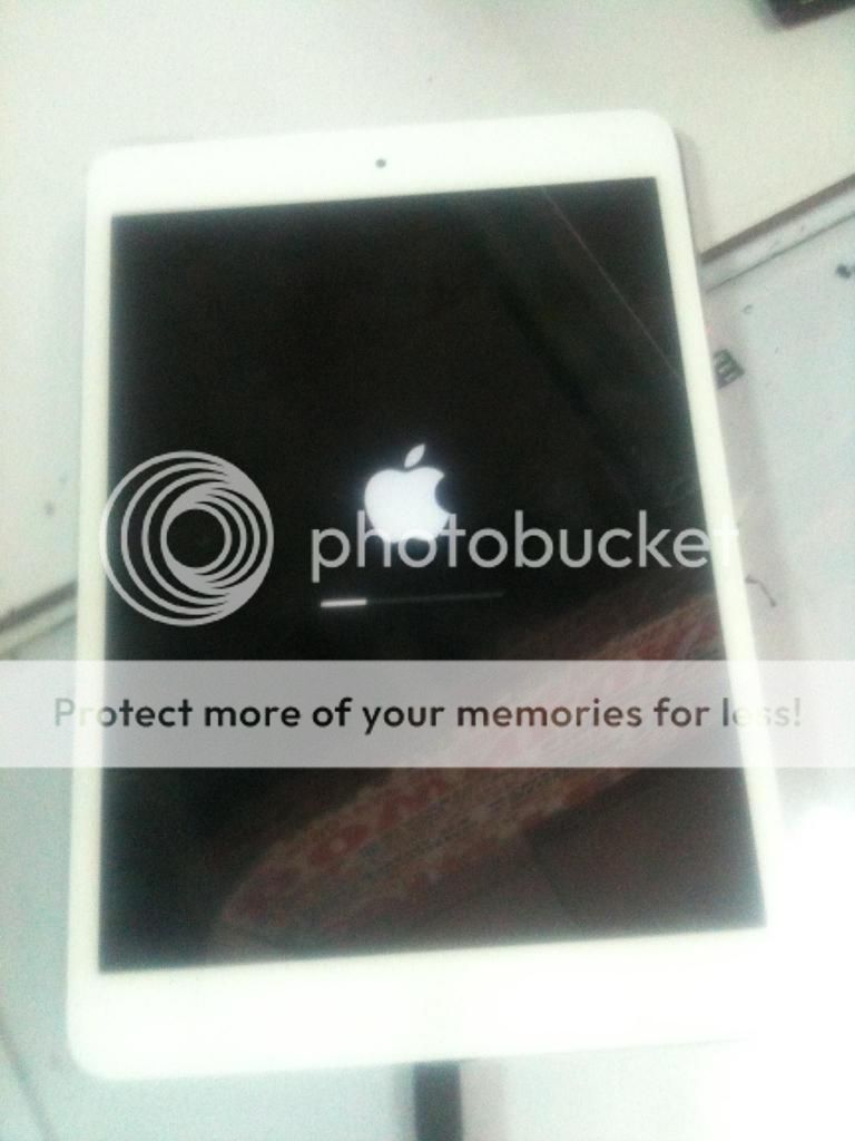

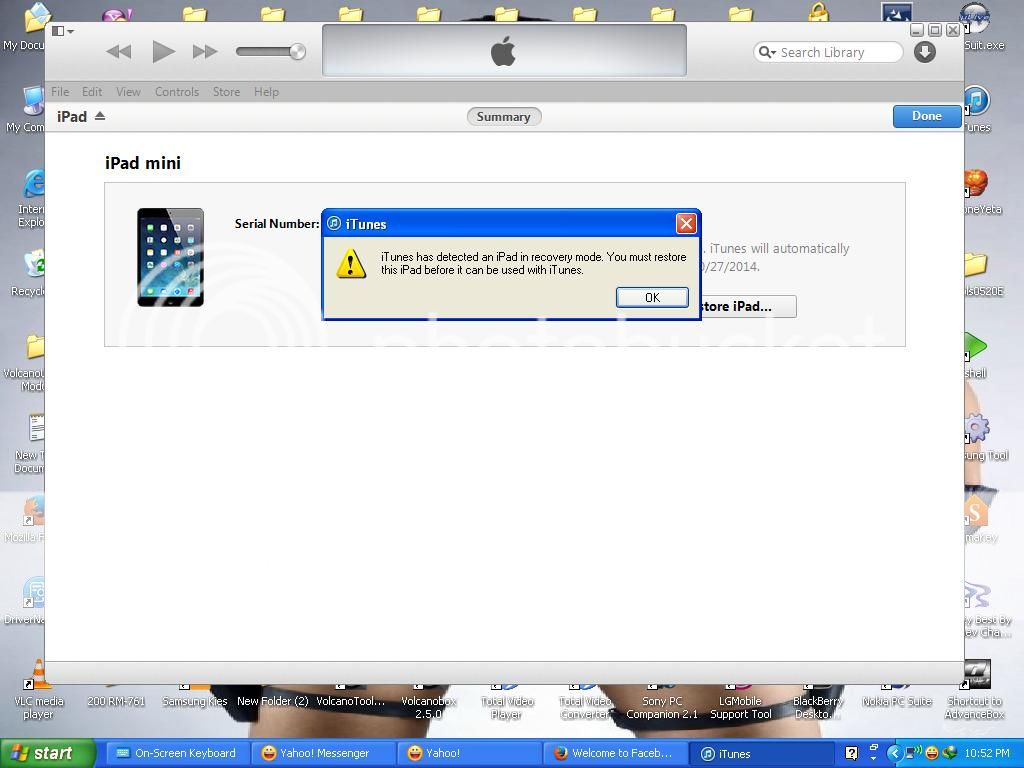

reassemble at connect sa itunes then restore with this firmware
This image has been resized. Click this bar to view the full image. The original image is sized 1024x768.

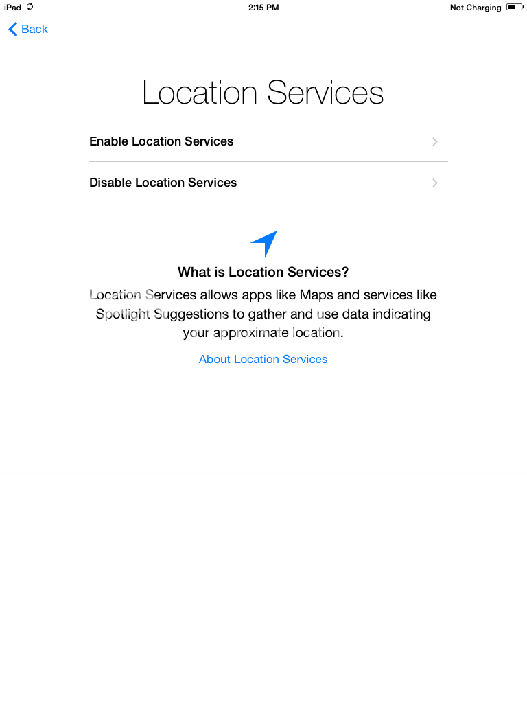

done sa restoring na po...

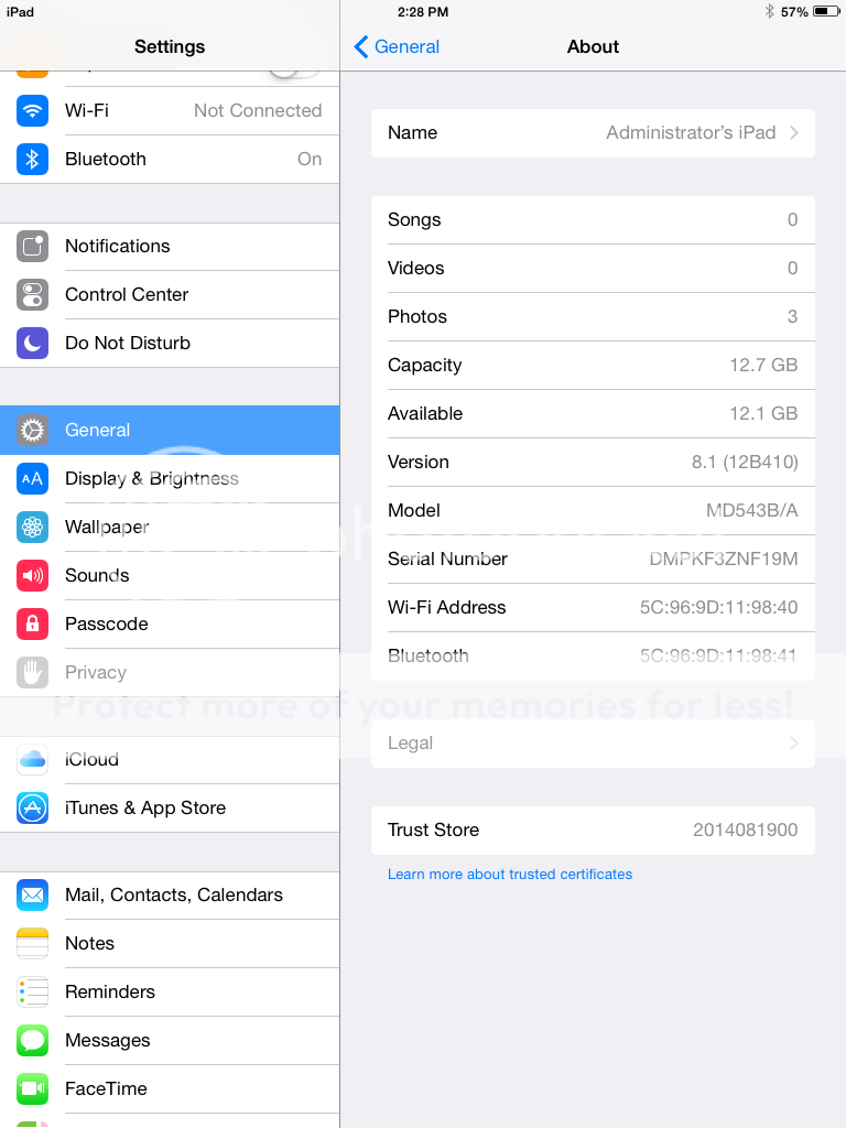

i0s 8.1...
good luck po at ingat lagi para iwas abono...
