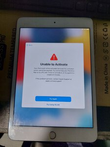

REFERENCE ipad mini 4 activation problem

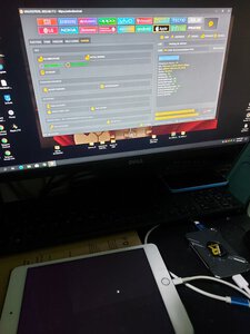

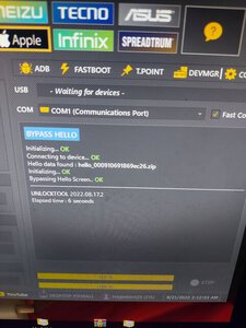

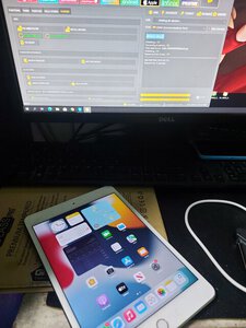

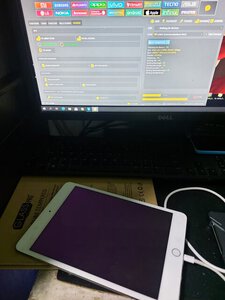

paki edit boss thread mo pakilagyan txt procedure para makatulong din sa mga newbie
sample :
first we need irepair box plus dcsd cable.
put phone into dfu mode,once detected click dfu mode
replace serial number use this FCHP606DG07R then write
tick exit recover from irepair
next,run unlocktool
go to apple tab
ramdisk tab
connect iphone in normal mode
tick get activation.
we must see this >>> activating with server..ok <<<
put phone again into dfu mode
next step
pwned dfu for ios 15 to detect dfu mode
use unetbootin,load iso file,select drive c
https://www.mediafire.com/file/oti5asicl7f33cl/Build_usb_Run_Checkm8.rar/file
restart pc..select unetbootin
hold alt+f2
look for the message " device is already in pwned dfu mode" thats ok..
hold ctrl+alt+del to restart pc
dont do anything to phone ( leave it in pwned dfu mode )
run again unlocktool
click boot ramdisk
sometimes it tooks about 10 to 15 mins just wait til
booting ramdisk results ok.
final click bypass hello
