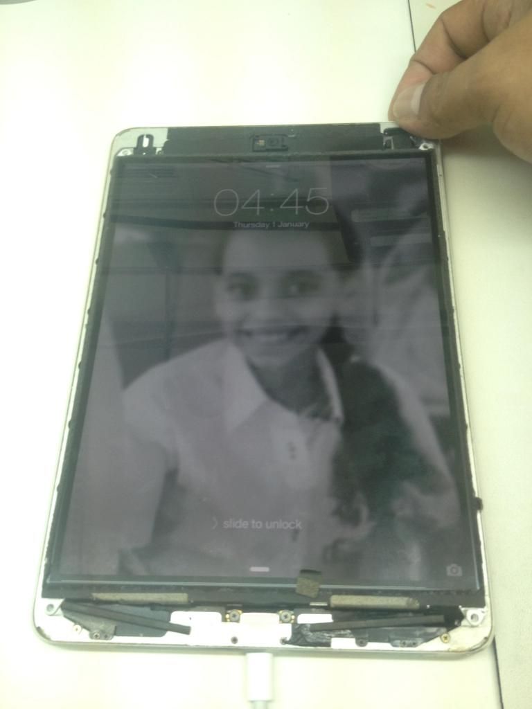

MAGANDANG ARAW!!! SHARE LANG PO..
IPAD MINI NO POWER DONE!!!
-DI PO MA-DETECT SA PC..
-LONG PRESS HOME BUTTON + POWER.. (NO LUCK)

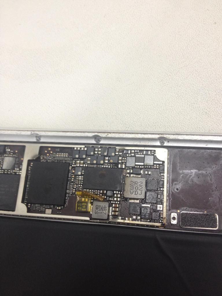

KAYA PO BINUKSAN,, CHECK SA BAGONG BATTERY (NO LUCK),

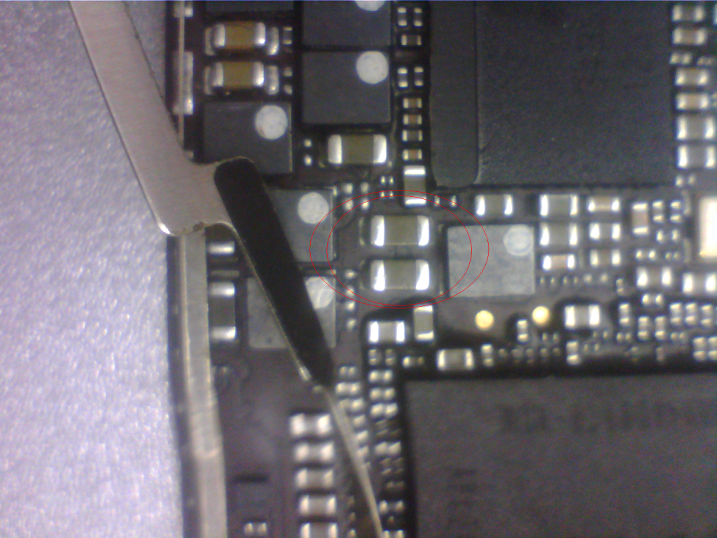

NAPANSIN KO NA UMIINIT ANG PM IC, AT SHORTED UNG 2 CAPASITOR, PALATANDAAN PO NA PM IC TALAGA ANG SIRA,
PERO SINUBUKAN Q PA DIN PALITAN MUNA ANG U2 PERO GANUN PADIN,

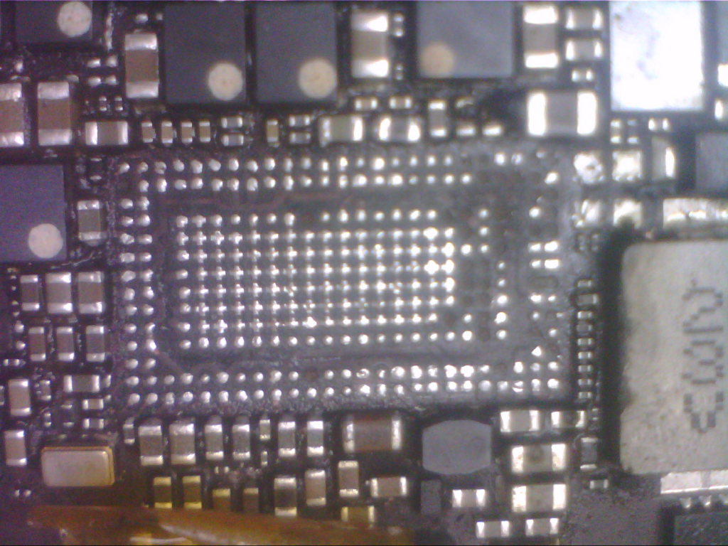

KAYA BINAKBAK KO NA ANG PM IC, AT NILINIS MABUTI ANG NATIRANG SEALED SA BOARD,
KUNG MAPAPANSIN MARAMING ABSENT, PERO NAGBAKASAKALI PADIN AKO NA LAGYAN NG PM IC.
DAHIL NAPANSIN KO DIN NA MAY MGA LINYA PANG PWEDENG PAGKABITAN NG MGA BOLA NG IC
SA GILID NG OPEN PATTERN.
ALALAY KONG DINIINAN UNG IC HABANG INIINIT PARA KUMAPIT.
AT MABUTI NAMAN NABUHAY PA.. SALAMAT..
