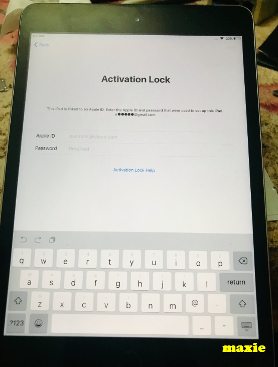

Unit : Apple
Model : A1600
Problem: iCloud
Solution: Convert into iPad mini 3 wifi

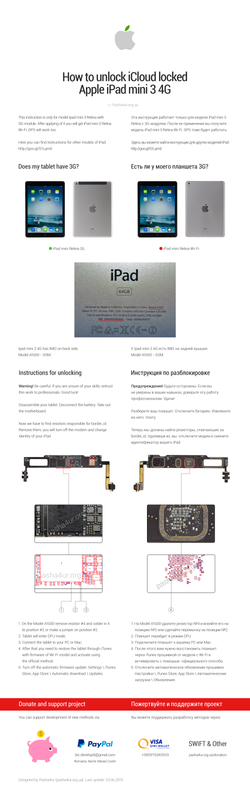

Jumpers and resistors na kailangan tanggalin right click and download the image para ma zoom mo

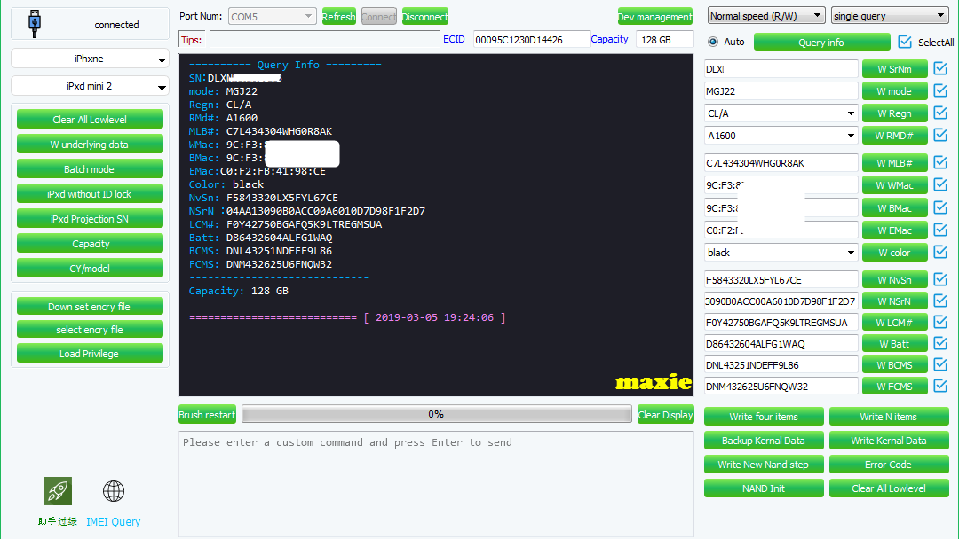

- Remove Nand

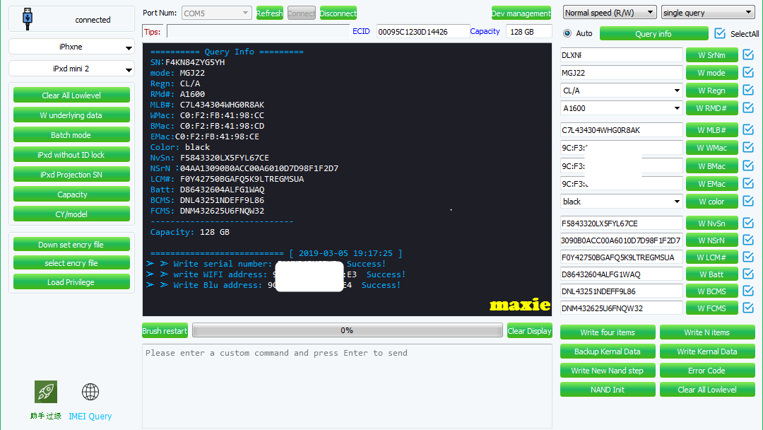

- Buy New serial [kung serial hanap meron ako instant and solo serial pero mas mabuti na kuntakin nyo admin, mahal sakin
] - Write New serial

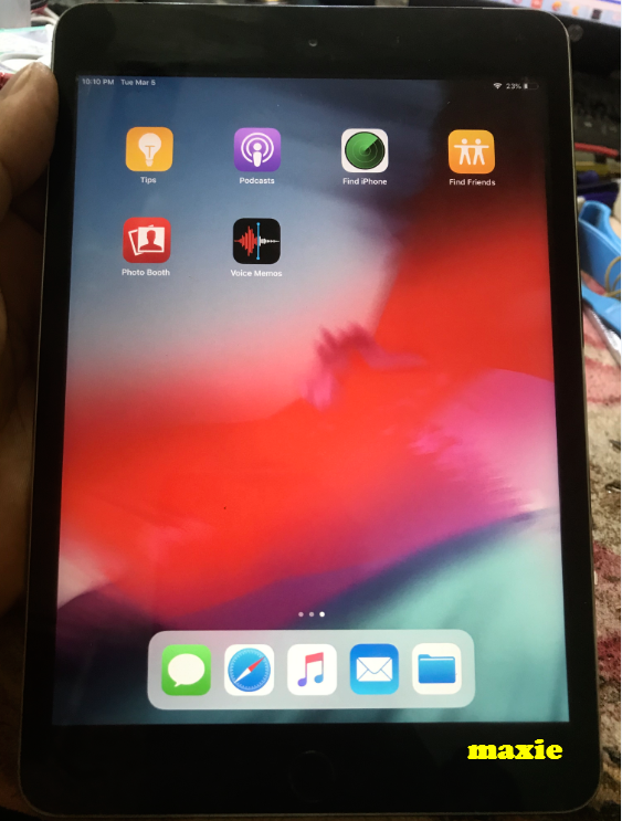

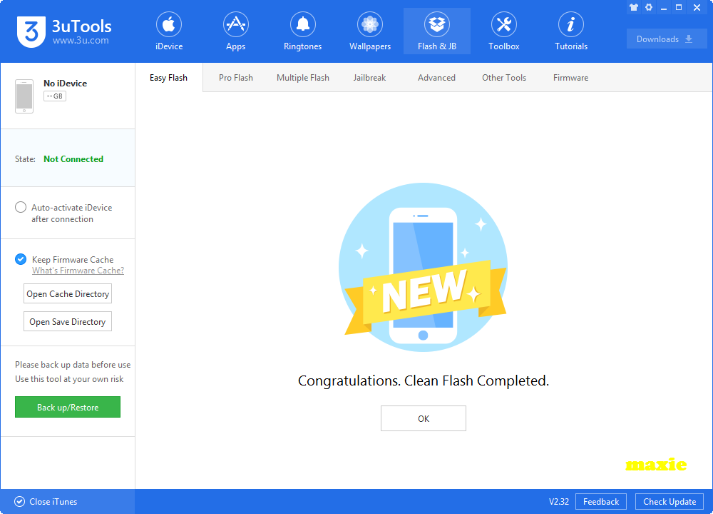

- Restore to ipad mini 3 wifi
- Activate
- Done
