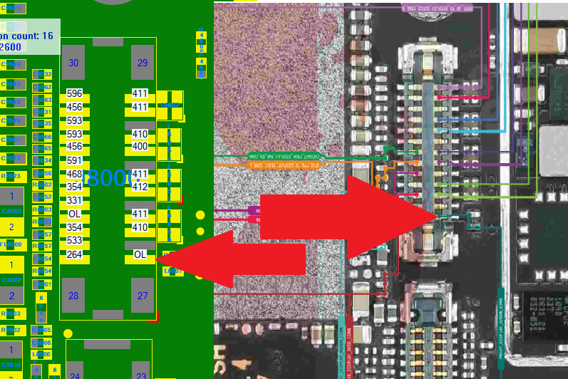

From cotech
tried na nila ilang lcd still black screen
kaya pinasa na sa akin..

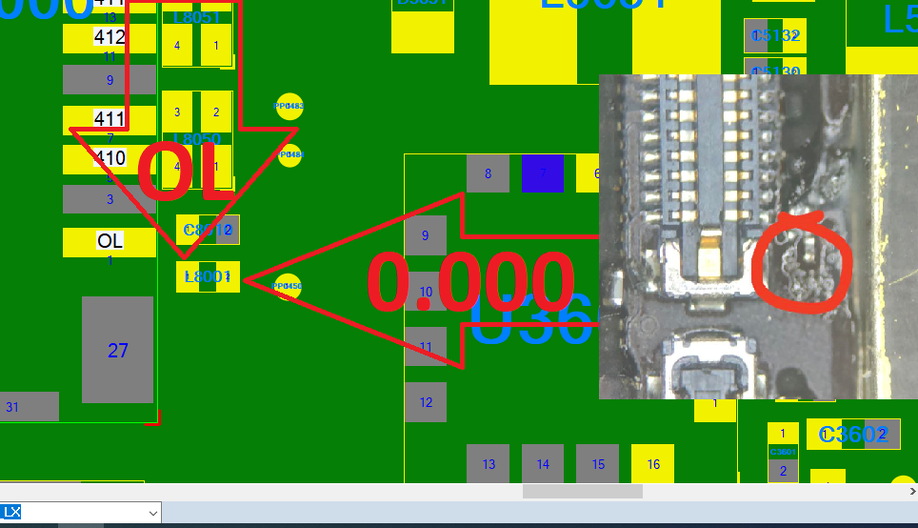

1st diagnose FPC ng Lcd kailangan may value..
hahanapin shorted to ground 0.0000 a diode mode rreading
or open OL naman ang reading.
AVDDN pin reading 0.000 so ibig sabihin shorted to ground..
dapat OL..

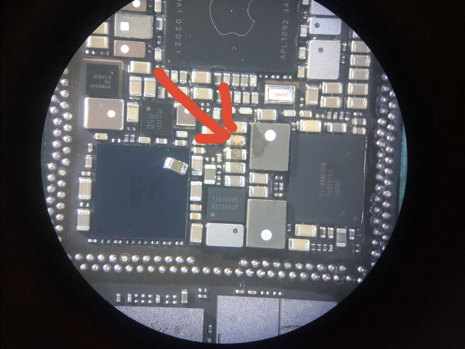

1st na ginawa isolate fuse
para malaman kung shorted ang katabing capasitor
or need nating biyakin ..
shorted to ground 0.000 rail pa puntang Chestnut ic
kaya biyakin at shorted ang iang capasitor
replace po wag remove..
dahil pag may problema sa rail isa na lang mag filter na capasitor at maliit pa..
assemble and done..
