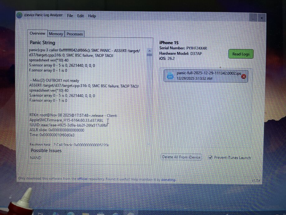

kingjasz Premium Account Joined Nov 4, 2022 Messages 2 Reaction score 2 Points 1 Location Tarlac City Dec 29, 2025 #1 napalitan na battery same pa din po. Natry ko na po idisconnect ang charging flex restart pa din po Last edited by a moderator: Yesterday at 9:04 PM

FredzyNoy Premium Account Joined Apr 9, 2018 Messages 1,791 Reaction score 3,434 Points 741 Location 845 m.de la fuente st.sampaloc,manila Wednesday at 9:44 AM #3 yung sa panic logs sa mismong cp boss lapag mo rin dito para maanalyze ng ibang magigiting sa apple Last edited: Wednesday at 11:17 AM
LrizzDiablo Premium Account Joined Aug 4, 2024 Messages 15 Reaction score 10 Points 1 Location Cubao Quezon City Wednesday at 11:28 AM #4
FredzyNoy Premium Account Joined Apr 9, 2018 Messages 1,791 Reaction score 3,434 Points 741 Location 845 m.de la fuente st.sampaloc,manila Wednesday at 2:06 PM #5 try orig charging flex boss pag same sa power flex naman
larstech30 Premium Account Joined Nov 5, 2025 Messages 46 Reaction score 71 Points 1 Location quezon city Wednesday at 3:16 PM #6 kingjasz said: View attachment 40360 Click to expand... kingjasz said: View attachment 40360 Click to expand... try change power switch or sensor kadalasan yan lagi ang issue ng iphone 11 nakaka ilan narin ako nyan sa power switch lang nadadali
