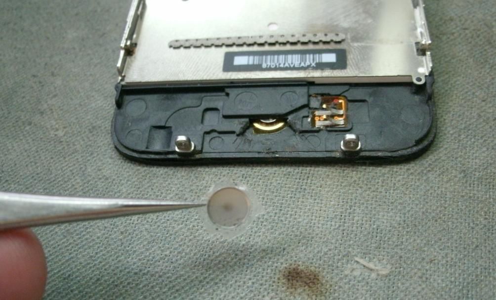

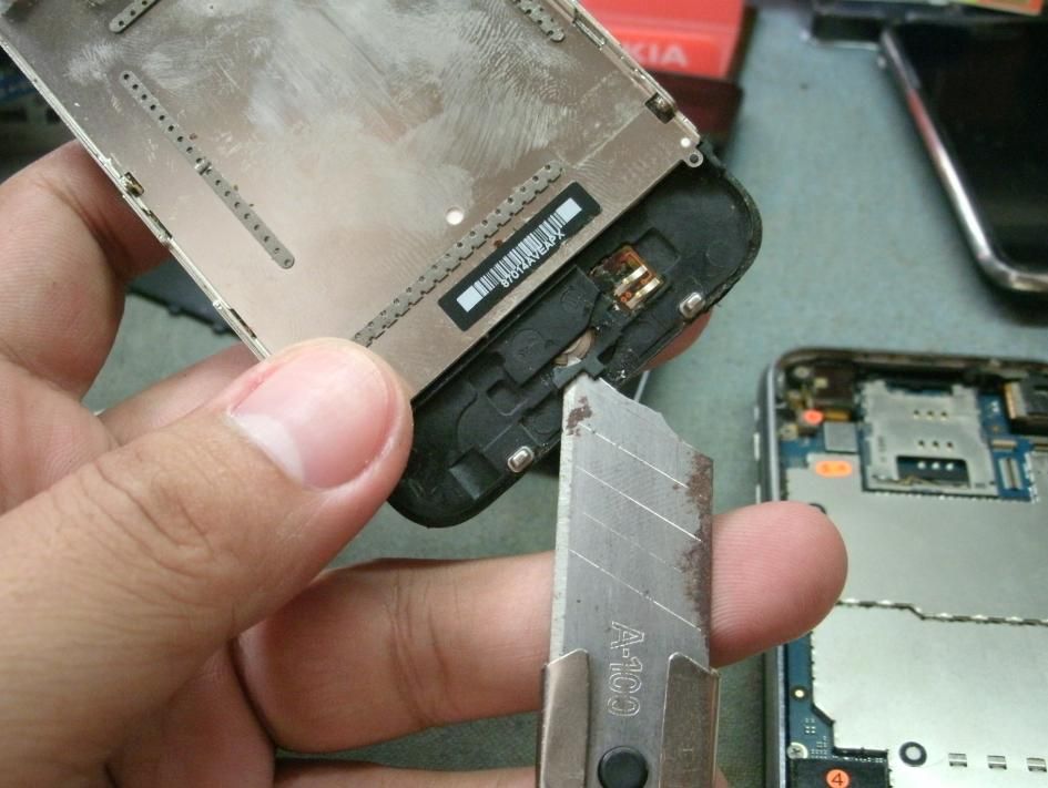

- carefully CUT the plastic that cover the Home Button membrane (i use blade cutter)
This image has been resized. Click this bar to view the full image. The original image is sized 945x711.
This image has been resized. Click this bar to view the full image. The original image is sized 966x718.

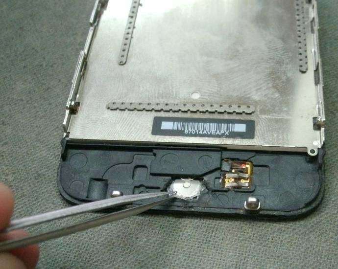

- Remove Home Button metal Membrane using tweezer
This image has been resized. Click this bar to view the full image. The original image is sized 690x550.

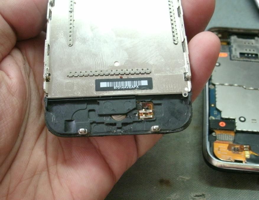

- now Clean the membrane using pencil eraser or cotton buds and etc.
This image has been resized. Click this bar to view the full image. The original image is sized 1004x607.

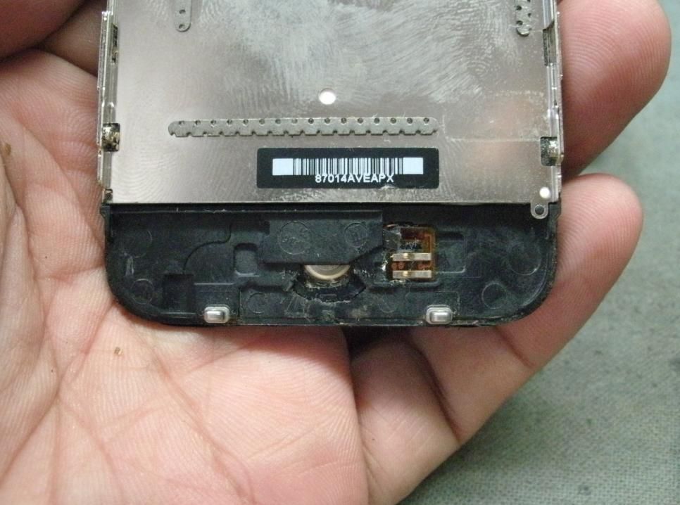

- you can now assemble the phone after cleaning
This image has been resized. Click this bar to view the full image. The original image is sized 942x703.
