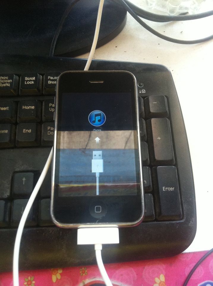

UNIT: IPHONE 3g [8gb]
STATUS:Recovery lang!

1.una ginawa ko try ko fix sa tiny umbrella pero no luck[recovery ulit pag reboot.

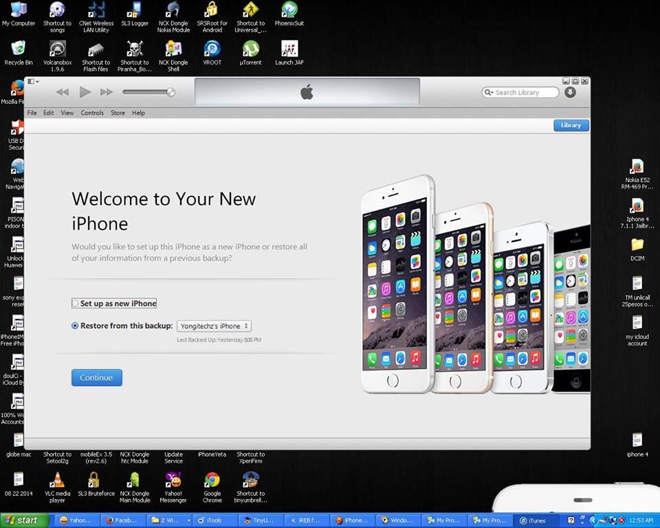

4.Kick mo sa ireb,then restore uli sa 4.1...kulitin lang hanggang magtuloy....DONE!!!

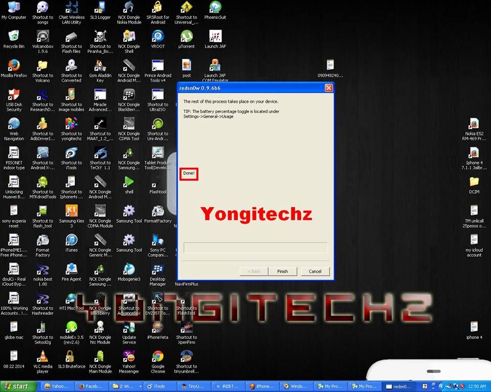

5.Jailbreak using redsnow 0.9.6b6,then unlock via iphoneyeta[no wifi]

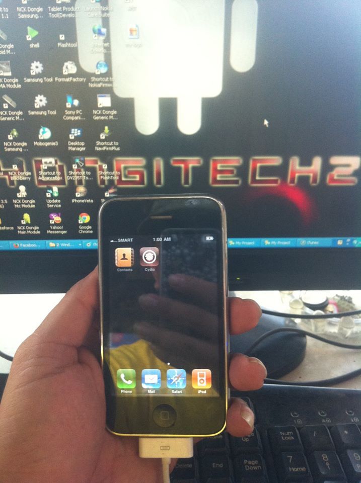

6.And the last my finish product!heheh
