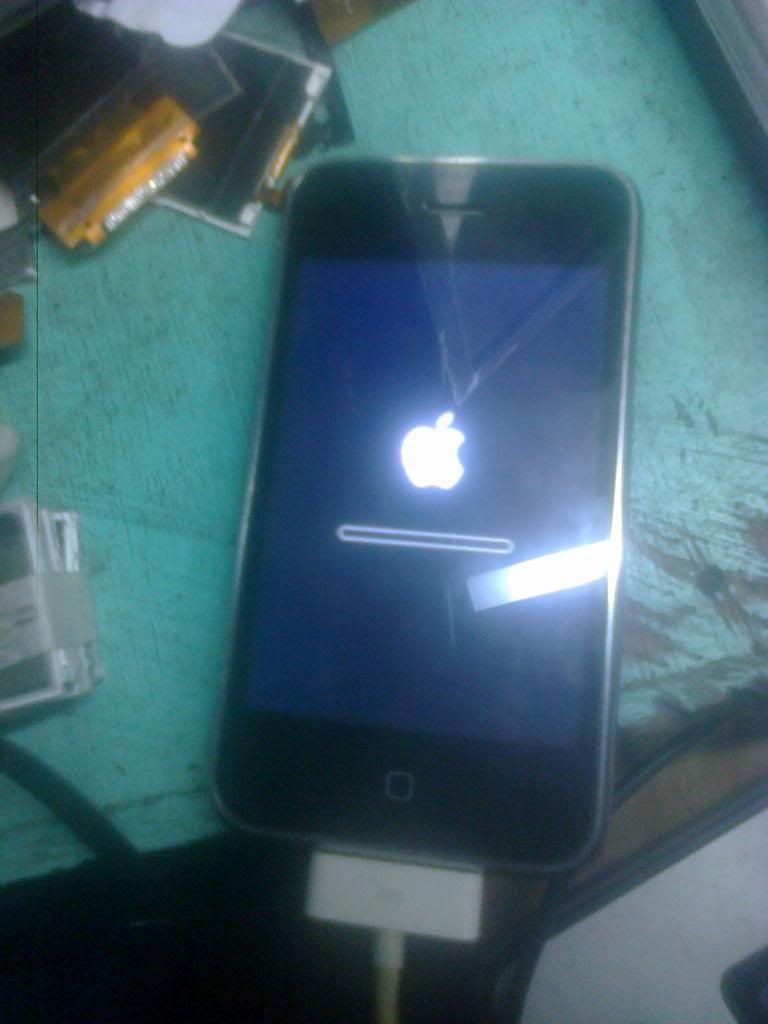

iphone 3g apple logo then off{DONE}
SHARE ko lang mga mates sa tanggap ko

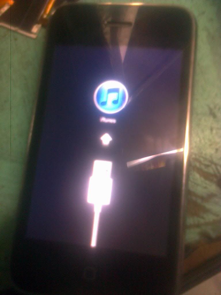

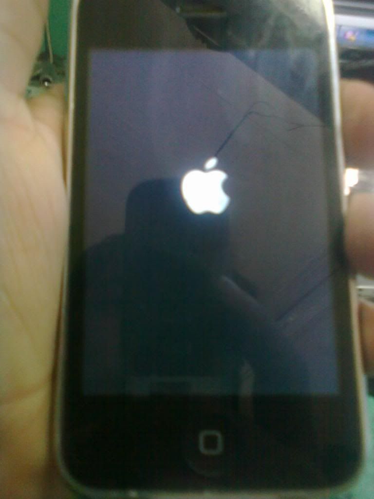

iphone 3g 8gb color black ,pagswitch on LOGO appears thin 2 seconds off.
tested tricks many times:
din assemble na i try to open:

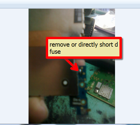

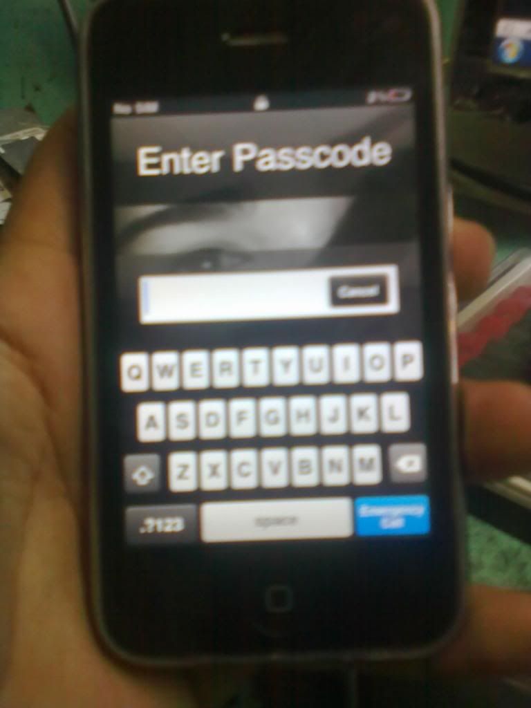

tanong ko si tomer sa pass: di pla nya alam nabili lang nya pla
kla ko pera na ;; pero ok lang kunting hipo nalang at may additional pa..

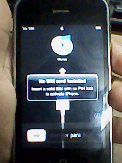

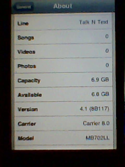

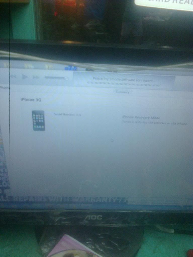

PROCEDUR: restor sa itunes using ios 4.1,

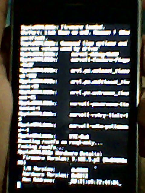

mag eeror yan ng 1015 open si iphonyeta click fix recovery and hit exit recovery m
mode, antayin kusang magreboot .

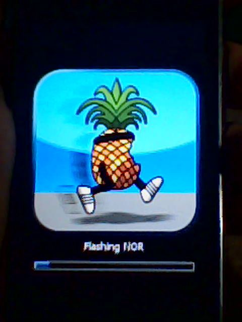

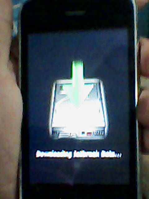

open MAUI TOOLS click redsnow para sa JB install cydia then use same ipsw or
ios na nka install sa phone.

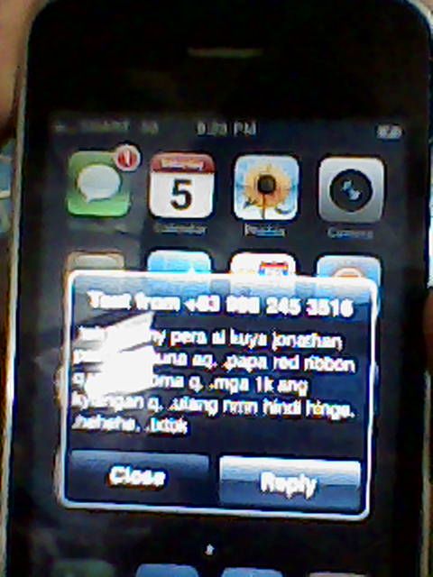

Last is click UNLOCK ULTRASNOW NO WIFI din reboot 2 times
ok napo sya worth of 800 lang nmn.
