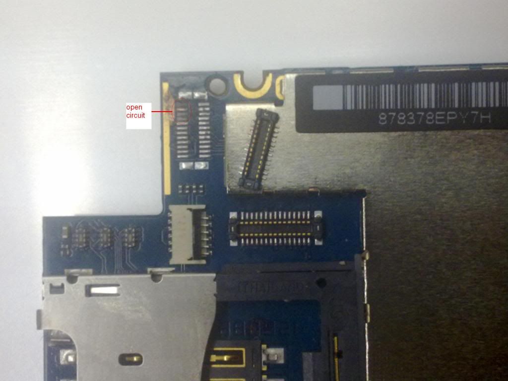

Binuksan ko ang Unit water damaged pala tinamaan sa may Display interface..
1st step clean and change new LCD pero same problem pa rin..

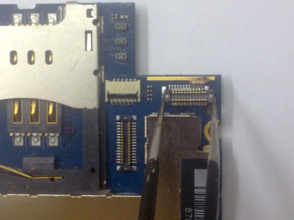

ginawa ko remove ko DISPLAY INTERFACE..may four legs pala na open circuit..
see pics below..
then pinalitan ko ng bagong Display socket

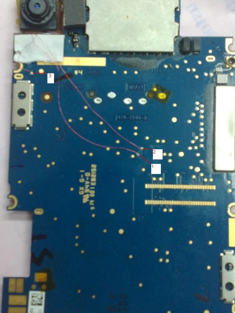

then traced ako sa ng connection sa isang board..

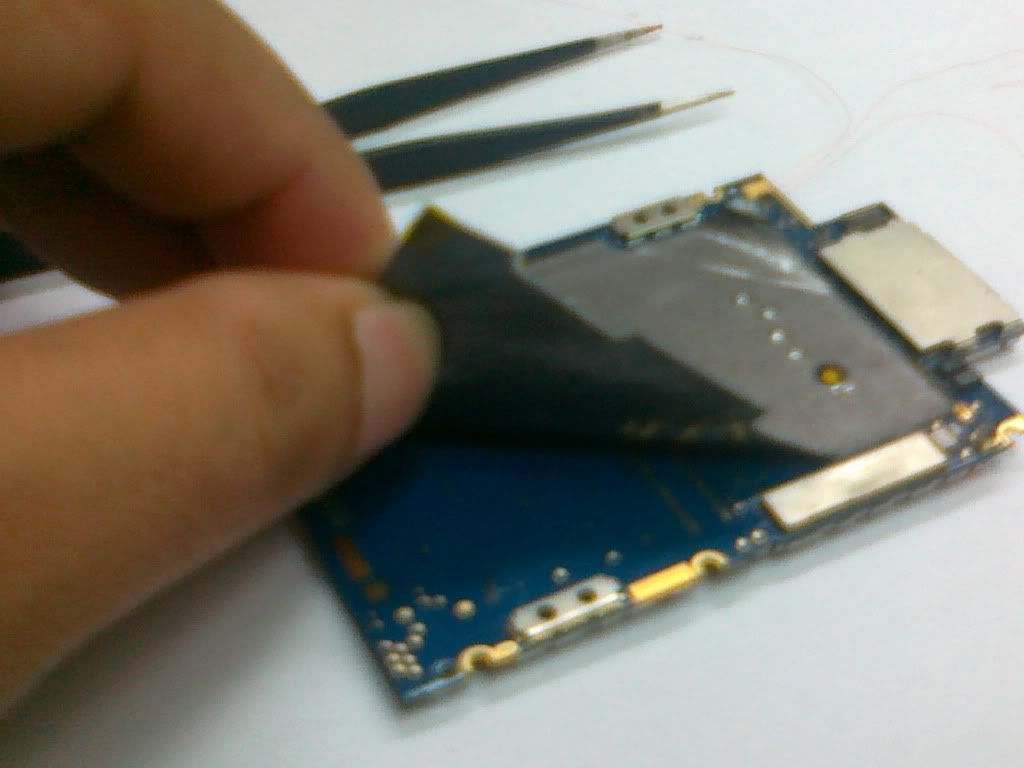

removed this sticker kasi dito po ung mga jumper point ng DISPLAY..

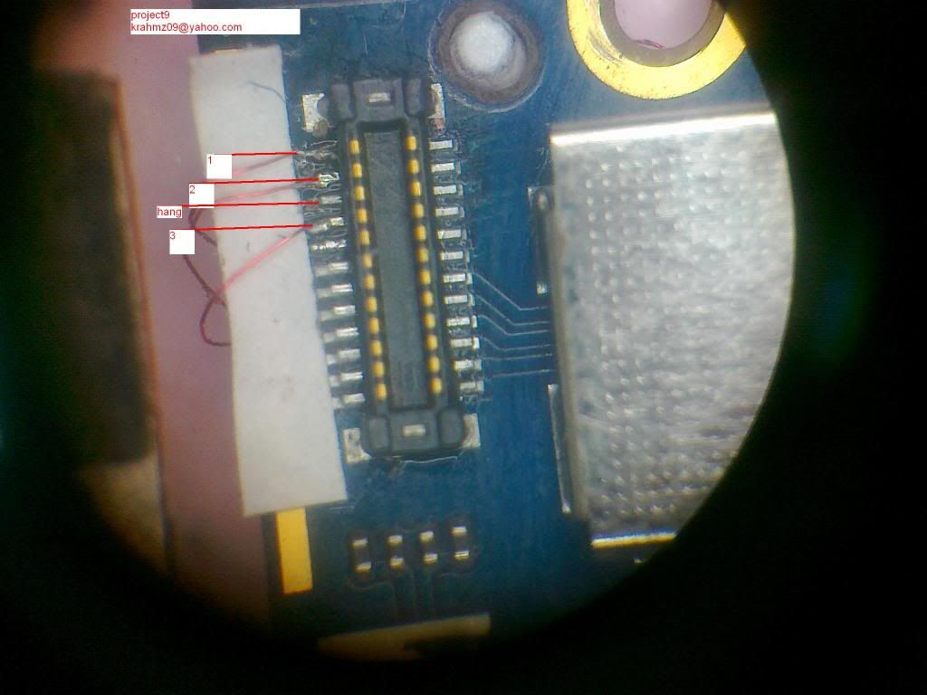

then do this connection
just do connection on the following numbers from display interface to the jumper points.

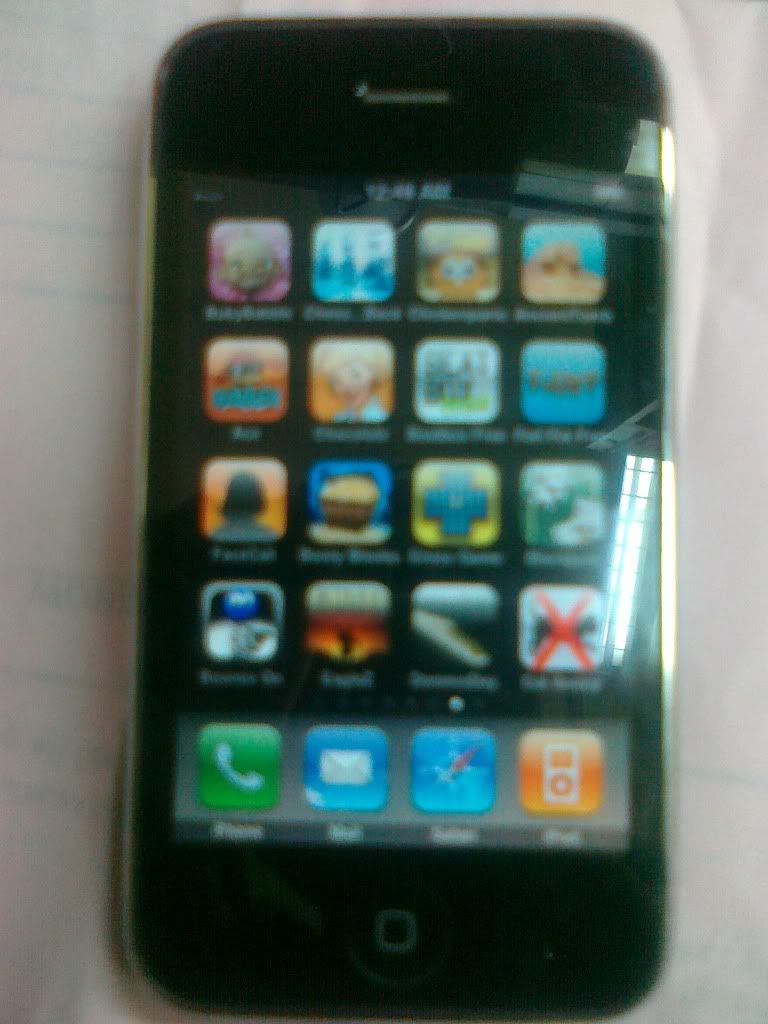

resulta eto na...
finished product
see pics below..
resulta eto na...
finished product
