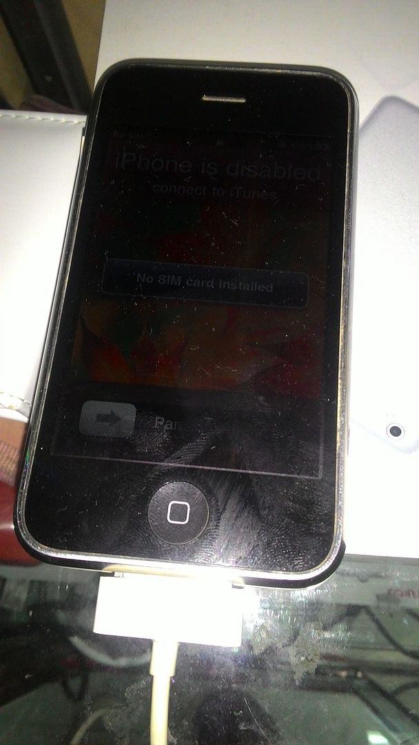

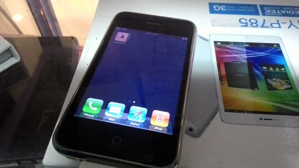

share ko lng po iphone 3g disabled program and unlock

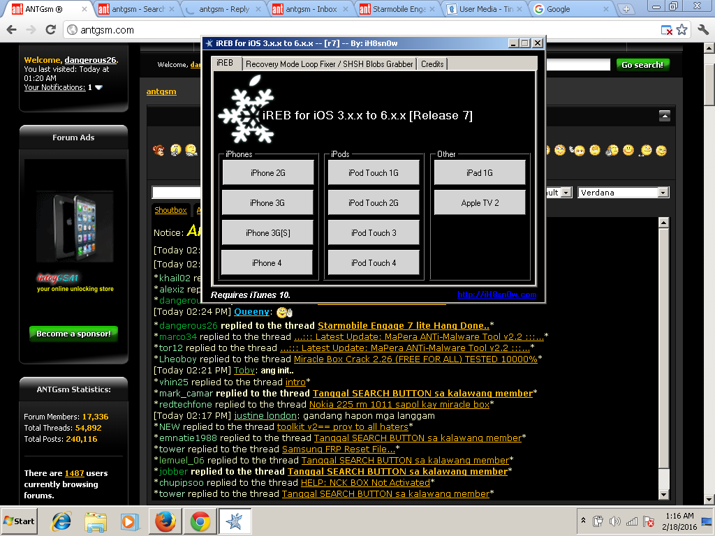

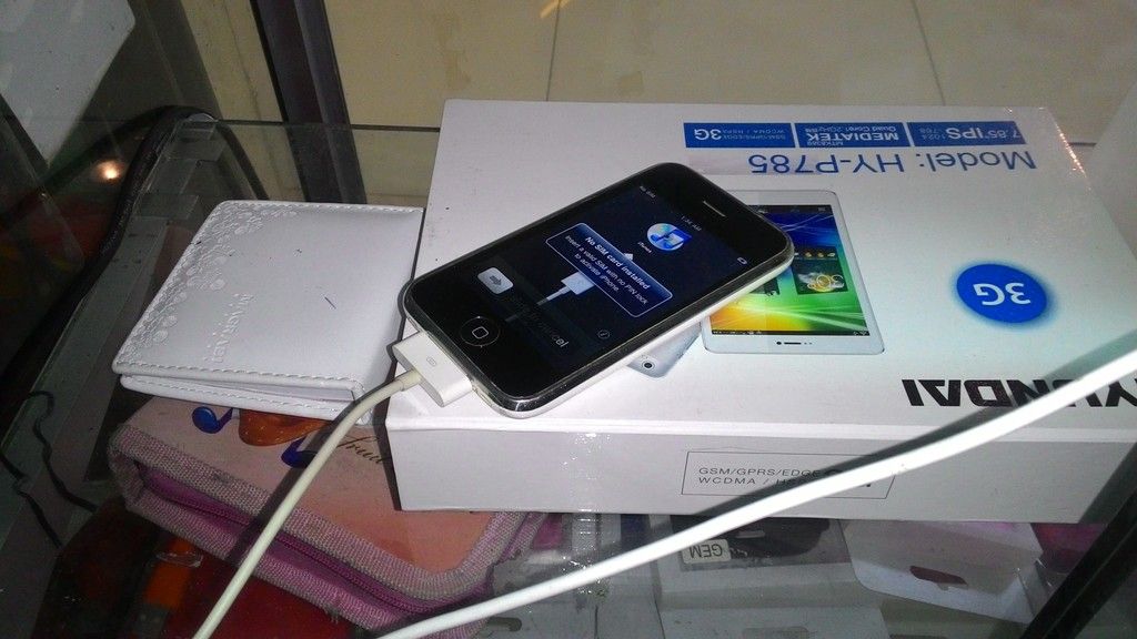

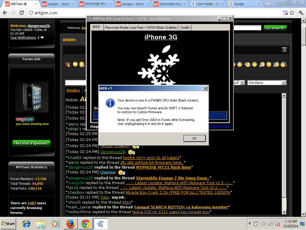

first open ireb

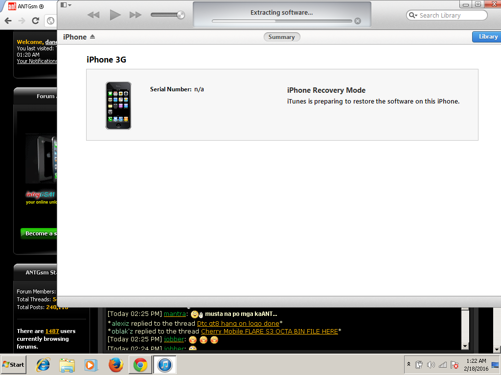

and click iphone 3g and follow instruction for dfu mode saksak iphone sa computer
and click ok

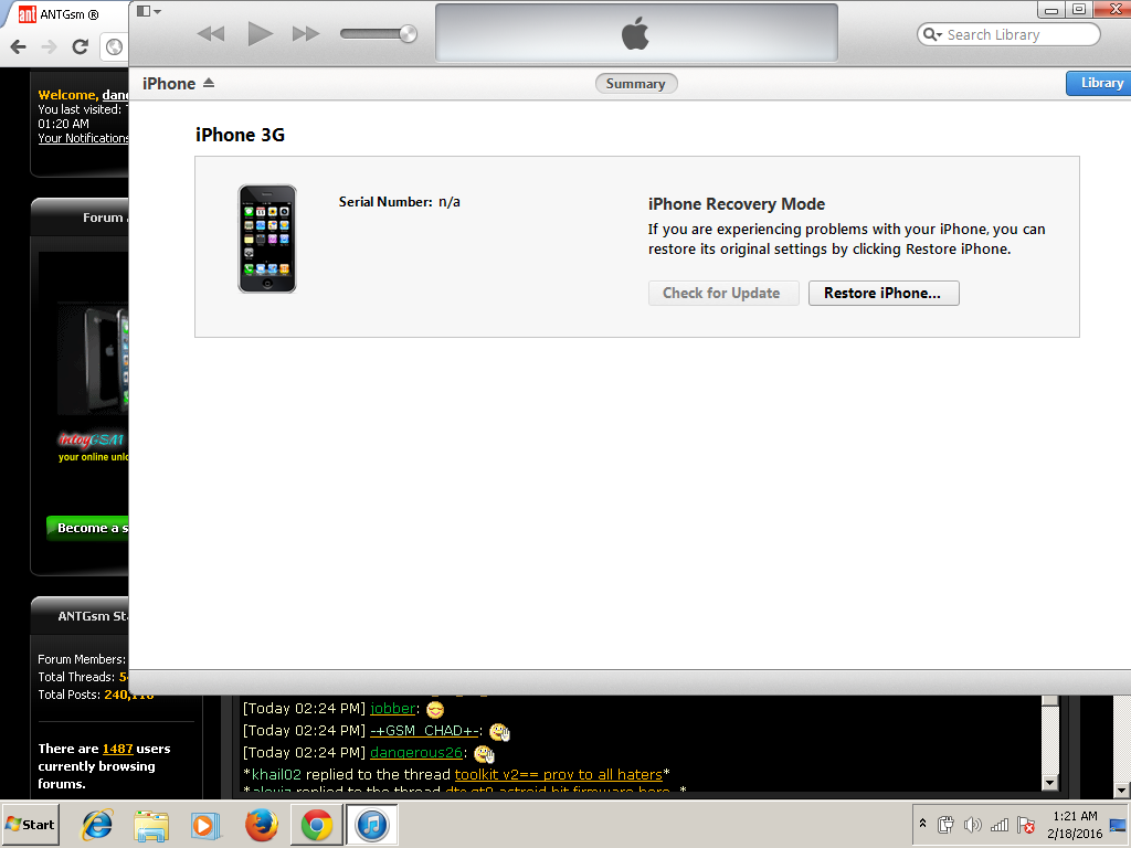

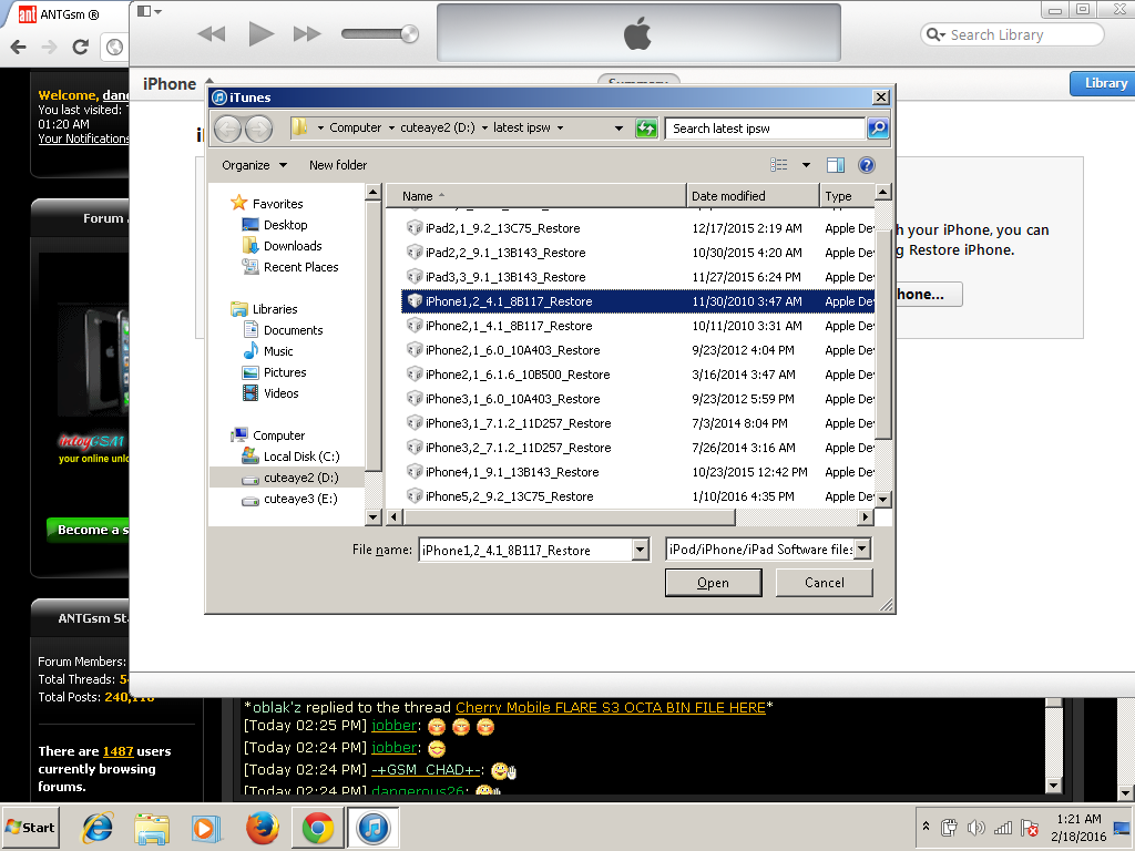

open itunes
hold shift and click restore then select the ipsw for iphone 3g
click ok and wait matapos restore

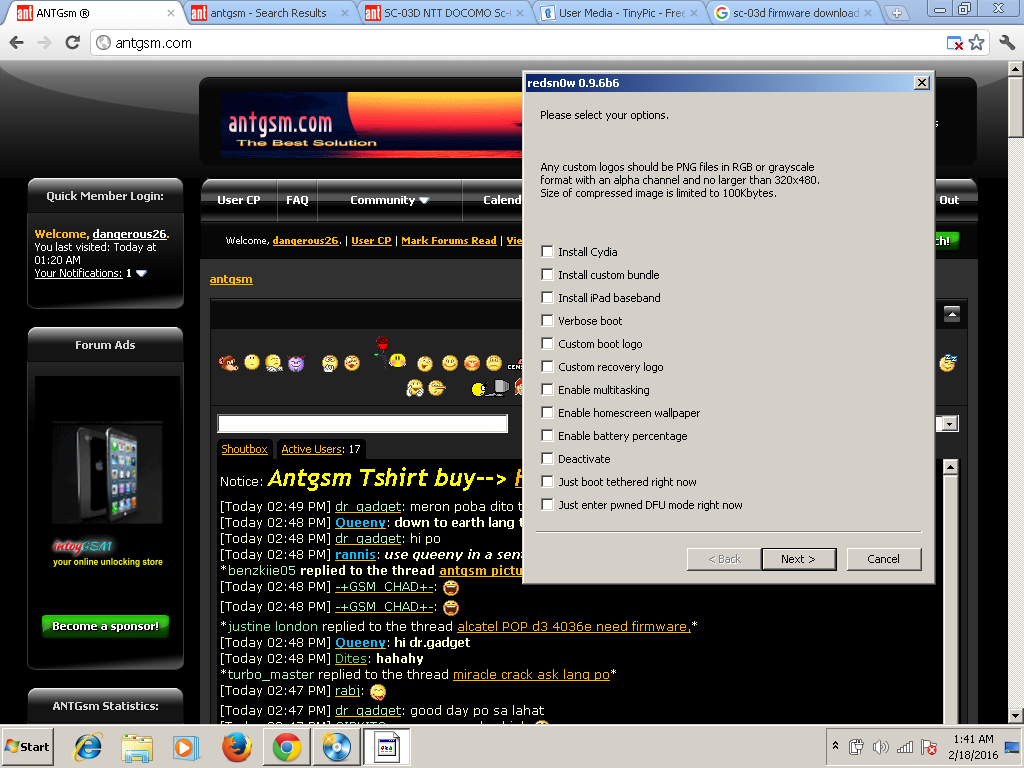

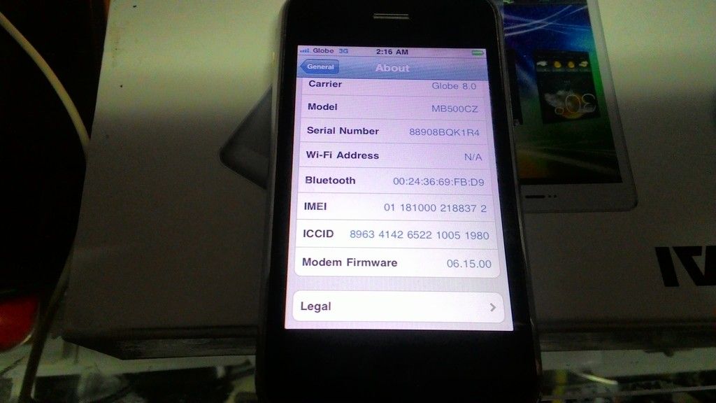

after matapos openline naman naten we need to flash baseband to 6.15

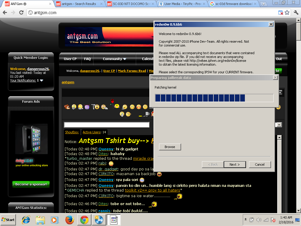

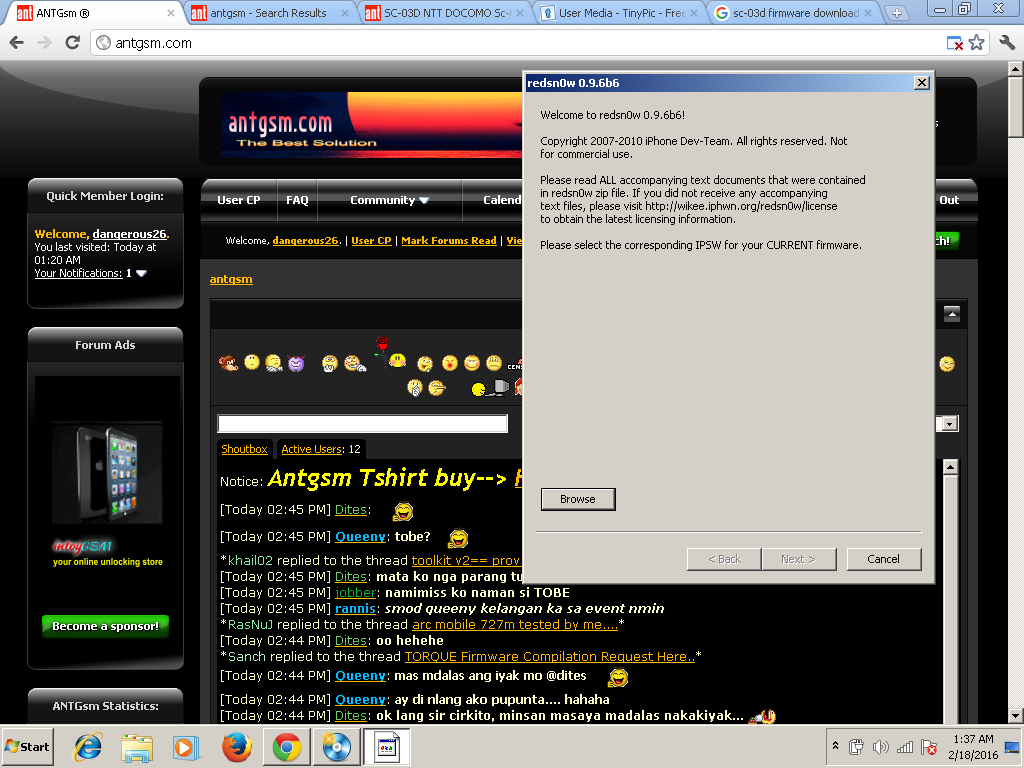

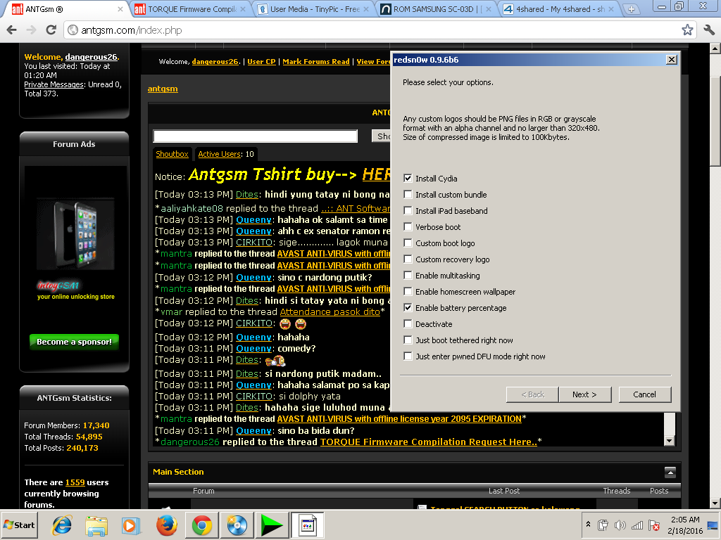

open redsnow
click browse then select ipsw na ginamit mo pang restore and click next

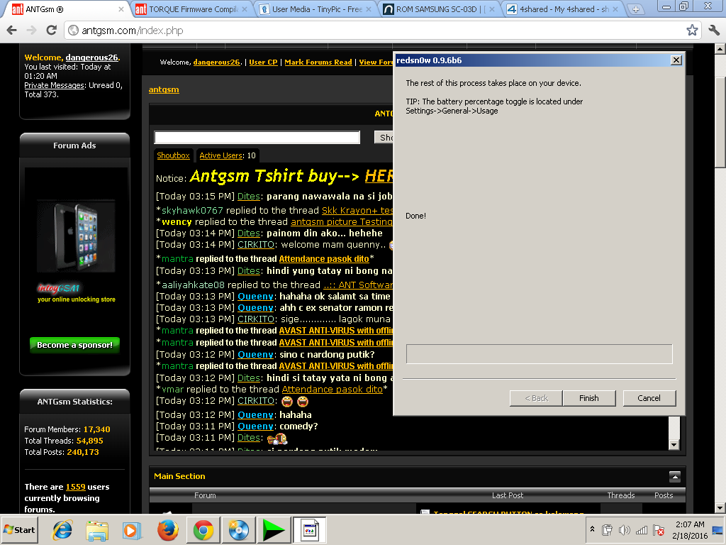

click install ipad baseband only and click next
click yes
click next

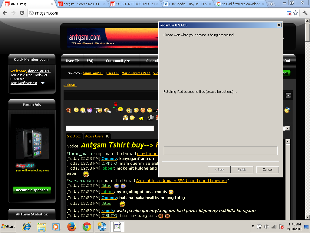

wait matapos fetching baseband
wala sya cydia jailbreak naman naten

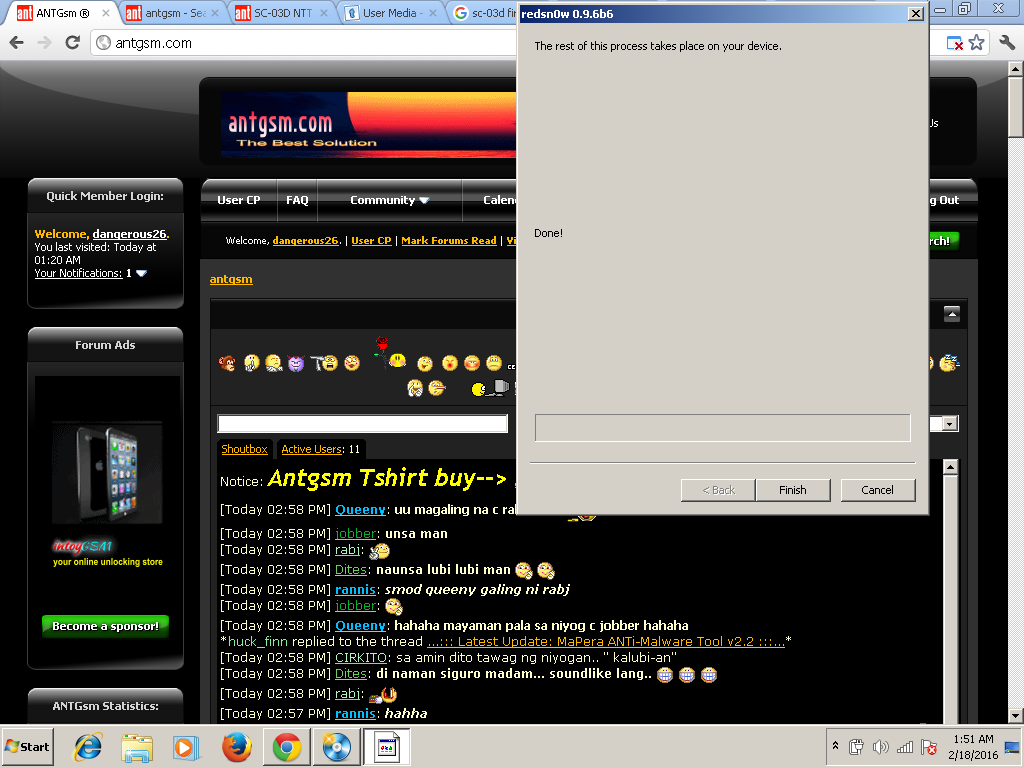

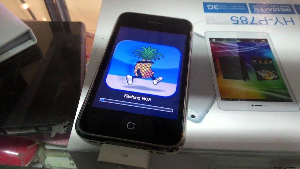

open ulit red snow at selct ulit firmware then next ulit
ang kina ibahan lang hindi na install ipad baseband ang seselect naten eto na

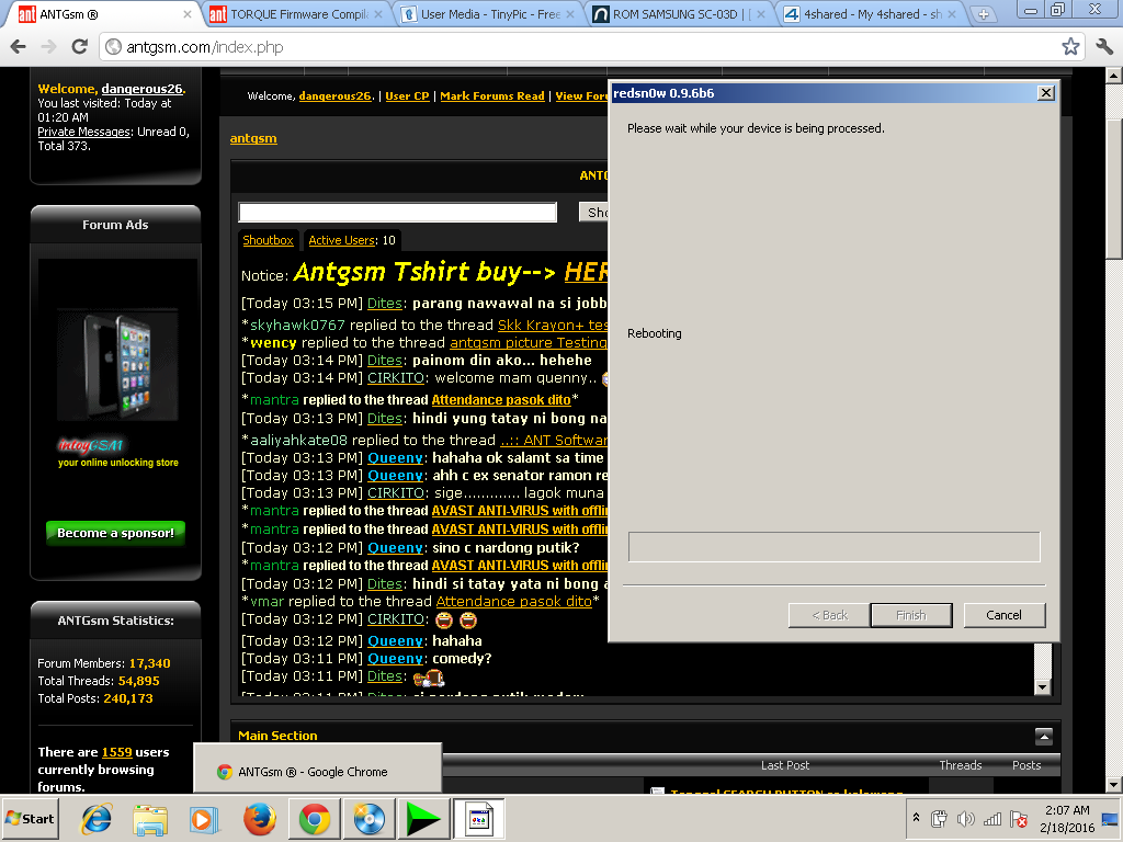

click next then wait naten matapos

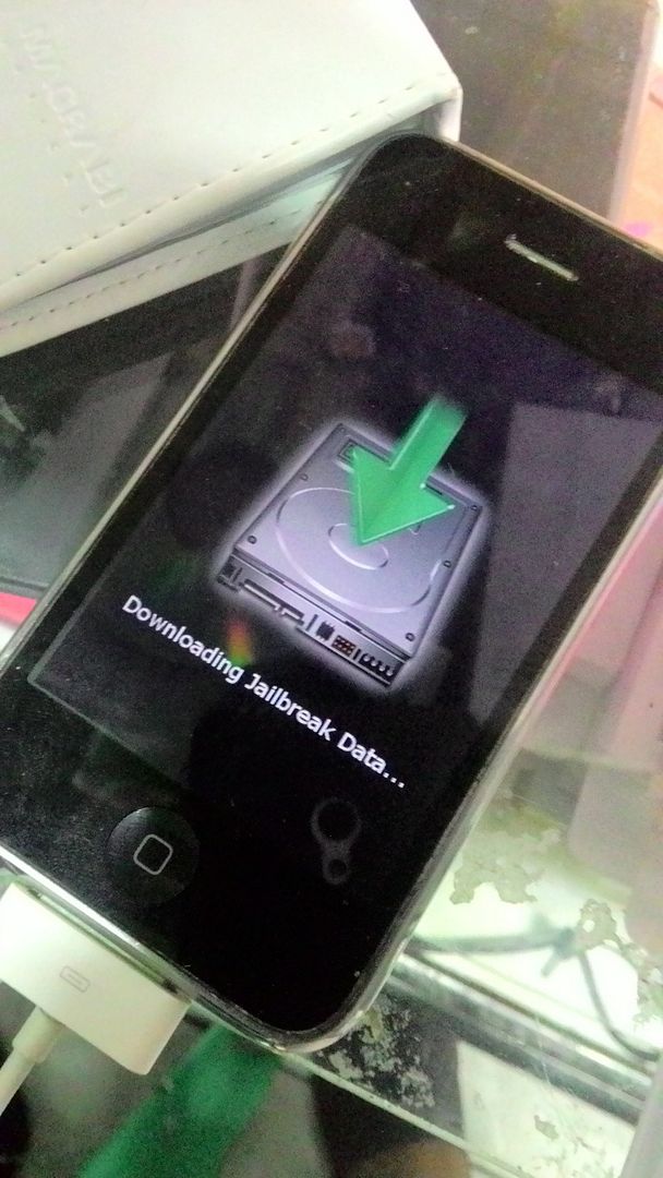

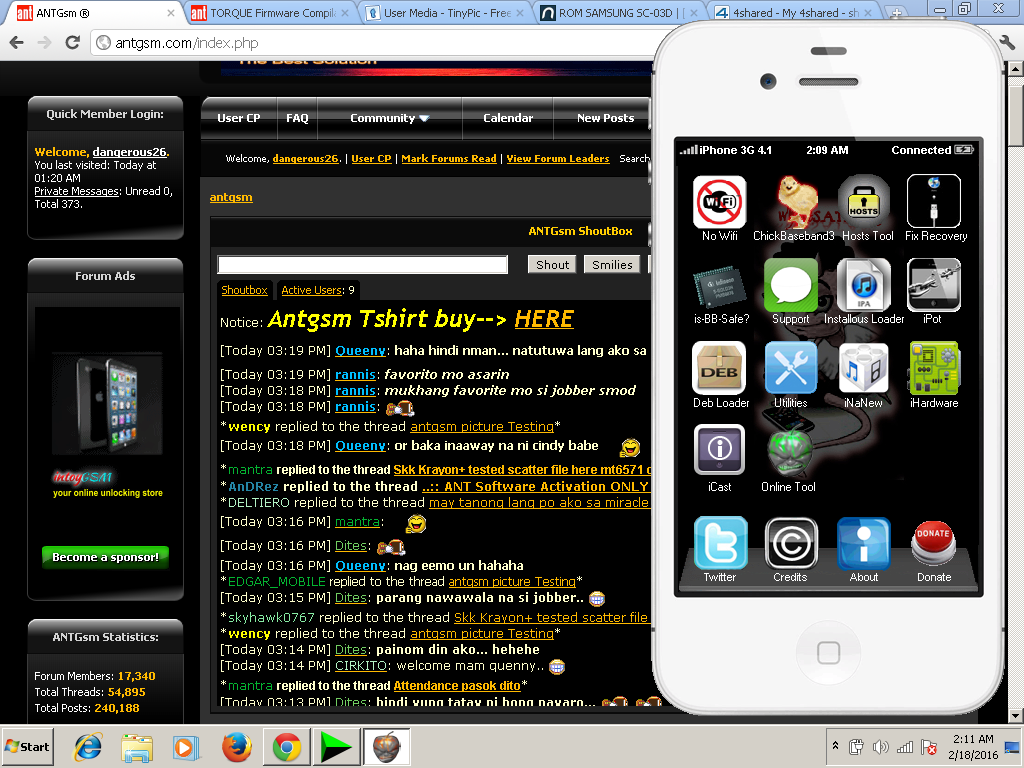

open iphoneyeta
click ultrasnow 1.2.8

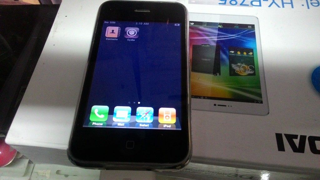

then reboot the iphone twice
DONE for reference only
