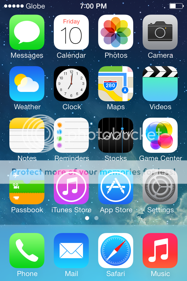

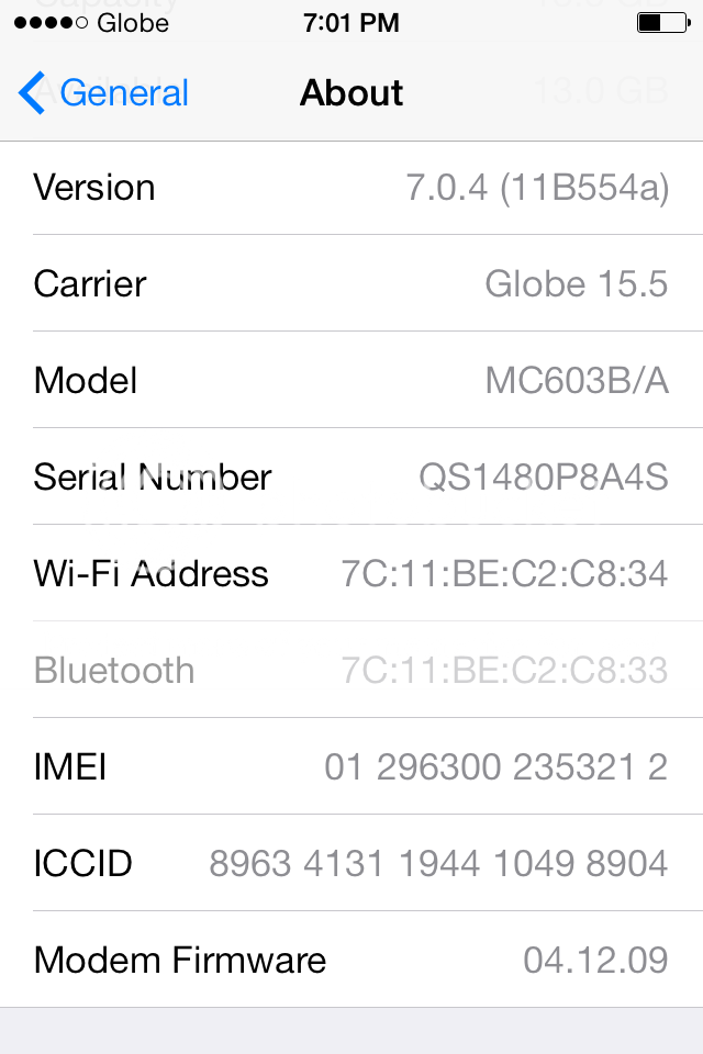

IPHONE 4 searching and restore to itunes ang lumalabas sa screen
1st step---restore to itunes to latest version,but it gives ERROR 2
2nd step---restore again in defferent computer with defferent cables but it dsame error...kaya naisip ko hardware nato cgurado....
3rd n last step---dismantle unit, mild reheat motherboard and restore without casing,camera,lcd,touchscreen all connected to board pwera lng po sa batt ang duck cable...kayo nalang po bahala kung pano mo cya e dfu mode....
