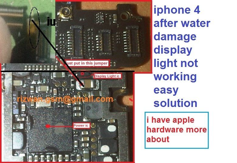

hanap ibang solution at ito po solution na nakita ko.

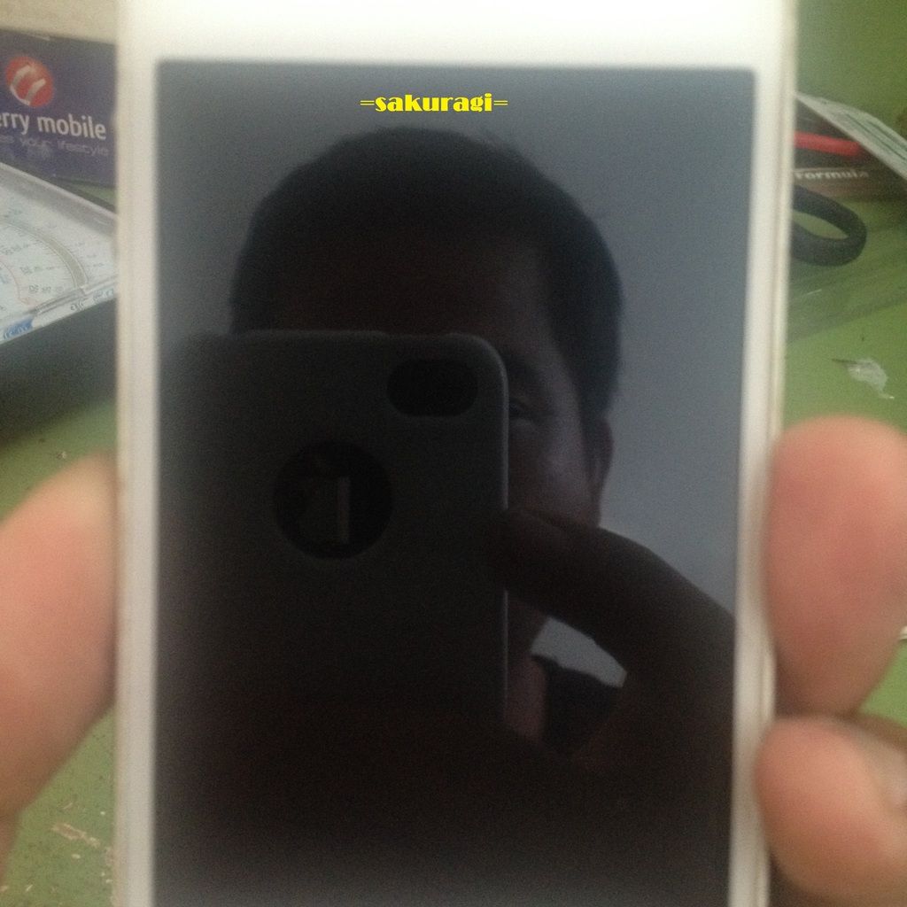

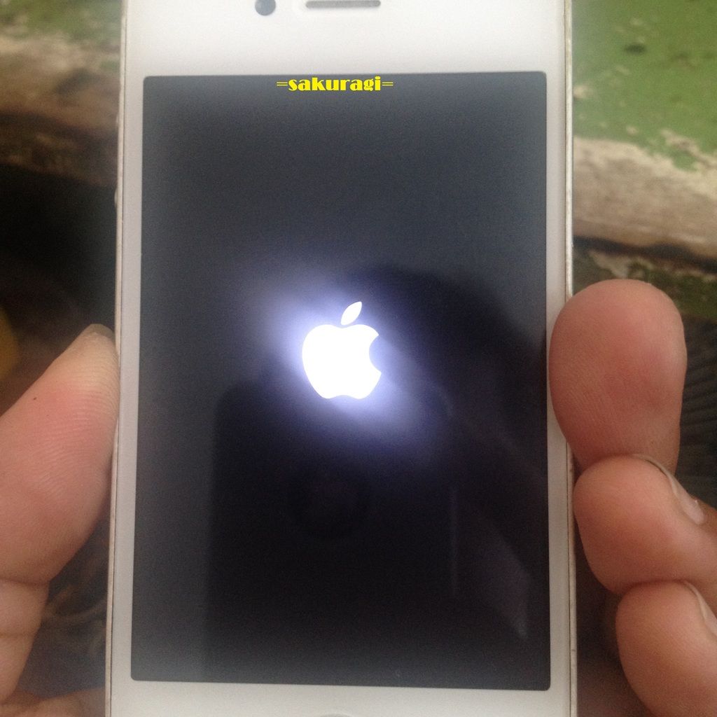

unit before magopen ang light
after 5-10 seconds ito na

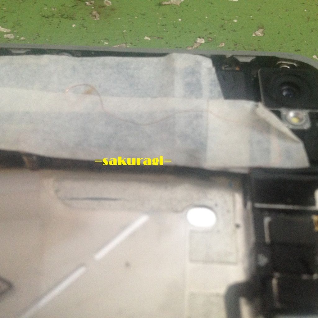

kaya ito na po ginawa ko my own idea
kasi mahirap at masikip magjumper sa connector
kaya ito po ginawa ko

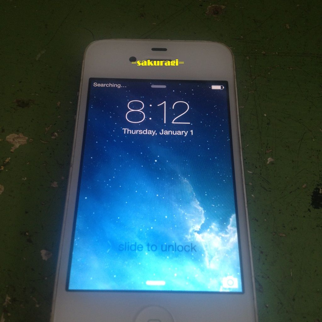

after ko maiayos ang jumper at maassemble ito po result
Hope i like it!
Hope i like it!
)thanks for viewing...
