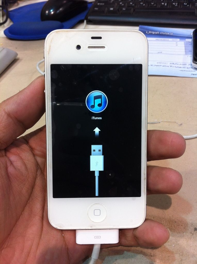

model : iPhone 4G
history : gusto i pa update sa 6.0

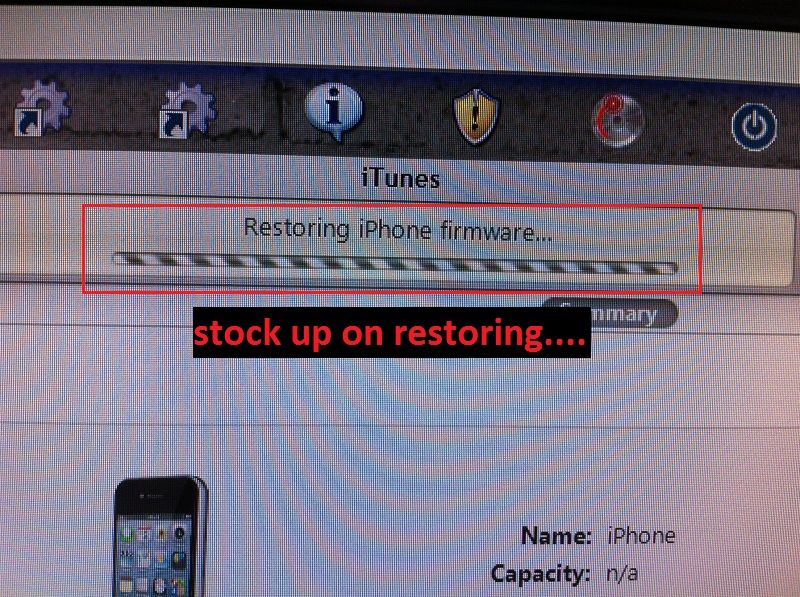

problem : stock on restoring pag disconnect mo usb "ERROR 9"

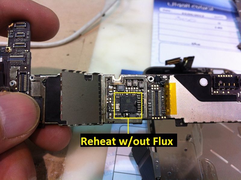

action taken : npka simple mild reheat lang po ang pm ic:)
action no luck :
*try another battery
*try another pc
*try another charging pin
SCREENSHOT

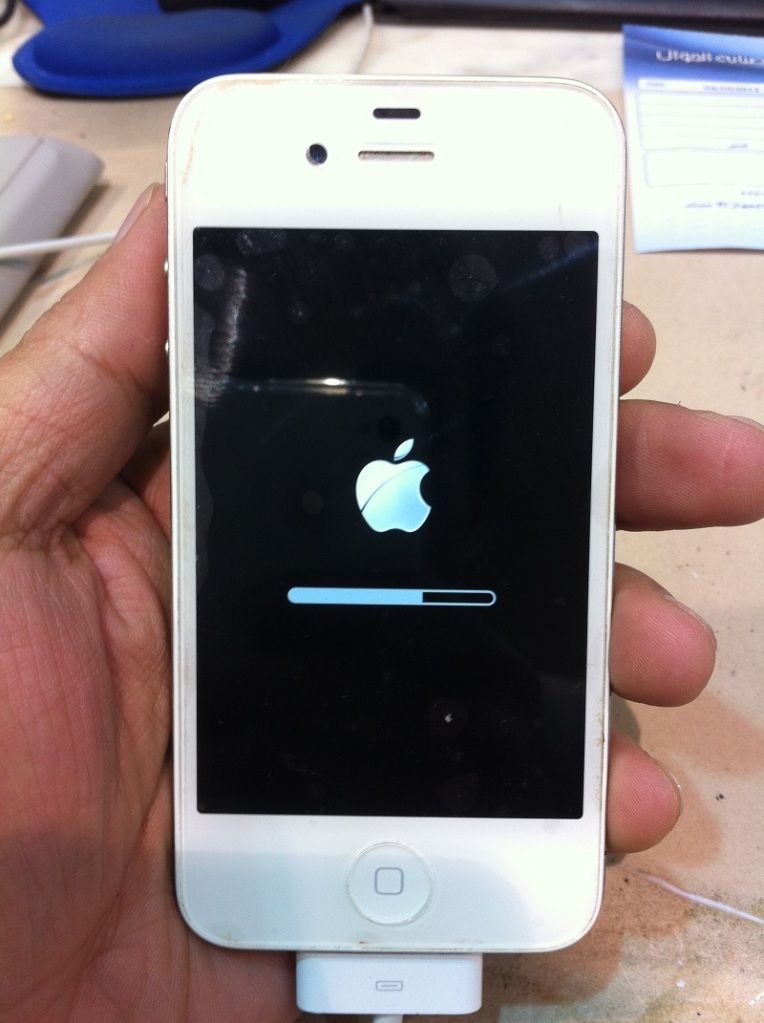

after restore on 6.0 stock on restoring kaya putol ang restore ito kinalabasan=))

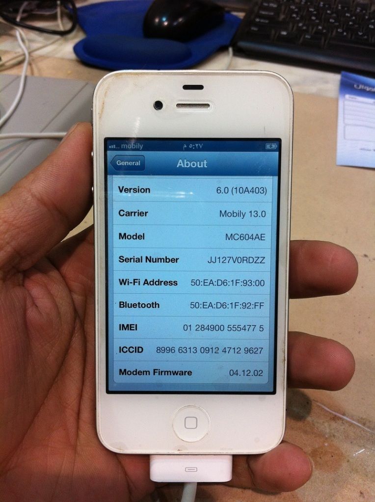

after mild reheat pm ic w/out flux po yan remember:)

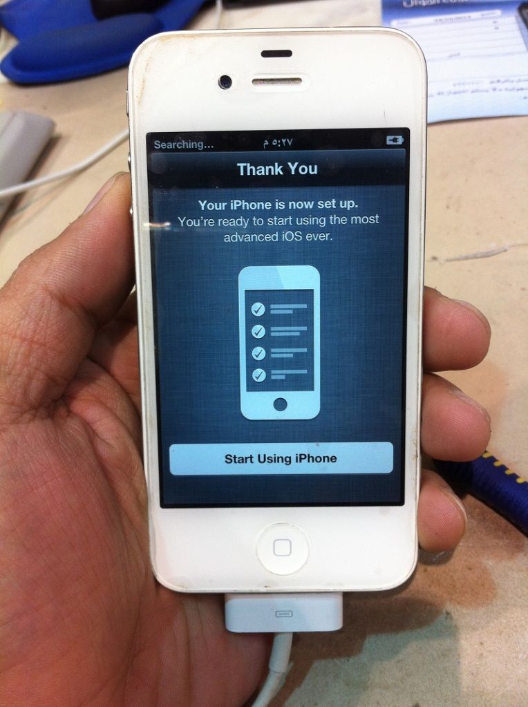

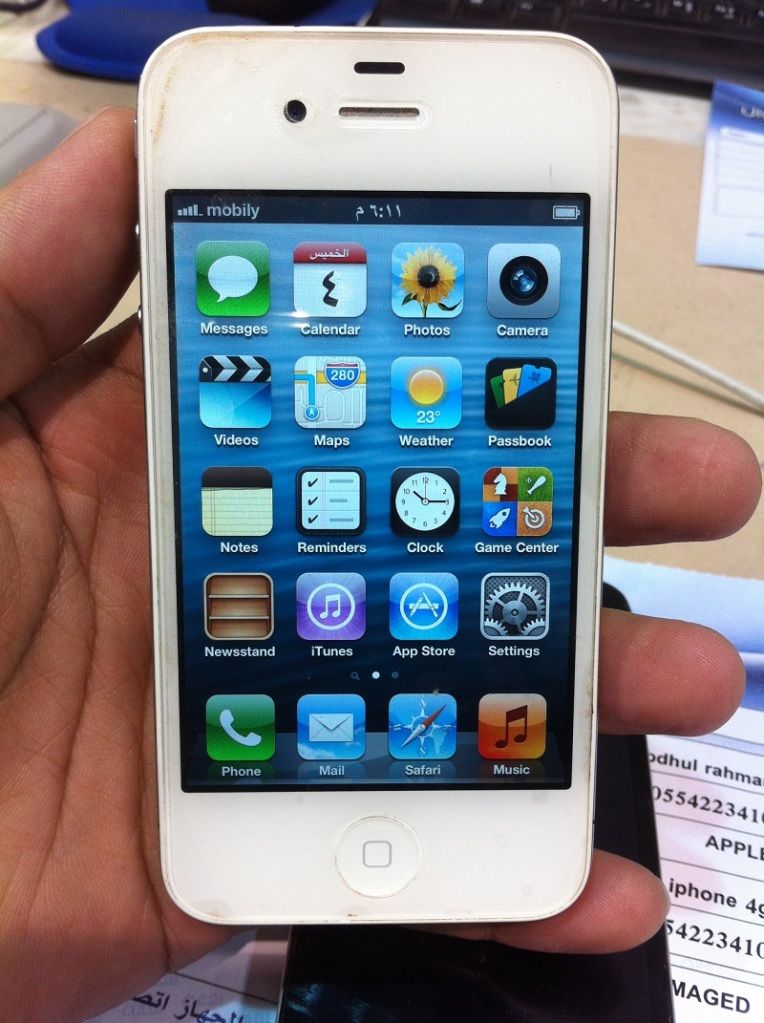

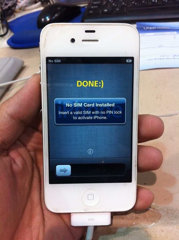

restore ko ulet ito na:D
napka simple lang po yan walagn kahirap hirap pero ingat sa pag reheat sa pm ic baka masobrahan boom reballs ang aabutin mo=))
