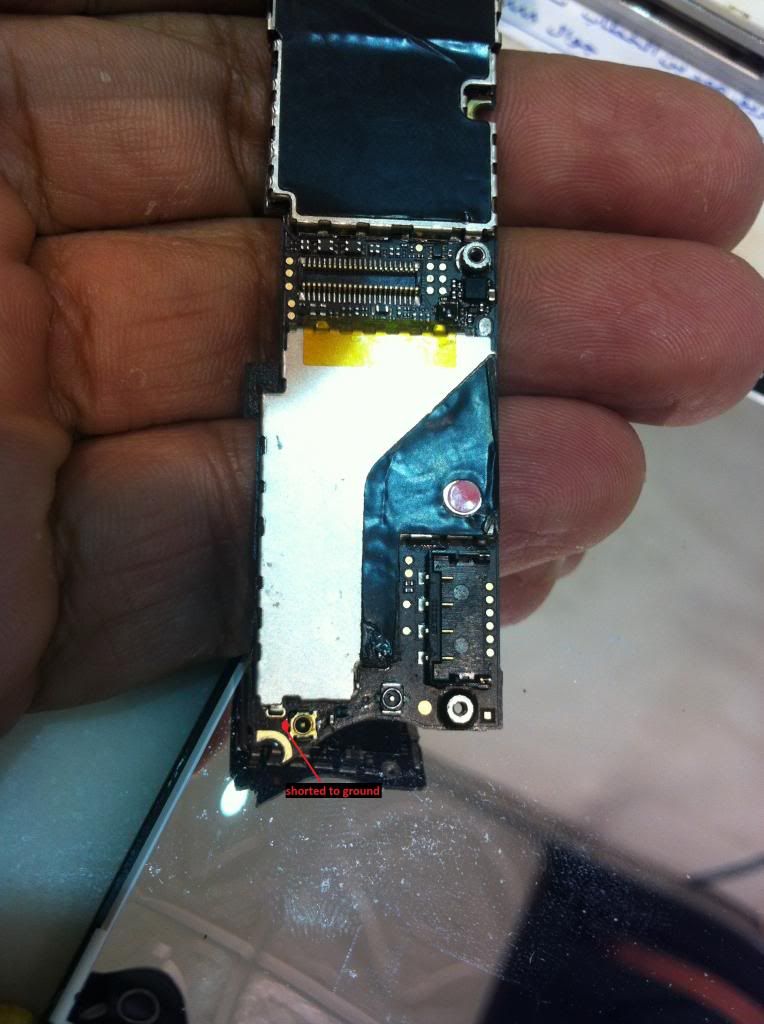

share ko lang po itong kuting reference ng iphone 4g nwawala wala ang signal tapos minsan kahit may signal ndi rin mka tawag dahil sa shorted ang antina sa ground.
model : iPhone 4G
problem : weak signal or abnormally

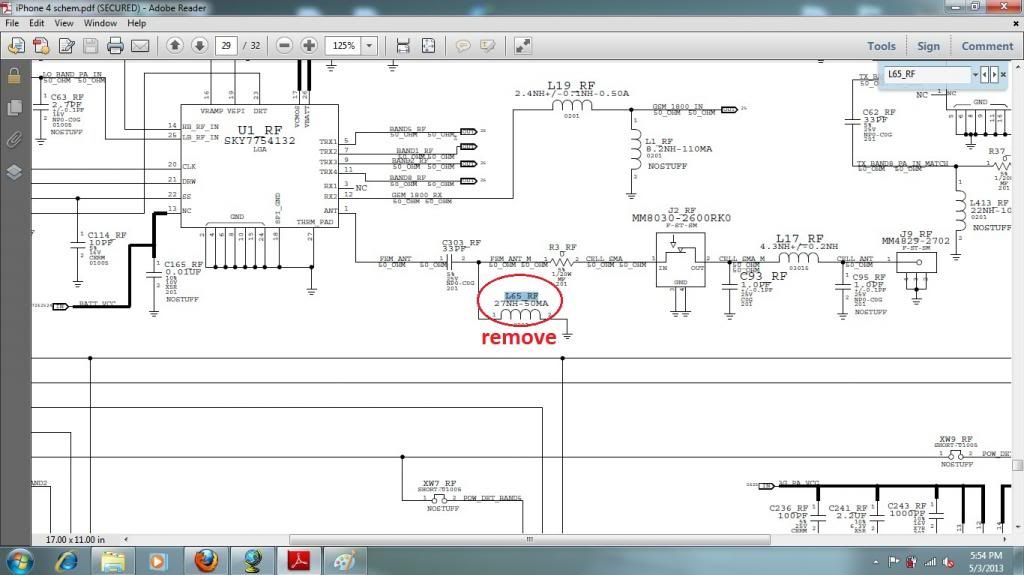

history : bigla lang daw pero natanggap ko may repair na at nka jumper na yung coil na maliit sa antena connector

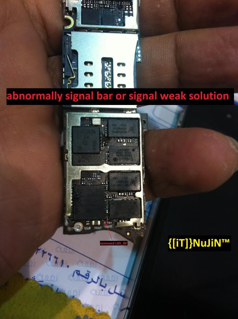

action taken : remove L65_RF done:)
SCREENSHOT
(DAPAT HINDI SHORTED YAN SA GROUND)
