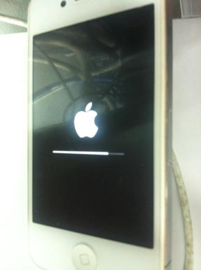

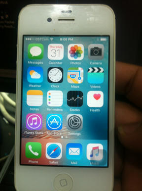

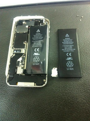

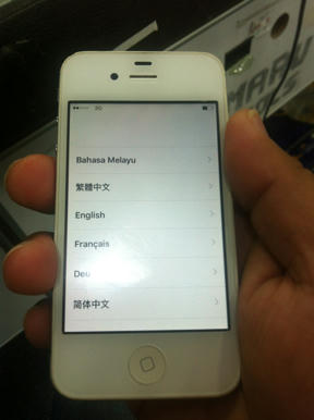

Marv Registered Joined Nov 11, 2014 Messages 747 Reaction score 115 Points 81 Location gadong bandar seri begawan brunei/ cabanatuan city May 31, 2018 #1 mga bossing share ko lang try ko flash yung iphone 4s laging error 29.. kapag 80% ang nakaindicate sa 3utools saka nageerror 29.. kaya search ako solution kita ko palit daw battery.. di naman ako nabigo... balik ko ang battery ng customer finish product done...
