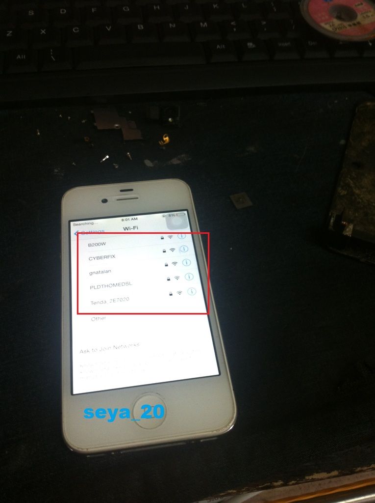

Problem

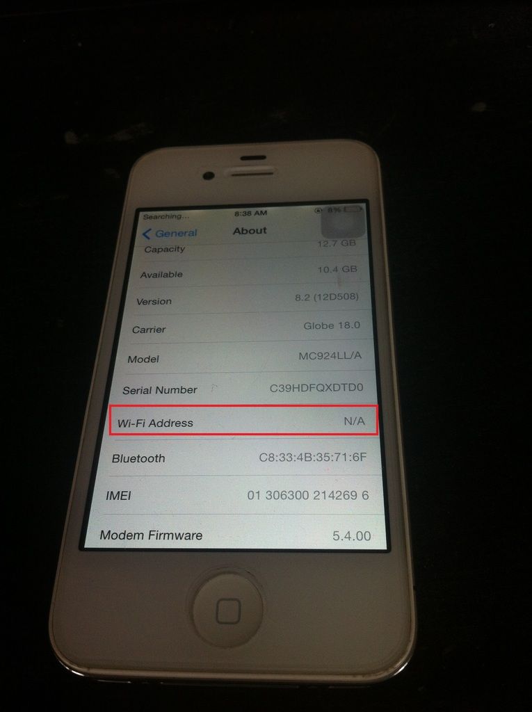

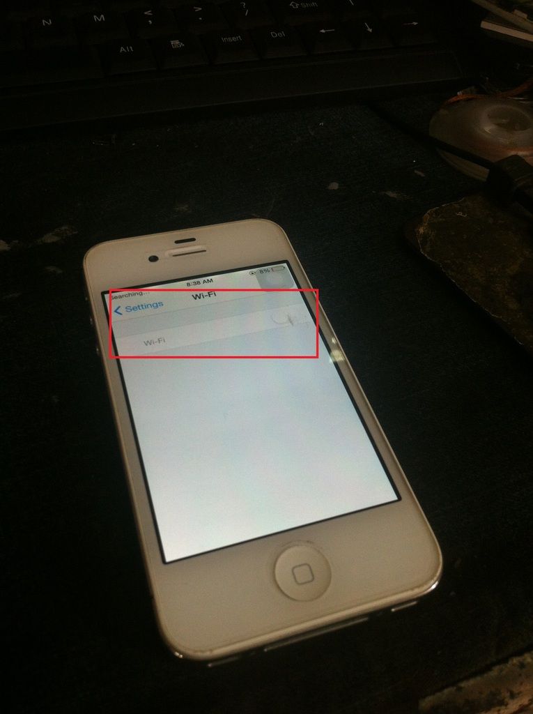

Grayed wifi
History
bigla nalang daw nag gray out ung wifi nag try daw sya gawin sinunod ung
sa youtube ngunit bigo ;))

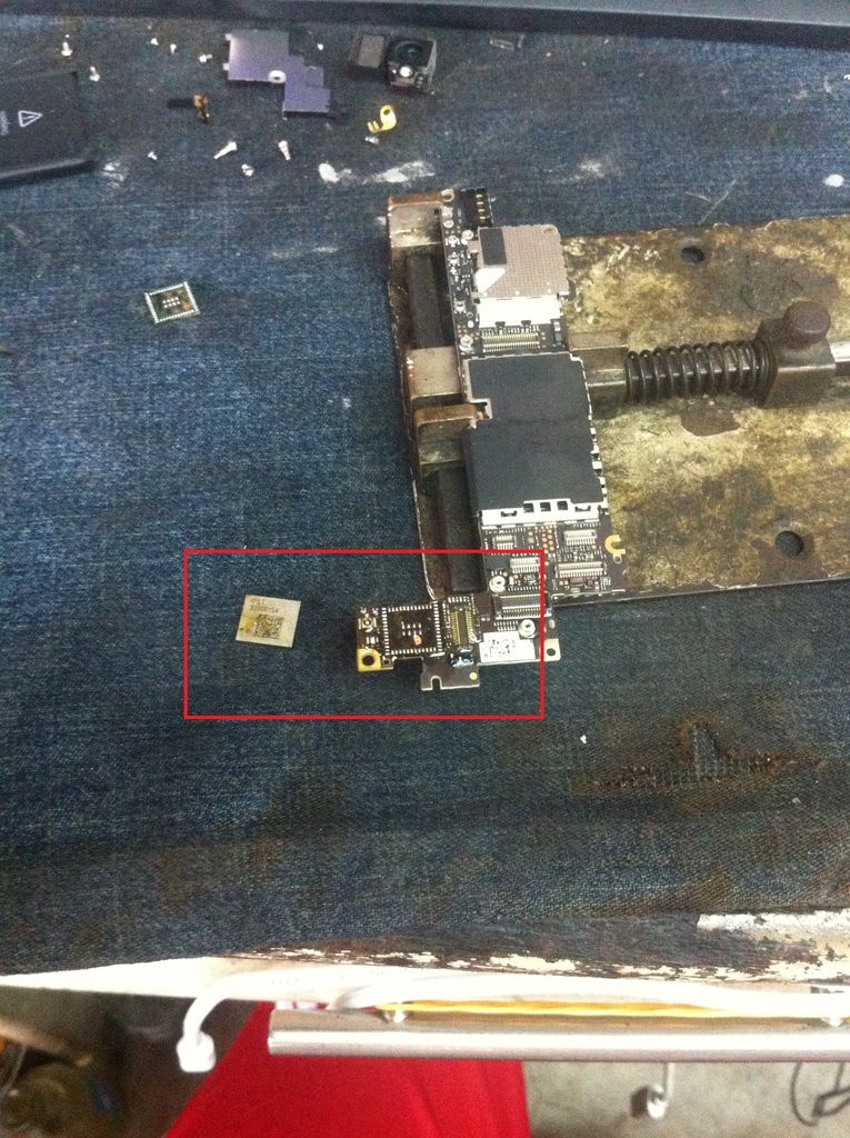

Action Taken
mild reheat wifi i.c no luck
apply jumper search sa google no luck parin

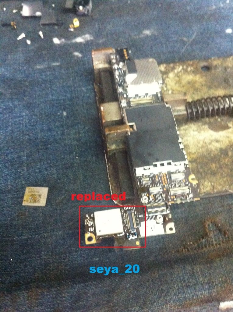

so proceed sa replacement wifi i.c
kumuha nalang ako sa 4s na board

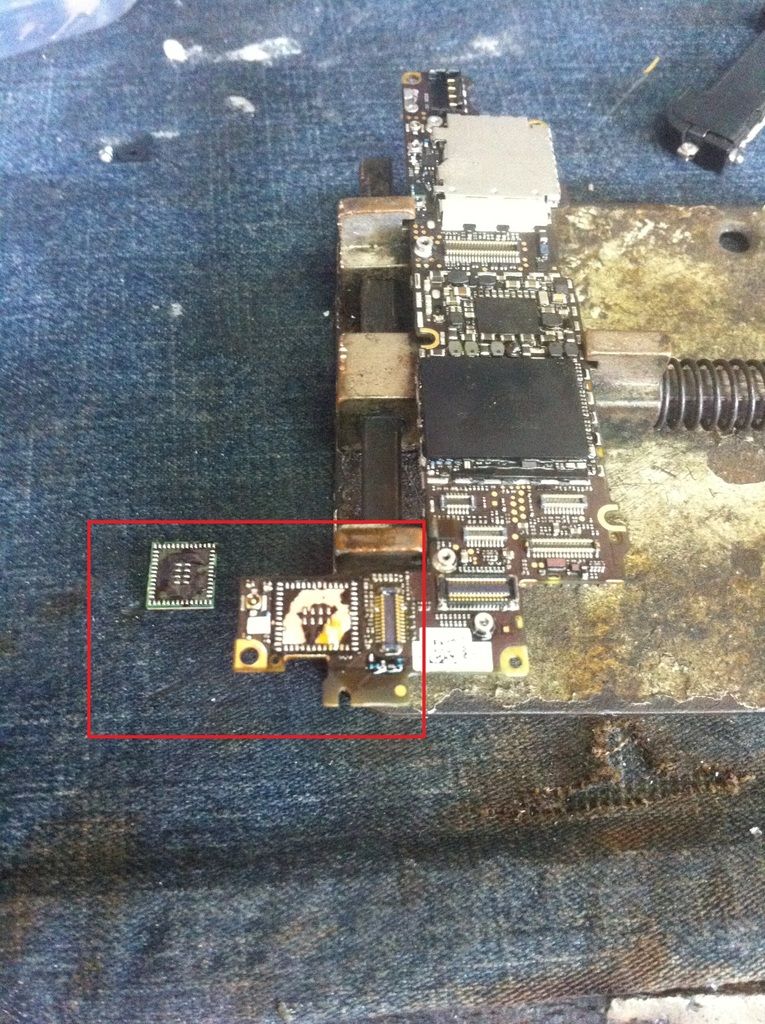

Kuha muna sa defective board

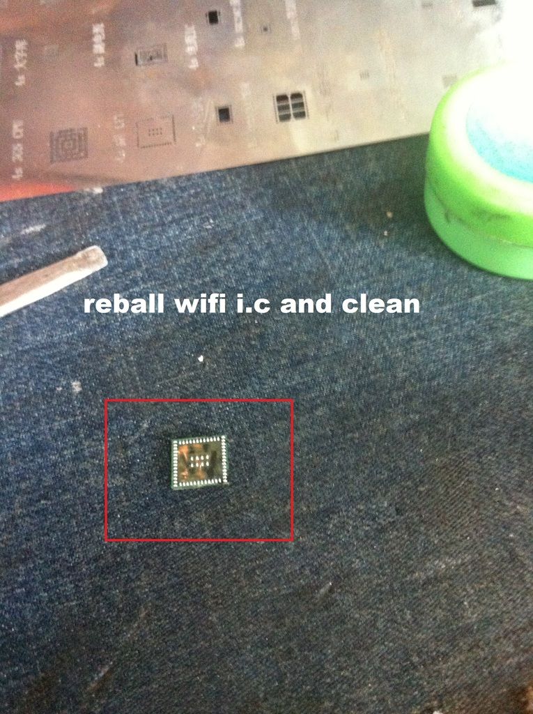

then reball the wifi i.c
Proceed on replacing wifi i.c

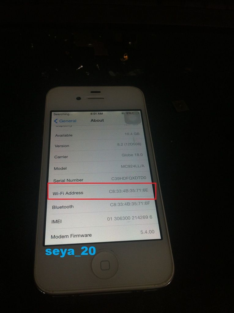

Done..
For Reference..
