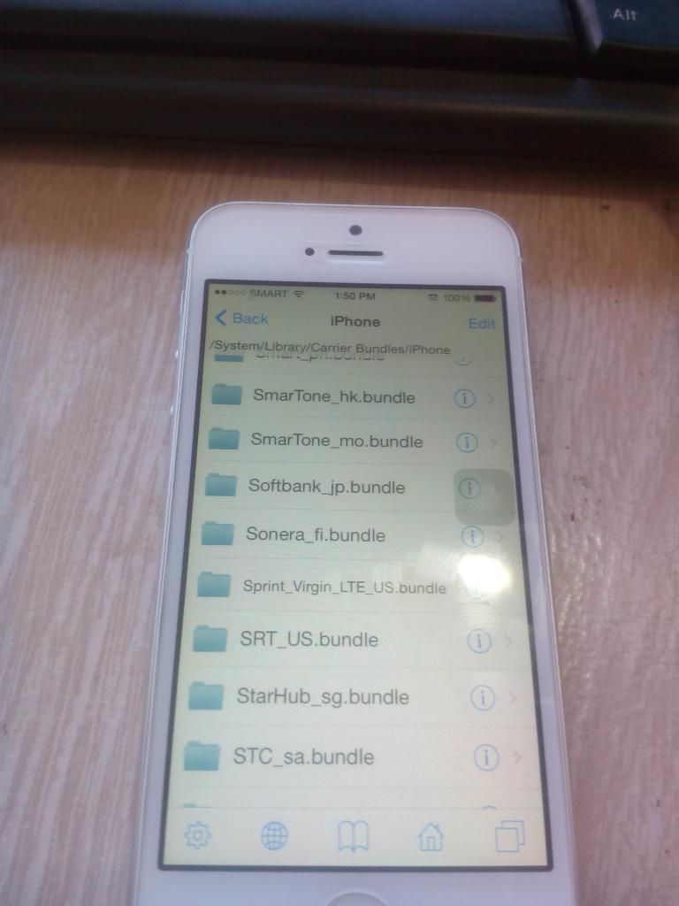

iphone5 sprint ios 8.1 unlock by using rsim9 ..problem sms not send
procedure
1 jailbreak your idevice
2 then install afc2ad
3 then install ifile
4 open ifile
5 goto var mobile library carier.bundle.bundle tapos makikita nyo KDDI_LTE_jp.bundle
then move to file to trash then reboot 2 times done

ito po finish product

same ang ginawa ko niyan boss na delet kona ang kddi pero after a days din na naman mka send,my
ibang solution po ba nito?
unG SAKIN KC sir kddi after ilang days bumabalik din s dati.. hindi ulit mka send.
