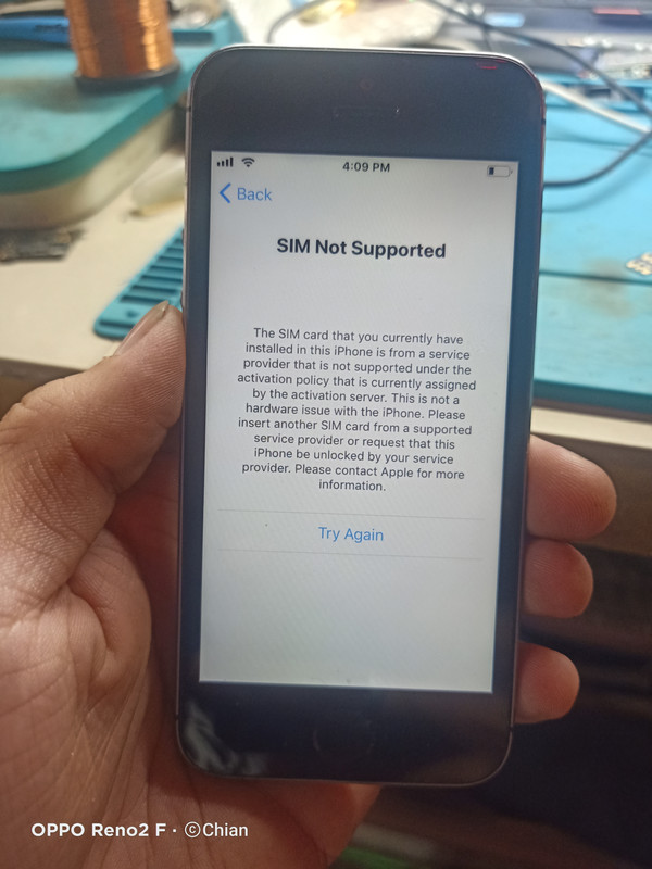

Good day po sa inyong lahat. Today may tanggap po akong unit iphone 5s (Sim Activation Lock) status.

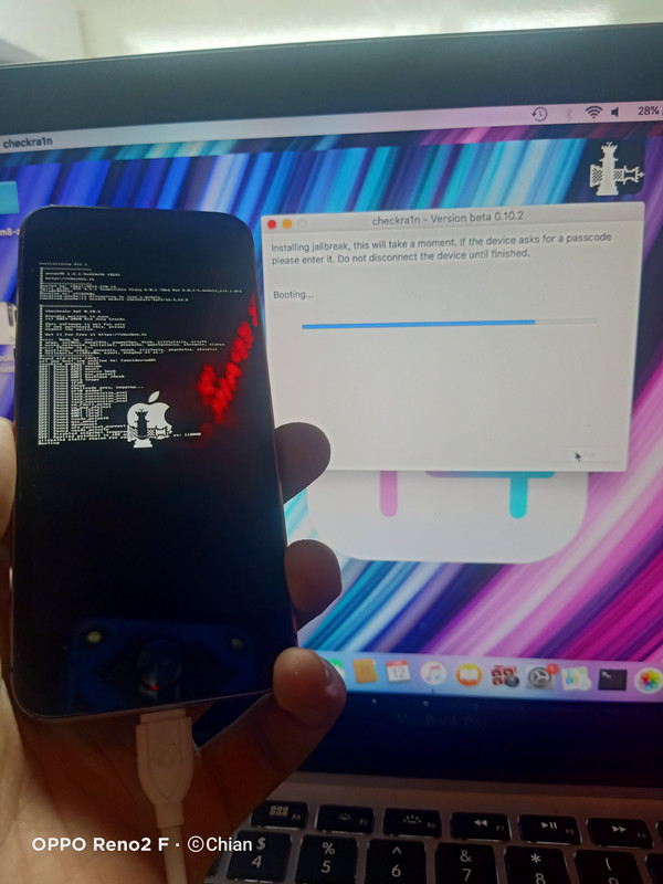

Jailbreak first unit using checkrain v 0.10.2

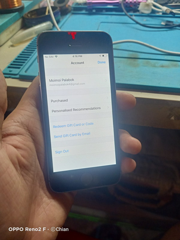

After jailbreak go to appstore and sign in you personal account

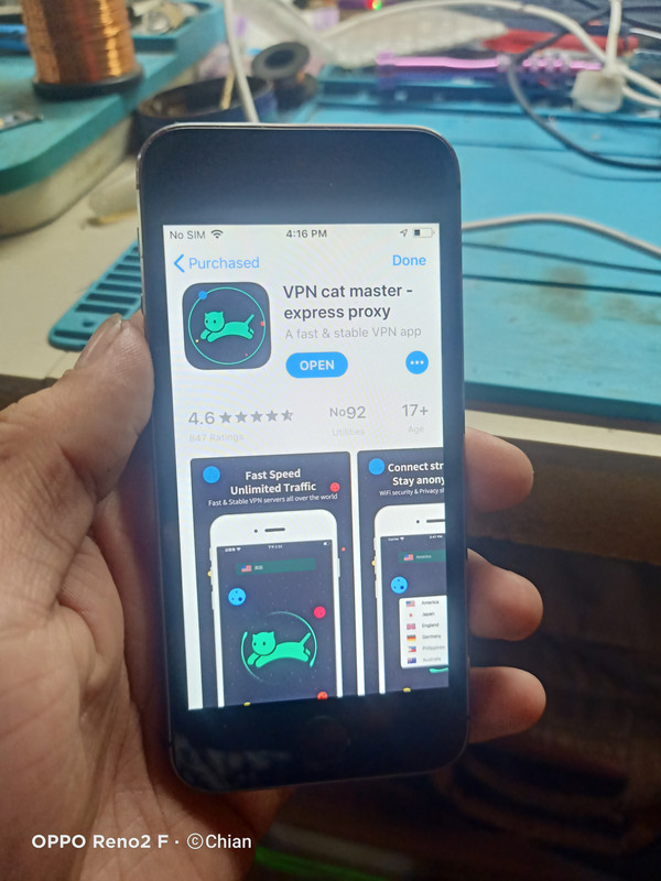

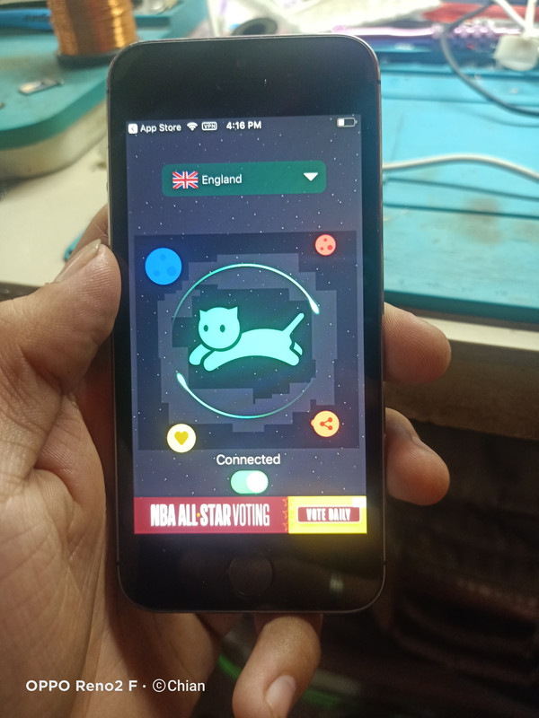

Pagtapos po ma sign in download vpn cat master express proxy
After ma download open vpn cat master then choose 'ENGLAND' server and connect.

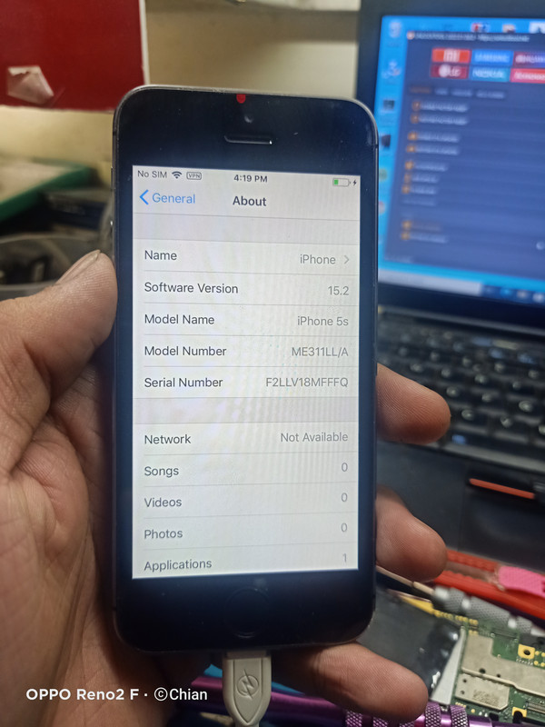

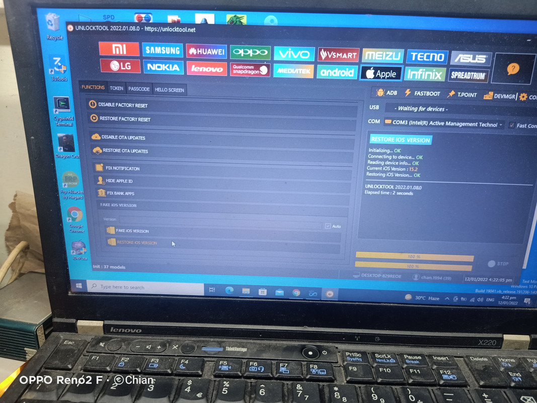

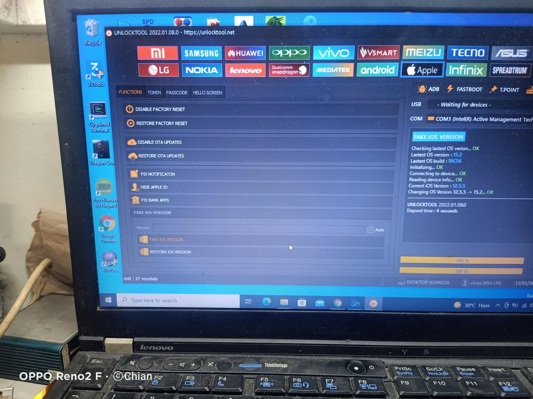

After niyan connect phone into pc and open unlocktool. Select brand 'Apple' next click Functions and click 'FAKE iOS VERSION
After niyan heto magiging result sa settings.

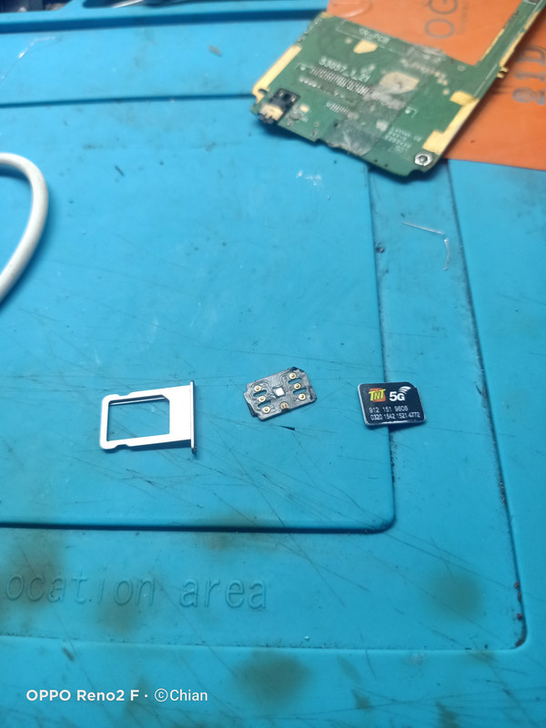

Pagtapos niyan ay isaksak ang gpp at regular sim

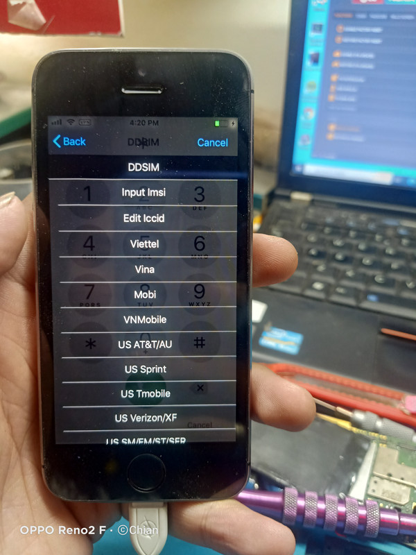

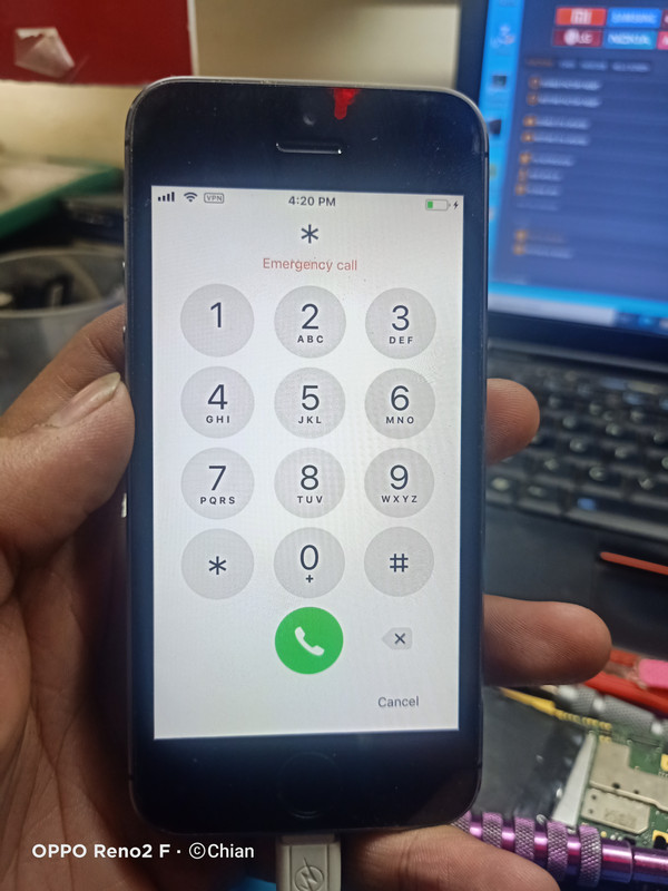

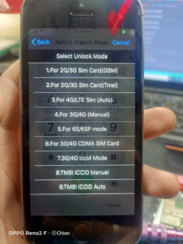

Pagsasak niyan ay mapupunta sa activation lock click 'Home Button' and click 'Emergency call' at pindutin ang askterisk (*) at call

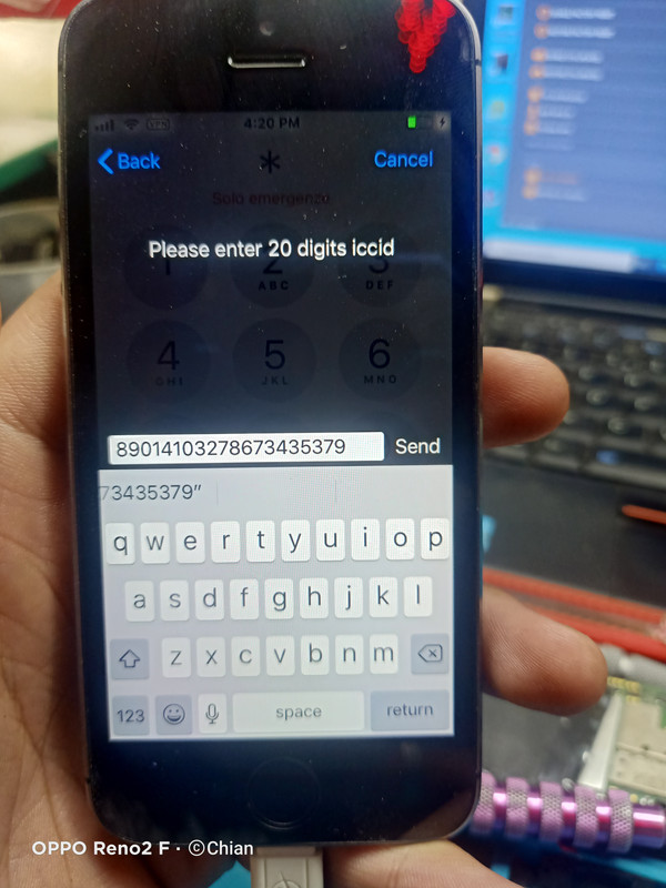

Now click edit iccid and put this ICCID 89014103278673435379
Next click iccid mode
<a href='https://postimg.cc/n9HC13Cs' target='_blank'><img src='https://i.postimg.cc/vTnfbjyv/IMG20220112162039.jpg' border='0' alt='IMG20220112162039'/></a><br /><a href='https://banks-nearme.com/bank-of-the-west-near-me'>bank of the west near me</a><br />

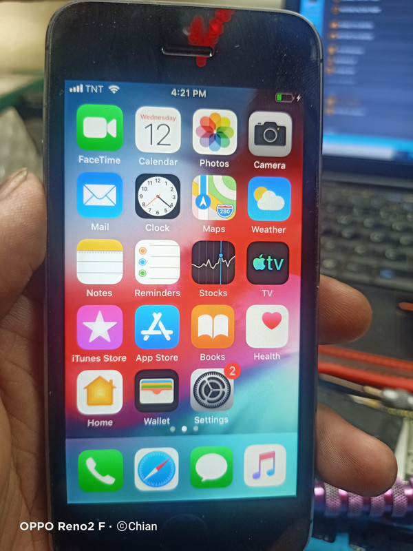

Wait for activation
Now open ulit unlocktool para madowngrade ulit.
Open unlock tool select brand 'Apple' and click Functions and next click 'RESTOTE ios VERSION

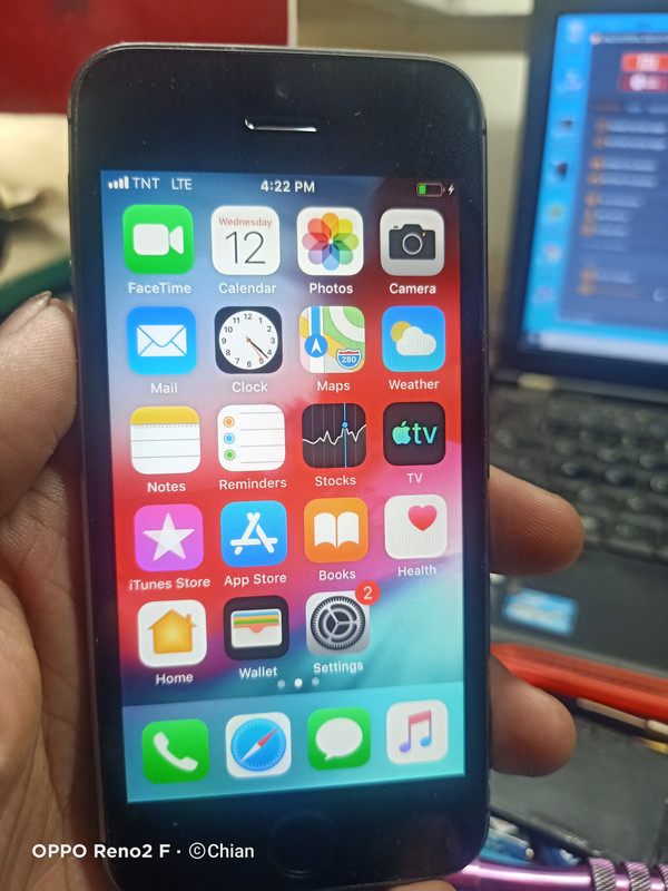

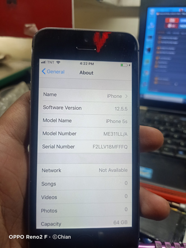

At heto na po settings ko
At heto naman po ang proof ko
