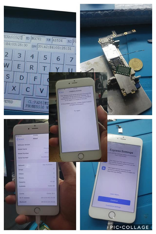

just wanna share iphone 6+ activation error after ios update due to wrong info.. like s/n , wifi add, bluetooth add..
action taken:
-contact ur trusted online source for iphone info (paid service)
-remove nand ic and re-write your new info (s/n, wifi, bluetooth add) i used navi plus..
-put back nand ic
-restore
