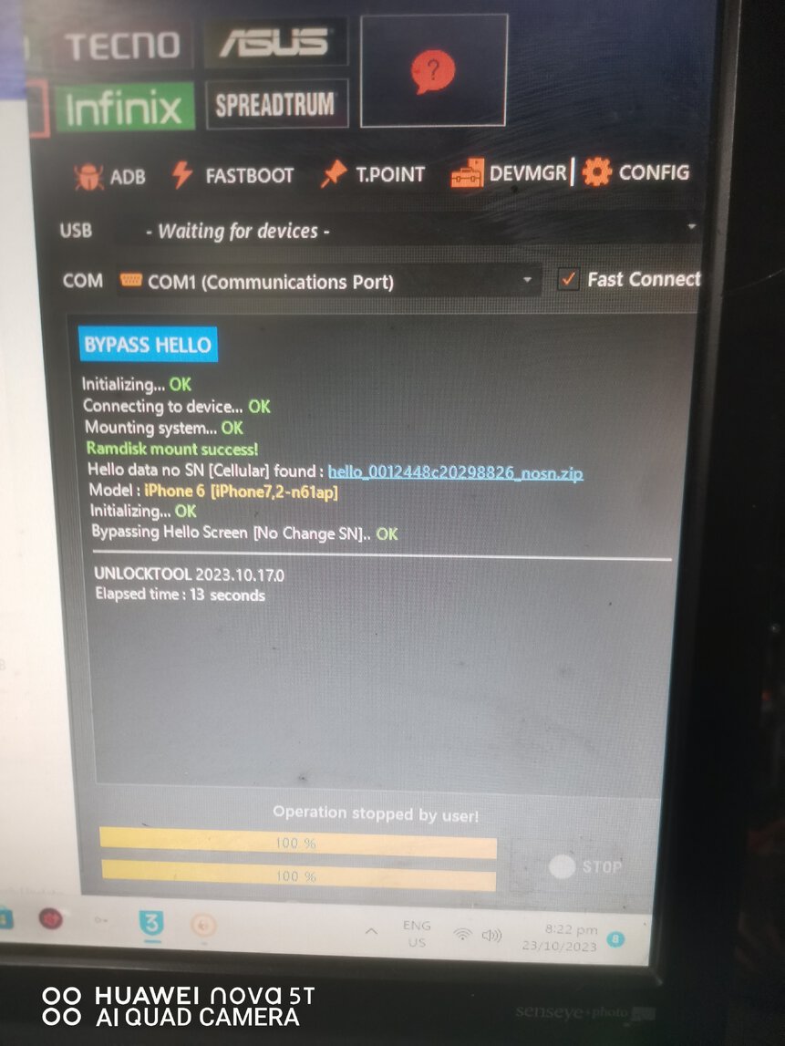

Retain user reflash na sa 3u tools.
Then open unlock tool.
Get acivation no change sn
Then pwndfu gaster
Then bypass hello.

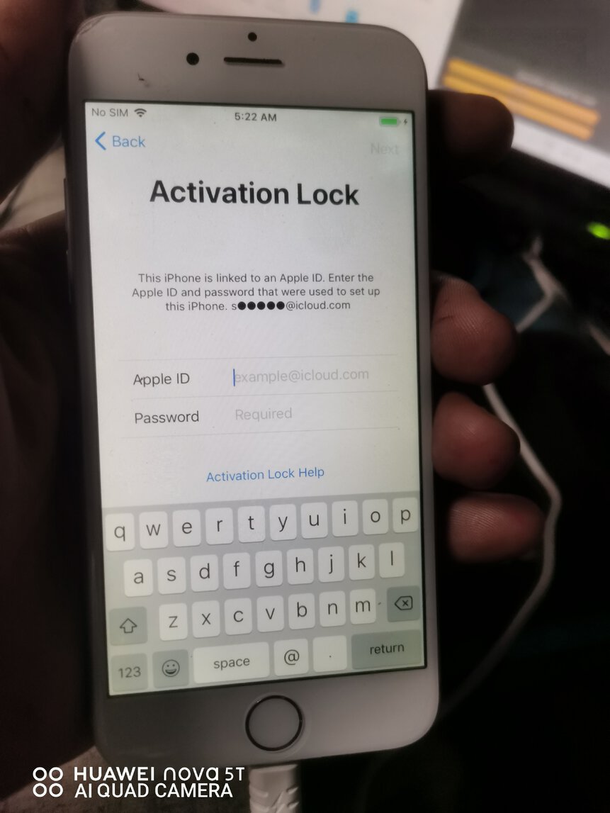

Afer magboot mag open menu saglit lang then babalik ulit sa activation..
Patulong po mga master paanu bypass to. nag try ako jailbreak.. Fail sya error 31.. Salamat sa sasagot.
Ok na master...via Checkrain lang gamit ko. Then bypass ut no signal nalang. Kay yun din naman gusto ni tumer at yun budget nya.
Reflash mo ulit sa 3utools click mo anti recover..den JB mo at bypass sa UT
nabypass ko na sir via unlocktool
Una boss nag flash retain user ko.
Then nag get activation no change sn
Then pwndfu bot ramdisk.
Then bypass hello..
Pag boot..
Nag menu saglit then balik activation.
Then nag jailbreak ako checkrain.
Then check ko option 1st box tjen start success..
Then reboot pc open unlock tool..
The hello bypass unthered no signal..
paki post ng tamang procedure at ss kasama mga detalye para madali masundan.
