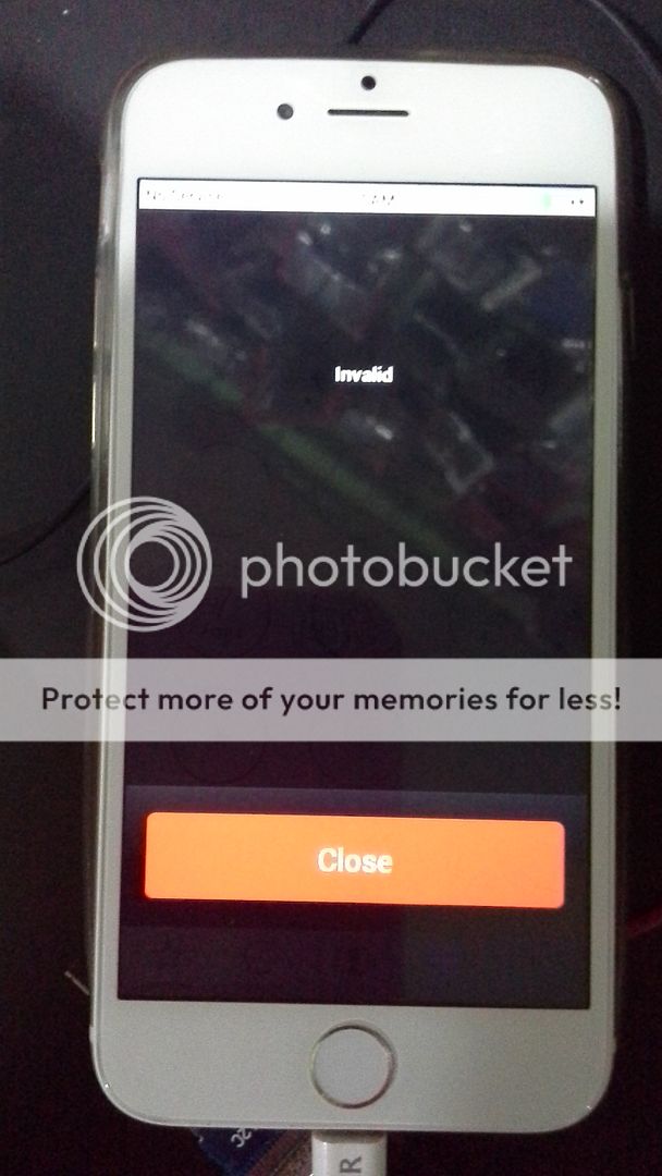

problem: hang in logo and invalid imei

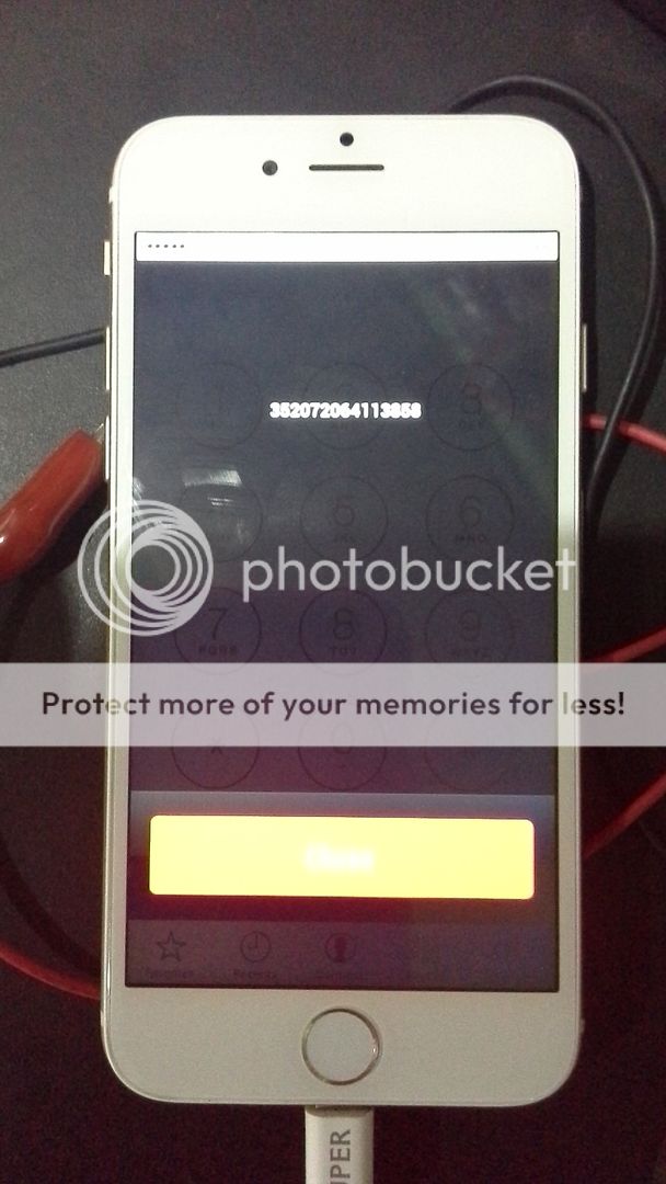

solution : hardreset and rebuild imei using sigma box
phone status hang sa logo ,manual hardreset ko ..hold vol- and power switch tapos lalabas recovery click power switch again at lalabas na selection chinese language select nyo lang yung emmc na word tapos click power switch mafoformat na siya..after reset ito na siya

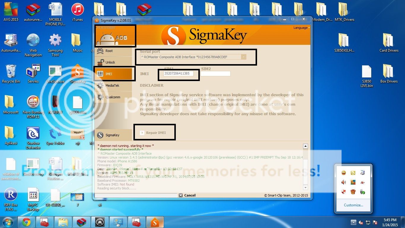

root first using vroot or kingo (vroot ginamit ko)

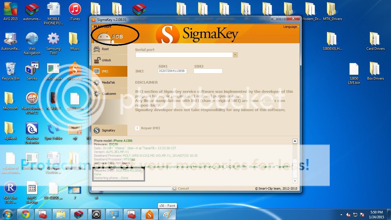

set ko na sa sigma (doble check all setting)
hintayin nyo lang matapos minsan umaabot ng 10 minutes or more

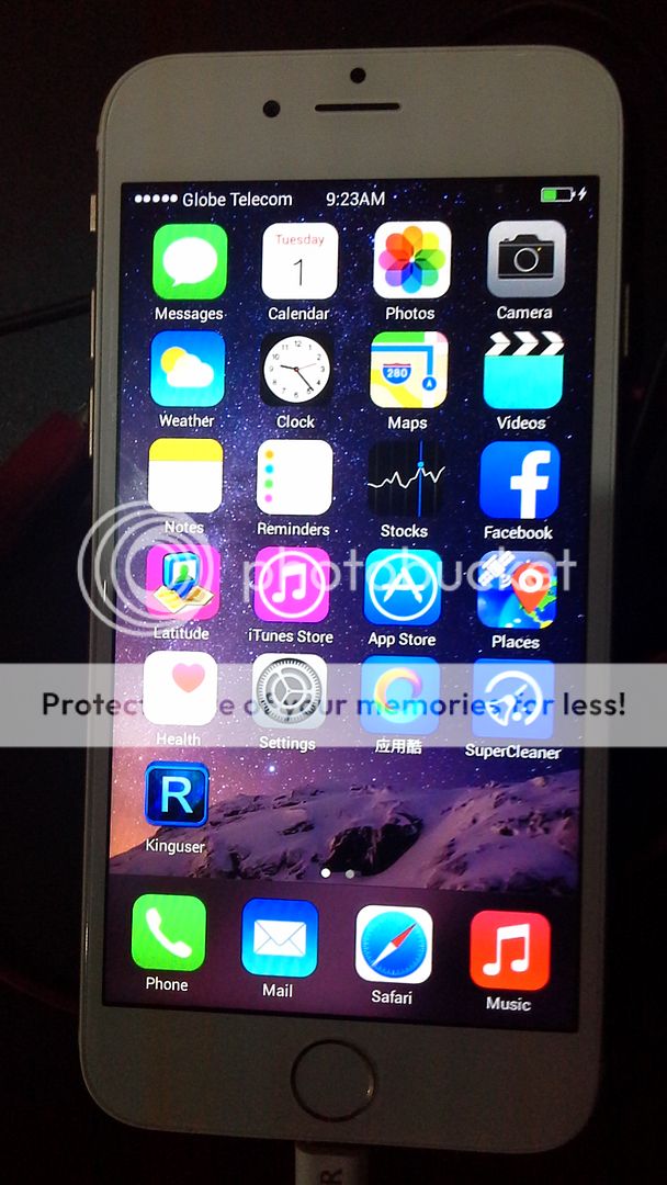

done :
