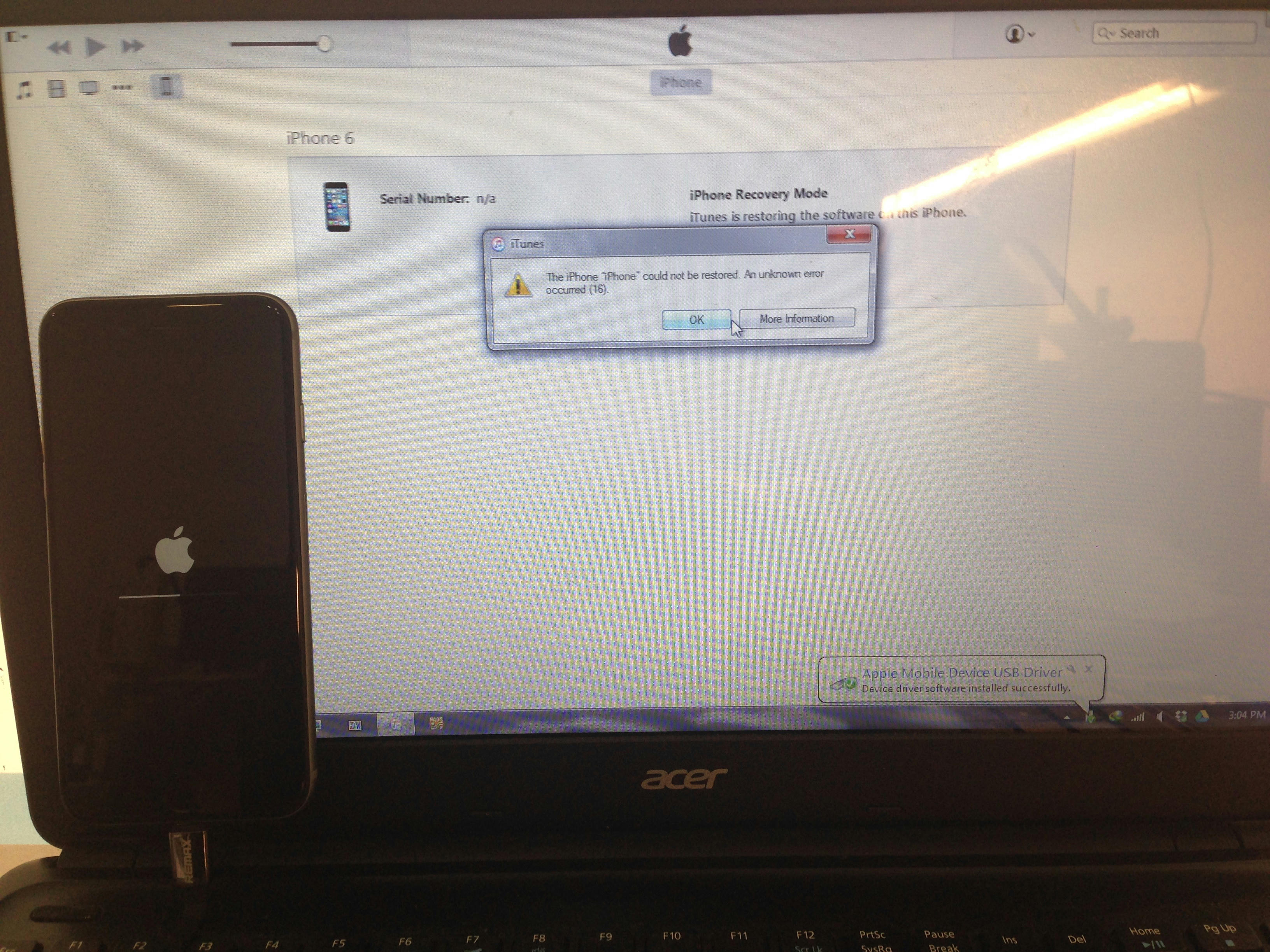

Iphone 6
No Modem Firmware, No IMEI, Network Serching...
During Restore Error 16
Solved
No short, No water damage, No components missing.

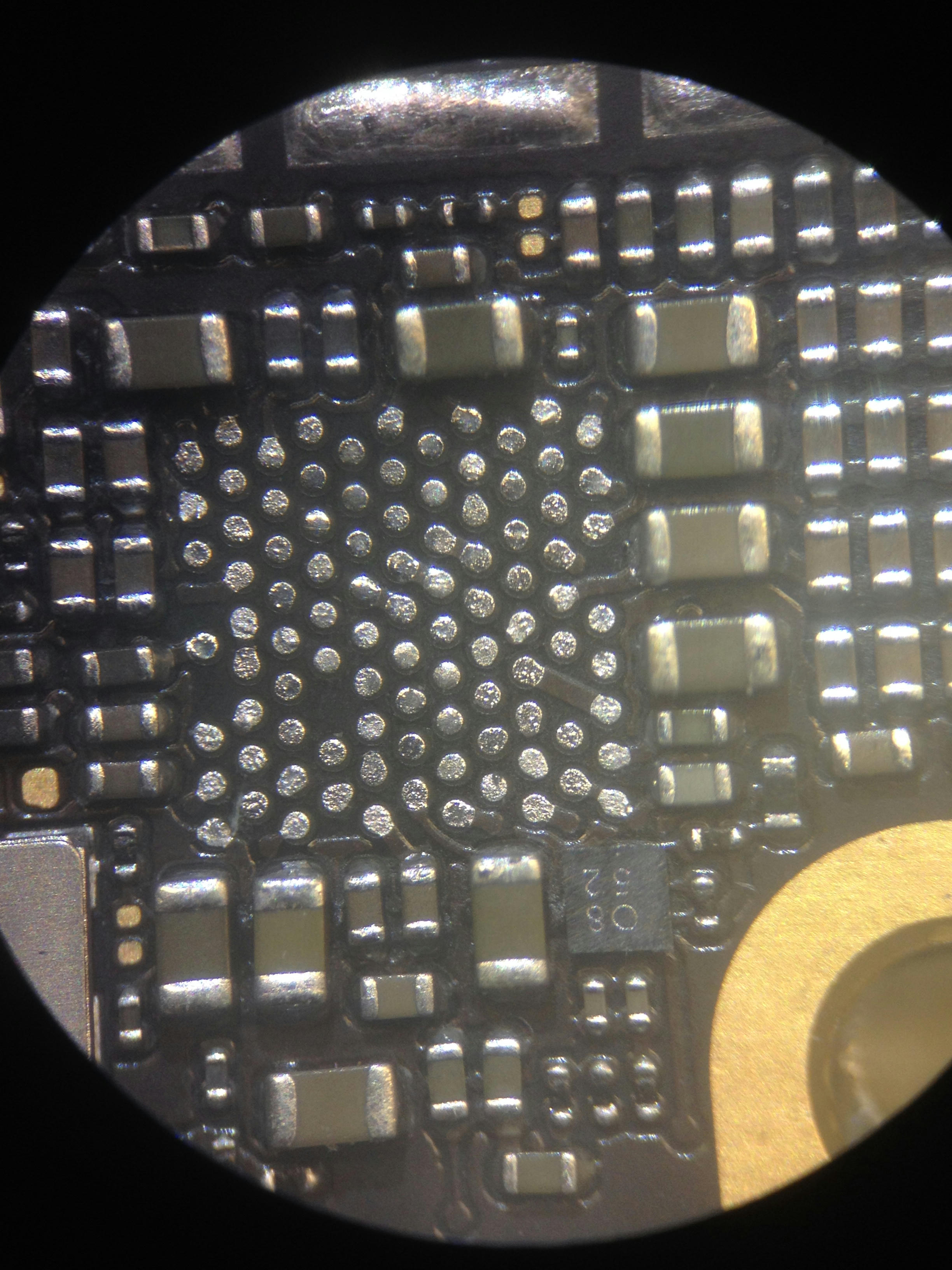

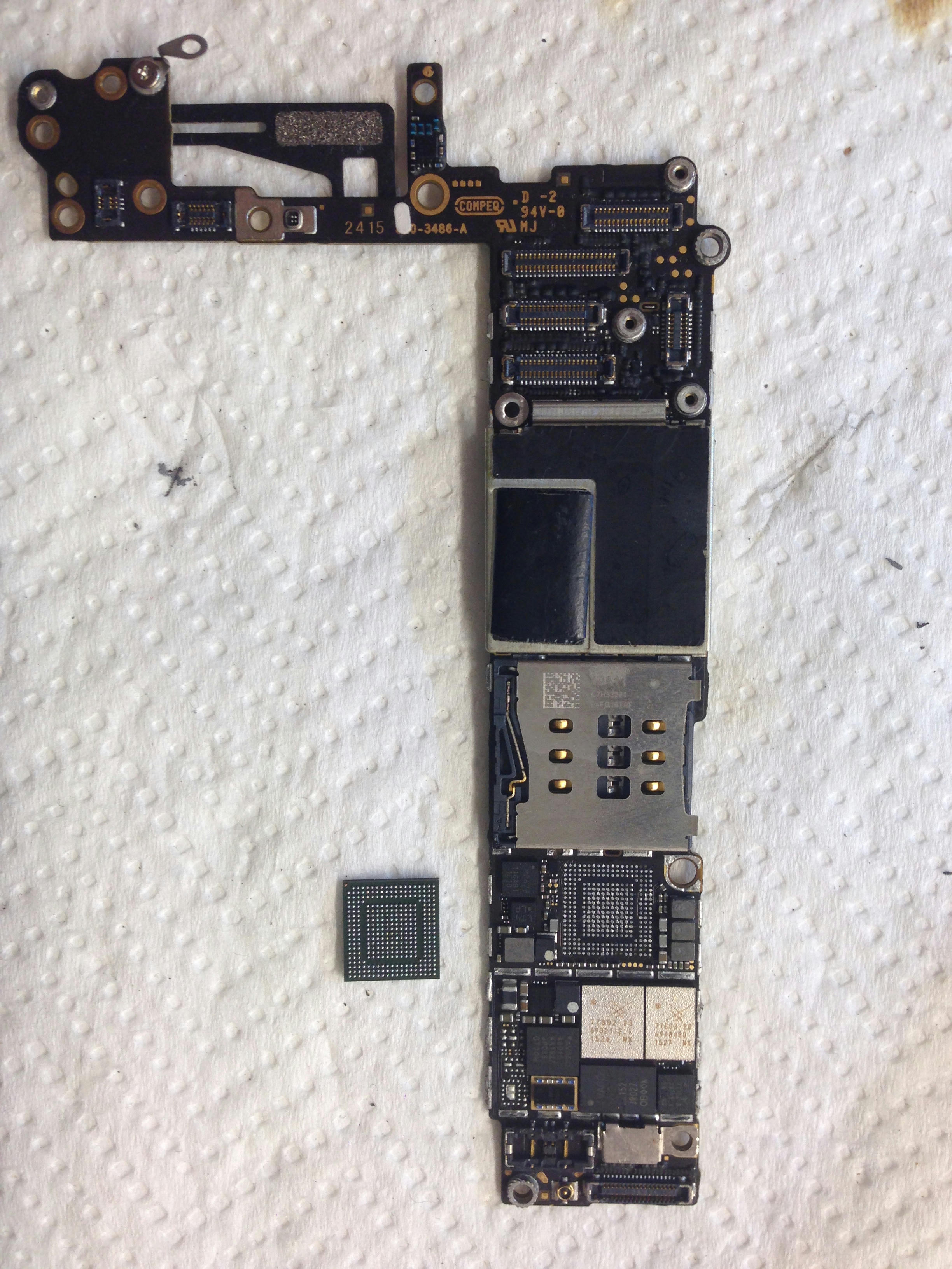

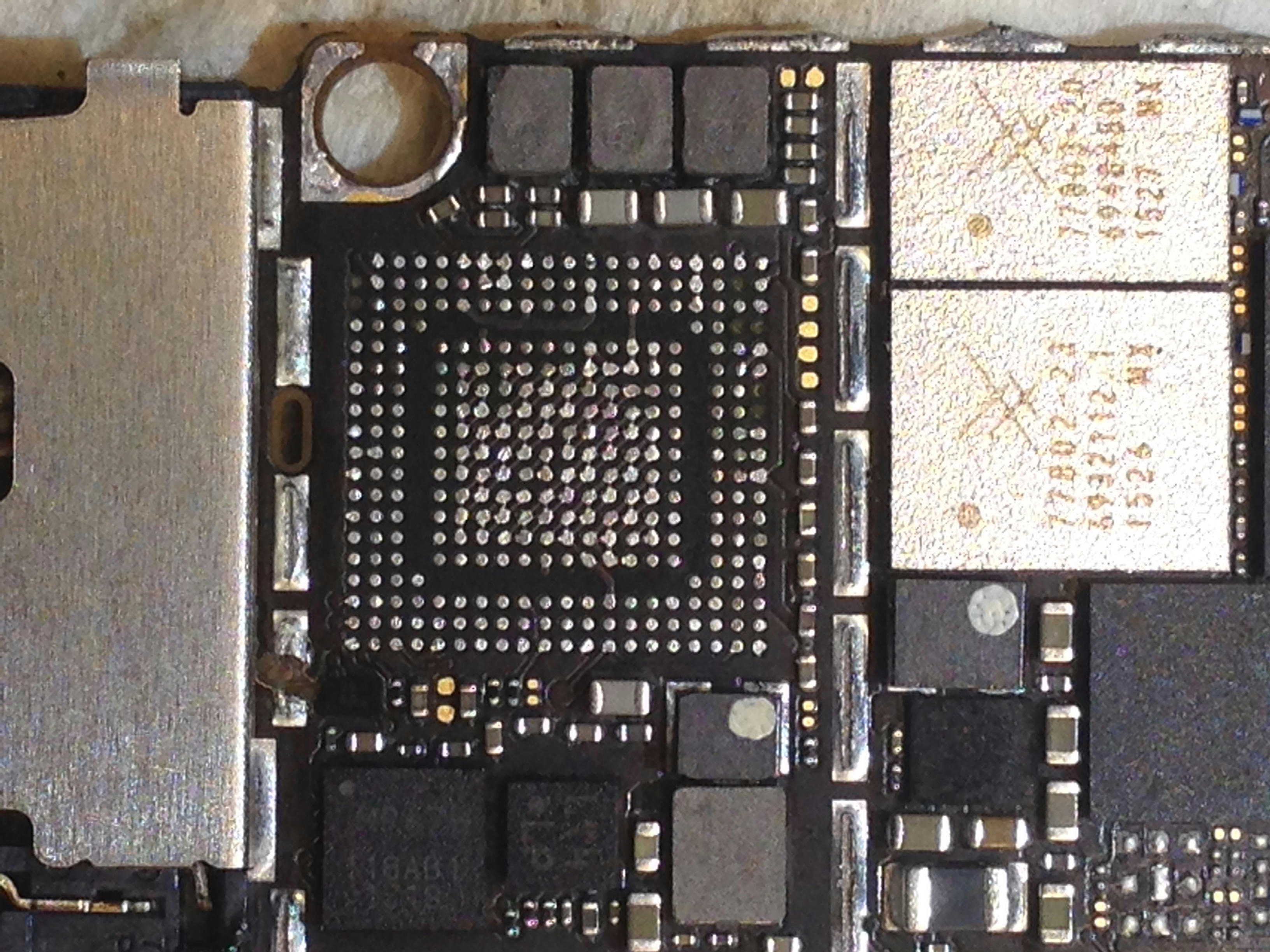

Reballed Baseband Power ic ( PM8019) not solved,

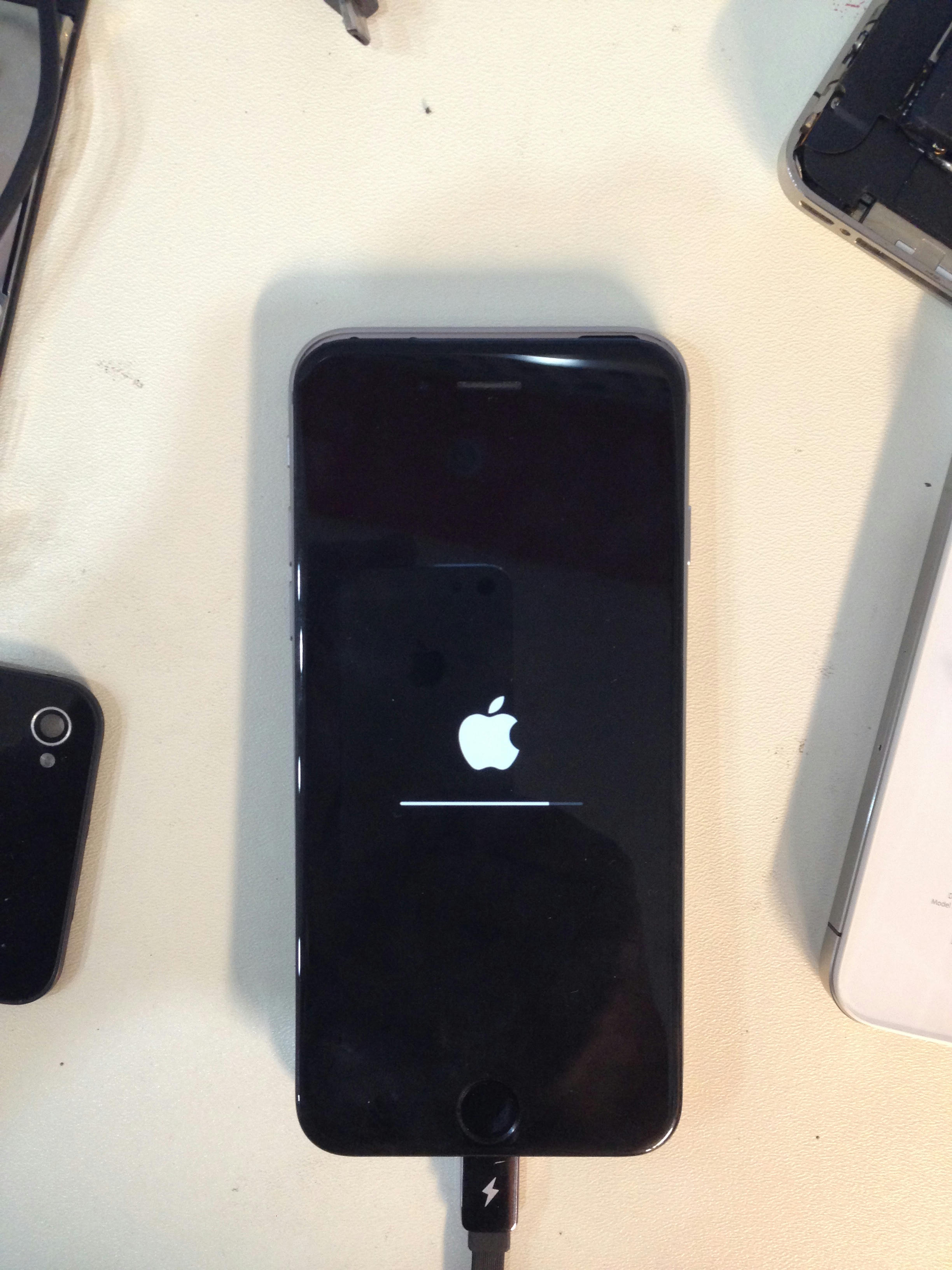

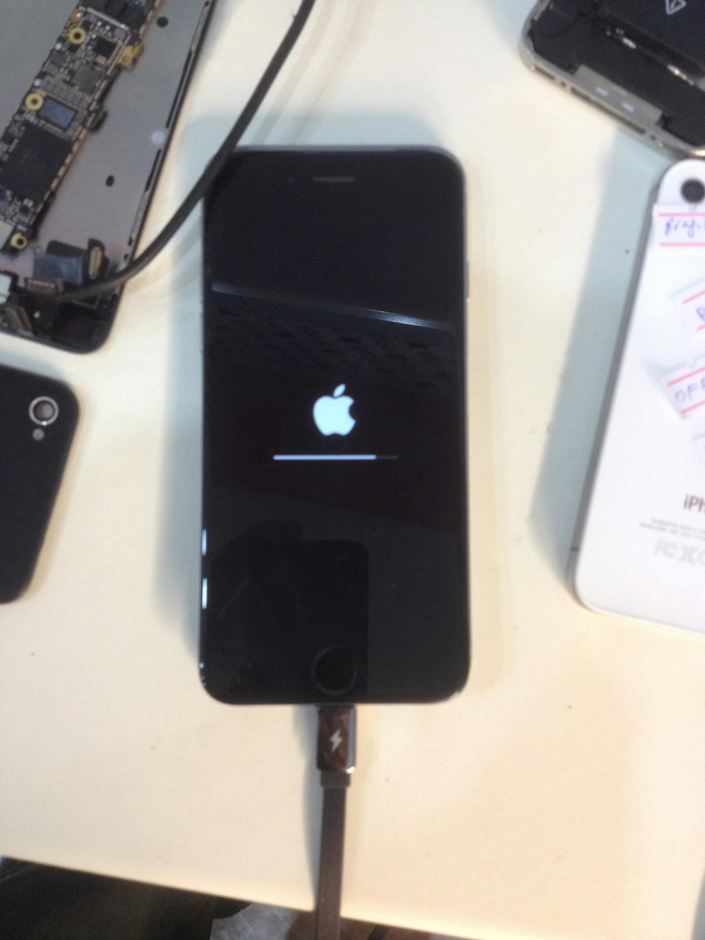

After reball Baseband ic and restore with latest version of IOS problem solved.
