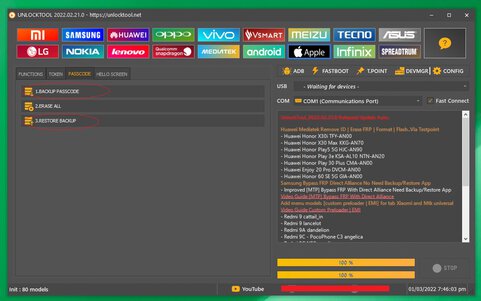

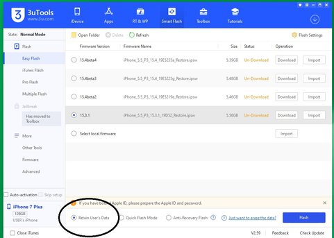

share ko lang iphone 6 passcode ios 8.4.1 bypass with signal
procedure
1. flash mo muna using 3utools dapat naka retain user data sya reference lng yung nasa picture di ko na kasi nakunan yung sa iphone 6
2. after update
3 jailbreak mo sya using ra1nusb for windows with passcode patch
4. backup mo yung passcode sa unlocktool
5. tapos flash mo ulit sya final version 12.5.5
6. jailbreak mo sya ulit using ra1nusb windows with passcode patch
7. balik ka unlock tool tpos restore mo backup
8. pera na!!!!
note if ever may tools kayo na frp aio tool pwede din yta dun kaso mas madali kasi gamitin sakin yung unlock tool 1.jpg2.jpg

boss madaming salamat sa ref mo laking tulong nito naka try ako gnamit ko procedure mo success naman salamat uli
